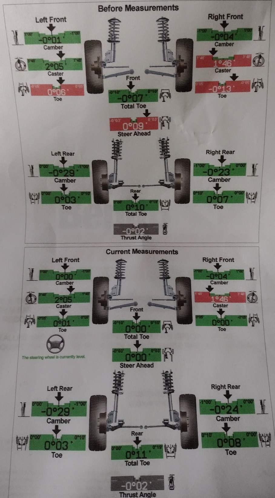

The car shakes like it needs a balance adjustment. If I'm not accelerating, it's not bad at all. And you might not feel it. Once I accelerate, it shakes.
It starts at 40 MPH and continues until about 60 MPH. After that, it smooths out.
I thought that it might be a suspension issue because it also pulled pretty good to the left. They replaced two tires (front ones) the rear tires were only about a year old. They also did the alignment. They said it was pretty far out of wack. I can post the before and after measurements. They were not able to adjust the front passenger side camber because it was not adjustable.
The adjustment took care of the pulling to the left totally.

I had the tires replaced about two weeks ago. I told them that it was pulling to the left and about the odd vibrating. I told them to check everything out underneath. They're a tire/brake/suspension shop that I've been going to forever. I came back and was told that the alignment was way off, that the camber was a bit off, but mine wasn't adjustable, and they felt it wasn't worth the cost of purchasing an adjustable one and that was all they could find.

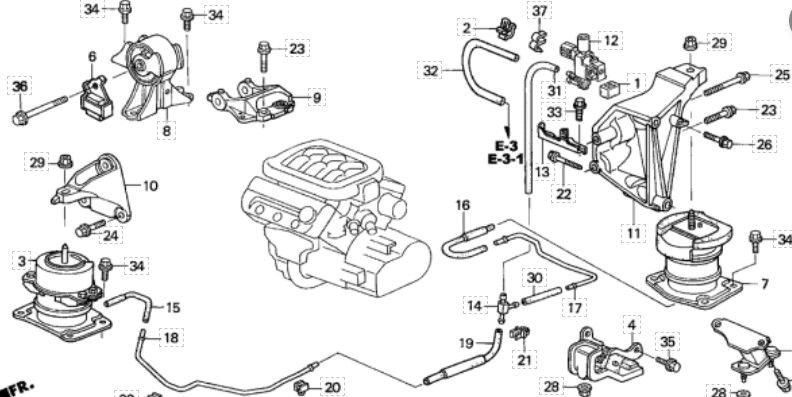

I've been busy and wanted to clean the engine bay before I get started to make this as easy as possible, being that I've never diagnosed an engine or tranny mount in any car and I wanted to make sure I can see everything clearly. But I did take a quick look. I noticed that the front and rear mounts do not have the bracket that sits above the mounts (in the TL's), I assume as insurance in case the mounts completely separate to keep the engine seated. So, I can see the mount from above clearly without that black bracket that usually sits above it. Does the CL not come with these brackets?
As far as the diagnosis process. I've seen/read different ways to do this. The visual inspection looks good. There isn't anything obvious as far as torn rubber. I've seen people put the car in reverse, have someone rev the rpm's to 1500, and I watch for excessive engine movement. Then repeat in drive. Some use the knock method, but their knock comes from the mount moving so far that it bumps into that black bracket above it, which makes a knocking noise. As far as the side mount. I don't know how to torque the engine left or right except by pushing it by hand. Haha. But if the black bracket is not above the motor mount, how far should the engine move before it becomes excessive?
I also failed to mention above that the car, between 40 and 60 mph) shakes, yes, but it also feels like it's hopping. Hopping very quickly. So it doesn't just shake, it feels like it's hopping. That would point to motor mounts, I assume. (Thanks Zeta & Fireball)

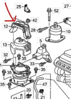

You are thinking of the 3G TL, the 2G CL / TL do not have the engine mount stoppers.
3G TL:
2G CL / TL:
3G TL:
2G CL / TL:
I'm glad we don't either. The newer motor mounts on the next Gen cars annoying. Why did Honda think it was a good idea to put the bolt side ways? That rear motor mount has the bolt right up against the fire wall. Can't see what you're doing, and barely any room to work with. Pain in the ass.
Remove the front driver side wheel and inspect the transmission mounts from there. All you'd have to do is throw a jack with a wood block on it, and slightly jack the transmission up a bit. I'd recommend disconnecting the front & rear motor mounts, but you might be able to get away without doing that. It was hard to tell if my transmission mounts were bad until I pulled my transmission, and saw the front mount was completely disconnected when it was hanging in the air lol.
3G TL:
2G CL / TL:
Yeah, that 3G bracket is exactly what I was expecting to see.
