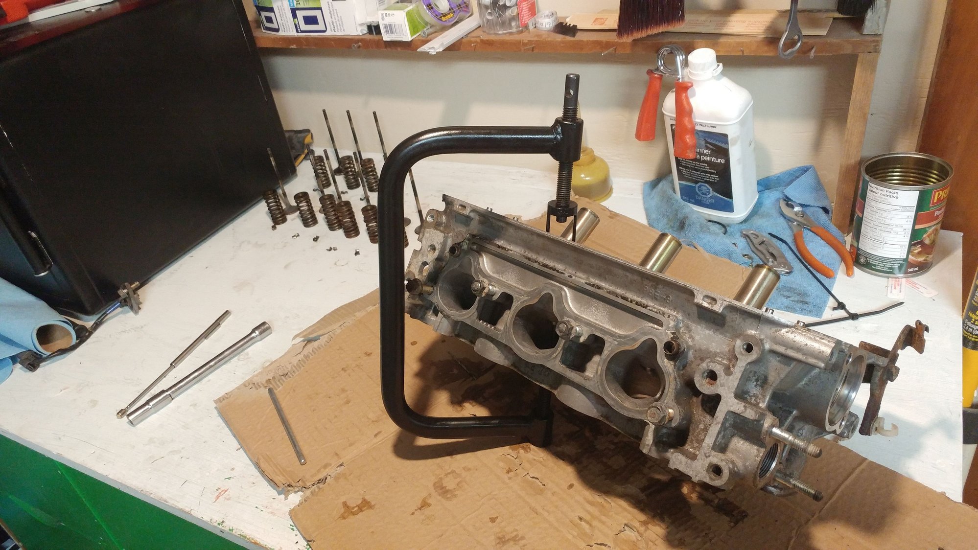

Heads are just getting cleaned painted new valve stem seals and valves lapped with some compound.
​​​​​​ 25$ valve spring tool from amazon works great

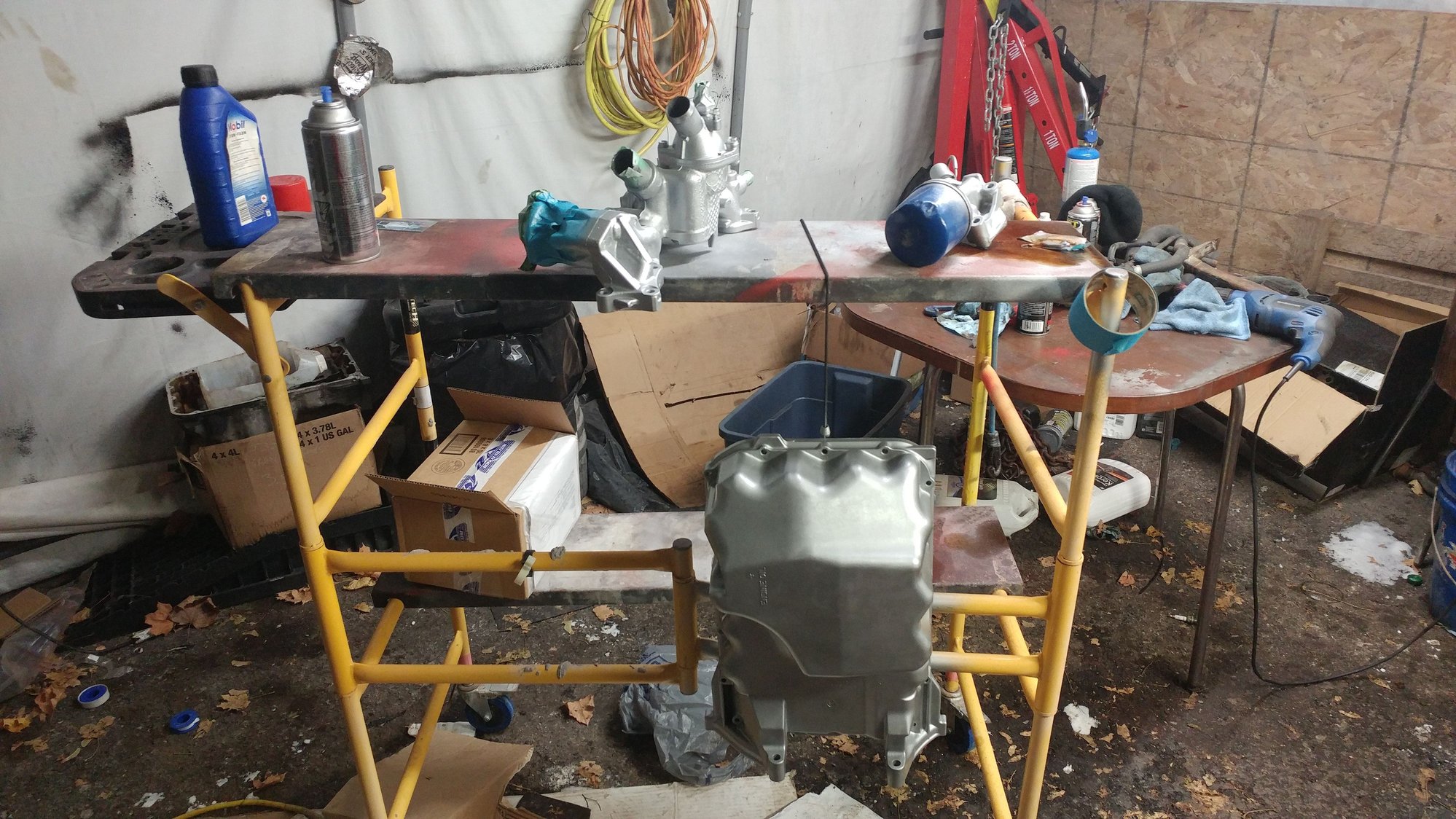

Bit of paint. Winter here beats up everything its a big job just cleaning all the parts and bolts lol.
Heads ready time to get moving on the block.
