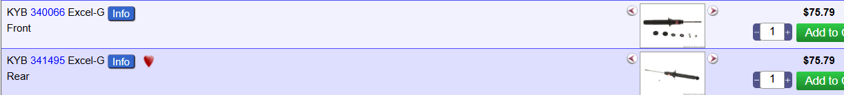

I am looking for a kyb quick strut/spring assembly. In reality I am looking for a OEM equivalent assembly but I can’t find one. I bought the KYB exel G struts but need the springs too so I am just gonna get it all at once instead of build it and risk my life.

So, just to clarify, you purchased the struts below and now you need all other supporting components to make complete front & rear assemblies?

No. I purchased these struts 340066 (only then front for now)but don’t have the means to build them as in I need to add the springs to make a complete assembly. I bought all the other parts like the boot, etc. So what I am looking for is a complete strut with spring that is for OEM spec (comfort) and not a coilover that will kill my kidneys. Seems like KYB used to sell it but I can’t find it now.
