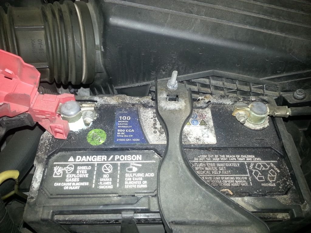

Temp isn't bad, only 71. Attached is a picture of the battery. It's my 2nd one so far, but I believe it's stock.

I would go ahead and clean those terminals, Get a battery terminal brush and go to town on it

Thanks! Scrubbed the hell out of the terminals.That seemed to help, though humidity is lowering here so that could help as well. Though now I'm getting a 'CODE' error on the stereo lol. Time to get the VIN and see if this site works. https://radio-navicode.acura.com/

Also check the negative wire from the battery going to the car body my screw was all rusted not making good contact. The car was hit or miss trying to get it started I replaced the rusty screw cleaned this area havn't had a problem since.

The OEM battery isn't the greatest and it might be giving you an heads up about its condition. My OEM battery in my TSX and RDX failed without warning within 3-4 year of being new. So far, I am at 4 1/2 yrs on my OEM battery on my MDX. It wouldn't hurt to take the battery down to have it tested at Costco, interstate battery, etc... Both of those places sell batteries for about $100 that will last the advertised warranty period. I've had zero issues with my interstate battery replacement in my TSX or RDX. I would even pop the two covers to check the cells to make sure the internal fluids is above the plates.
It could just be corrosion sucking up moisture on the terminals during high humidity limiting the cranking amps during start-up. Wouldn't hurt to check the battery power levels and the entire electrical system just incase. Call ahead, some places might do it for free.
