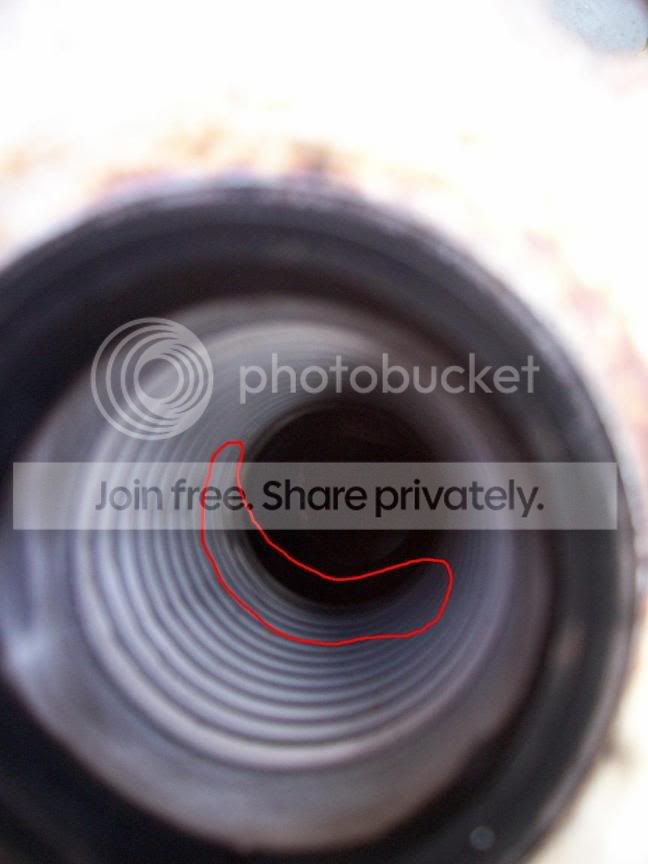

Pic of the crack. It was pretty deep down the apipe, so it was hard to get a good pic. The red area circled shows where the crack is. I'm going to ship this back to DC for a repair. I should be getting the new production version back as a replacement. I'll be selling the replacement in the black market section later. If you're interested, you can PM me and call dibs though

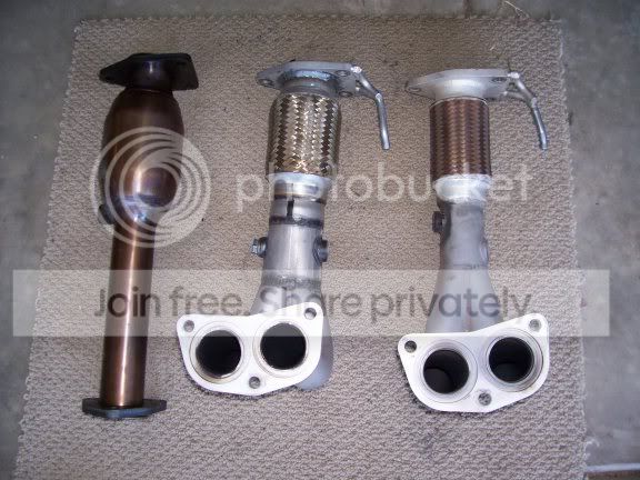

Side by side comparision pics

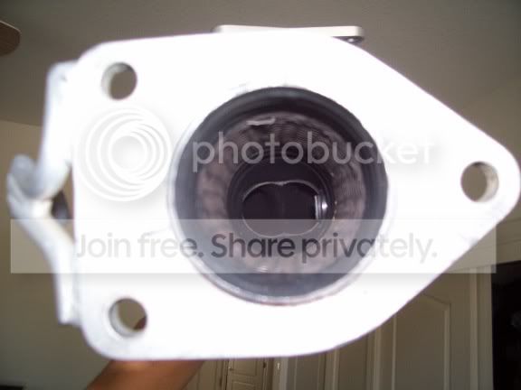

Inside of the new larger diameter a-pipe

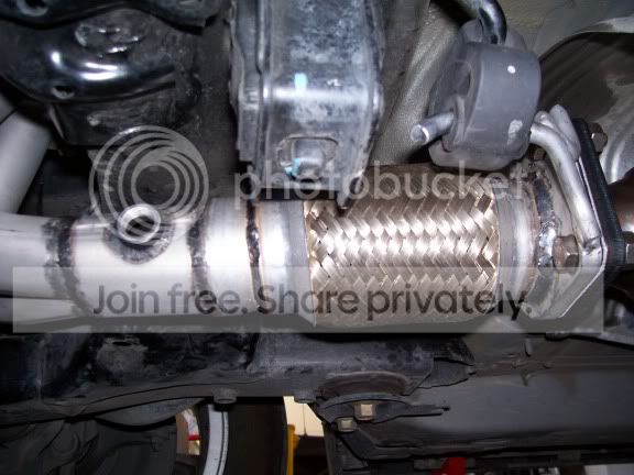

New A pipe installed, (before I put in my O2 sensors)
