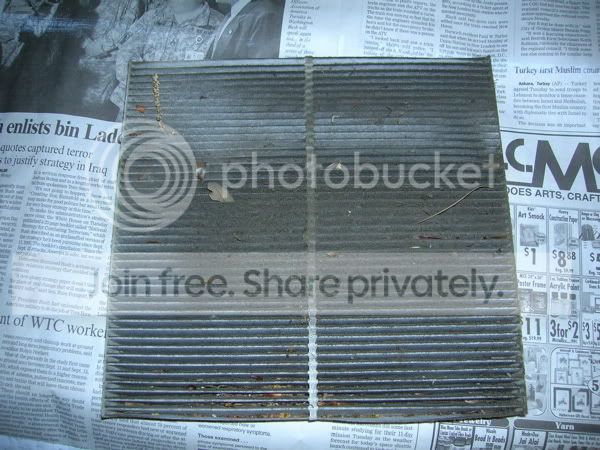

Hey, I know the OP solved his problem, but in the interest of accuracy let me give you some advice for next time.
In this picture,
If you put your finger on the OUTSIDE of the glovebox, just below the bottom of that red circle, and push IN towards the center of the glovebox, there is a hole and you can push those stopper tabs right in without having to pry it from the other side with a screwdriver. PUSHED, rather than pried, they pop right out.
I just changed mine at 52k miles, and the only time it might've been changed before was at the 15k mile service...if it wasn't changed then, it's never been changed

Originally Posted by HondaGuy347
dayyuum that's beyond nasty ! how did you even breathe ! ?

^^ whats nastier is thinking of the air I breathe when not enjoying the filtered environs of my TSX.
