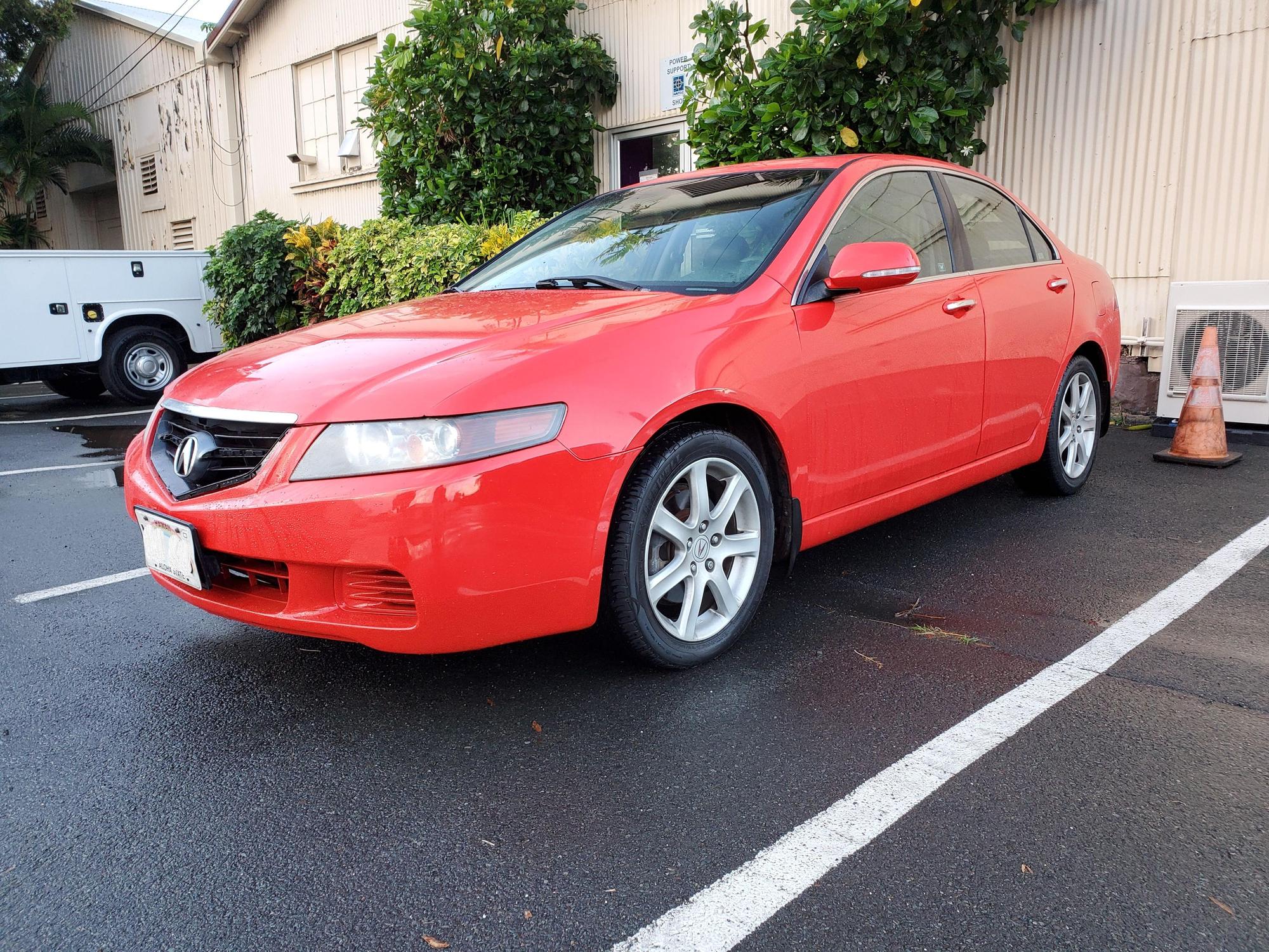

Well, here is my new TSX. I haven't owned a red car until now but have always wanted one.

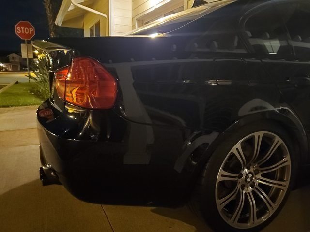

And here is the M3 I don't have many pictures of it yet because I'm not happy with the paint condition. Needs a full correction, then ceramic coat. It's Jerez Black. Shows black at night, midnight blue during the day, and under light has a purple hue as seen.

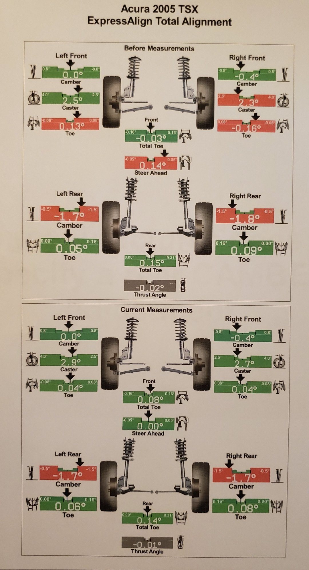

I do however have a different problem. Somehow I failed to notice that the car pulls left. Common sense said get an alignment. So, I did.
But it did nothing whatsoever. It still pulls left just as bad. Low or high speed, doesn't matter. One possible discussed cause is the tires, which are some real cheap-o's. I'm going to rotate the fronts with rears and see what happens. I also most likely have a balancing issue, deduced from a bit of shakiness at highway speeds, so that should become more or less apparent with this test.

Bit of an update. The junk tires and need for a balance gave me an excuse to pick up some General G-Max RS's. I went with 225's for a hair bit additional width. Got them on today and the left pulling has fully ceased along with shaking at highway speeds. In addition they gave the car much more steering confidence. I noticed the difference immediately. I'll chalk that up as a win.

I'd love nothing more, but it's been rattle canned or something similar. The clear coat is non-existent in some spots, especially the roof. Real shame for such a nice color. I'm prioritizing the mechanics over aesthetics, but if there's any cheap workarounds to improve the paint I'm not oppossed..

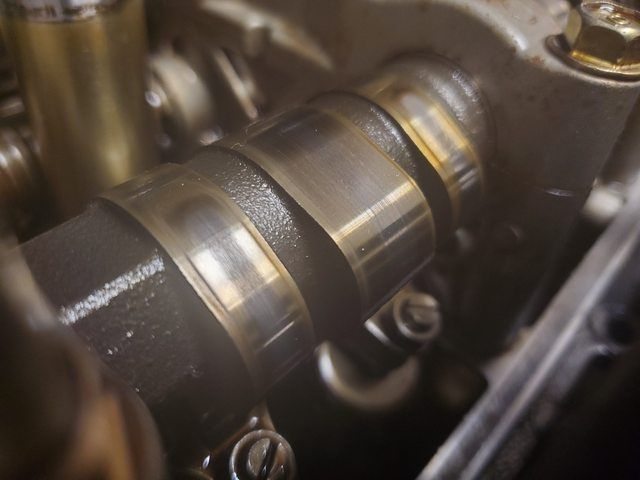

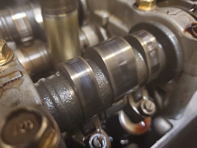

Got under the hood for some maintenance this evening. Replaced the valve cover and other small associated gaskets. Lobes don't look too bad. I did notice some corrosion inside the spark plug wells, but nothing to be alarmed about. I wasn't able to pull the plugs because my current socket fits BMW All mating surfaces and small deposits under the valve cover and inside the head area cleaned up with a microfiber towel. Sealed up with RTV for reassurance. Hardest part was getting the damn cover off and on, with removing the pressed spark plug well gaskets not far behind.

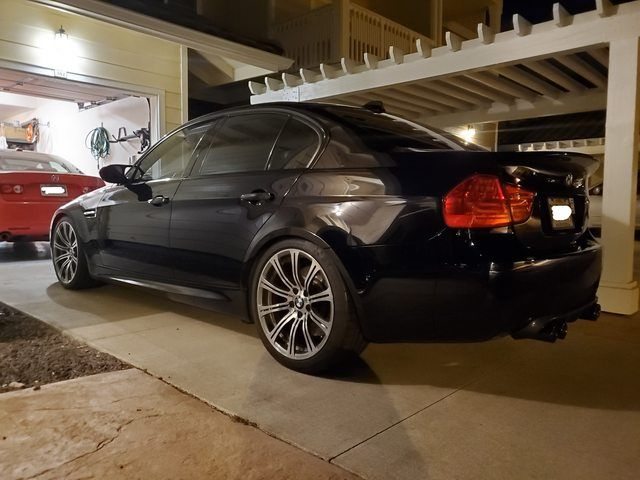

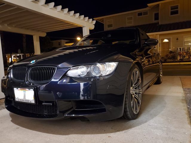

Oh, and per request, got a few quick pictures of the M3. Please excuse my dumb reflection on the car. Mods at this point are H&R springs and a carbon fiber challenge style trunk. I just removed the Advan RS wheels with intent to put something else on. I've changed the transmission and differential fluids and have brake fluid on the shelf waiting for a flush. Center console is currently out and being refurbished. The plastic hasn't held up so well over the years and the texture has become sticky. I also have alcantara shift and brake books with M color stitching going in when complete. Valve covers and gaskets are next, which need to be cleaned and powder coated. Got a short shift kit with 20% throw reduction from Autosolutions on the way, pretty excited to try that out. Full paint correction and ceramic coat will probably be done early next year. I'll eventually have an alcantara steering wheel and carbon fiber steering column, which I have half of at the moment. After all of that I'll start on engine performance, basically a full exhaust and tune. Lots to do!

Nice m3 btw!
