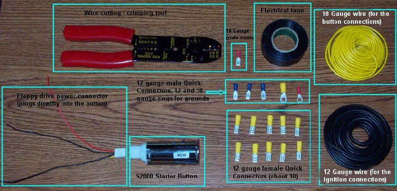

ENGINE START S2000 BUTTON DIY
Parts I used:
  • 1 Genuine Honda S2000 starter button. Part number 35881-S2A-911 (can be ordered from HandA-Accessories.com for $33.14 + s/h)
  • 1 SPDT (Single Pole Double Throw) Relay 30 Amps/12 Volts (you can buy this at any auto store or alarm/radio install shop. Make sure it is a SPDT 30Amp/12V relay)
  • A floppy drive power connector (will explain below why you need this. You can either yank it out of your old PC or buy it for pennies at any PC shop)
  • A crimping and wire cutter tool
  • Some 12 and 18 gauge wire
  • Some male/female Quick Connectors
  • Two ring connectors (for ground connections)
  • Electrical tape
Well if you follow pictures correctly i think you can do it without the steps..
sorry im just kinda lazy to rip it out of what i did..if you need help just ask
as for the button where to put it ..you can put it anywhere.
you can follow his steps here and use my diagram to set it up
http://yefim.com/vx/redbutton/
