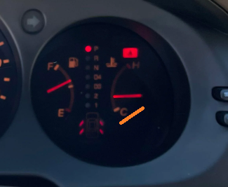

I just did a test drive on a hot day for 30 mins last weekend and I noticed a similar thing.
On a 2001. It stayed similar to this photo I found on reddit, horizontal rather than centered between C and H. Maybe slightly closer to H than this photo but not much.

One thing I'm curious about is my needle is significantly below the C when the car is off, similar to this
For those where the needle is higher than horizontal, more directly between C and H at normal operating temperature I'm curious where the needle's off position is. It may just be a calibration issue.
