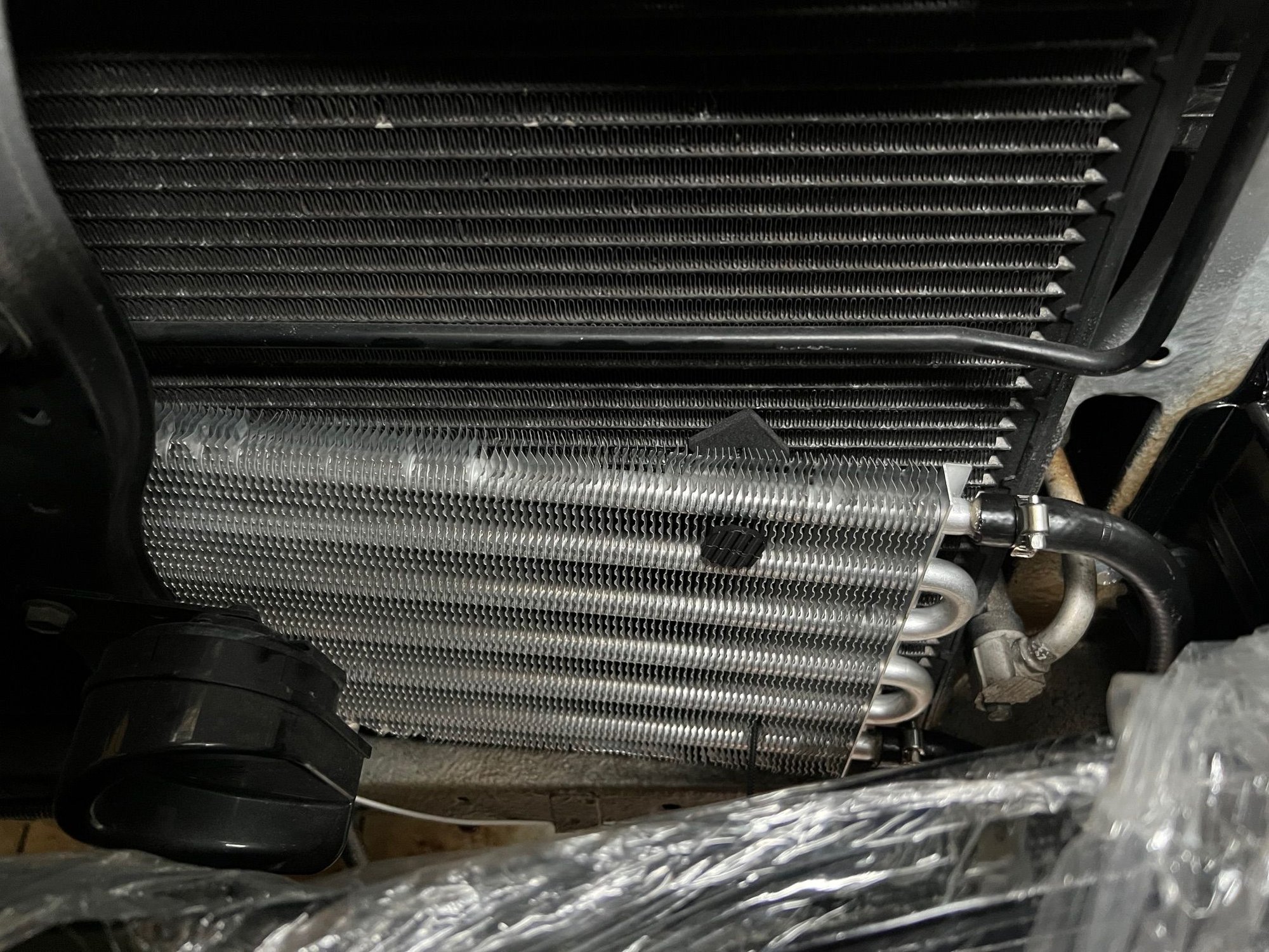

I would like to install aftermarket kit and connect into return hose from radiator to AT. So the question is which atf hose is returning from radiator?

If your place is to bypass the radiator altogether, why not just plug the lines and connect it in-line? why bother going through the radiator AND the ATF cooler?

i think the best option is instaling cooler after radiator. I have Accord V6 and atv cooler is installed like that. I use my Acura in European Highways driving fast so i would like to avaif problems with gearbox.

My guess would be hose # 15 for the return from rad, right next to bottom rad hose connection to water pump inlet.

you're right, hose 15 is return for atf from radiator.
ATF cooler is installed.

How's the AT temps with the new cooler? Did you notice a substantial drop between stock and the new aftermarket cooler?

my Acura is in parts now because i'm doing renovation so i can't test it. but I think i wont measure temp because it required new gauge.
