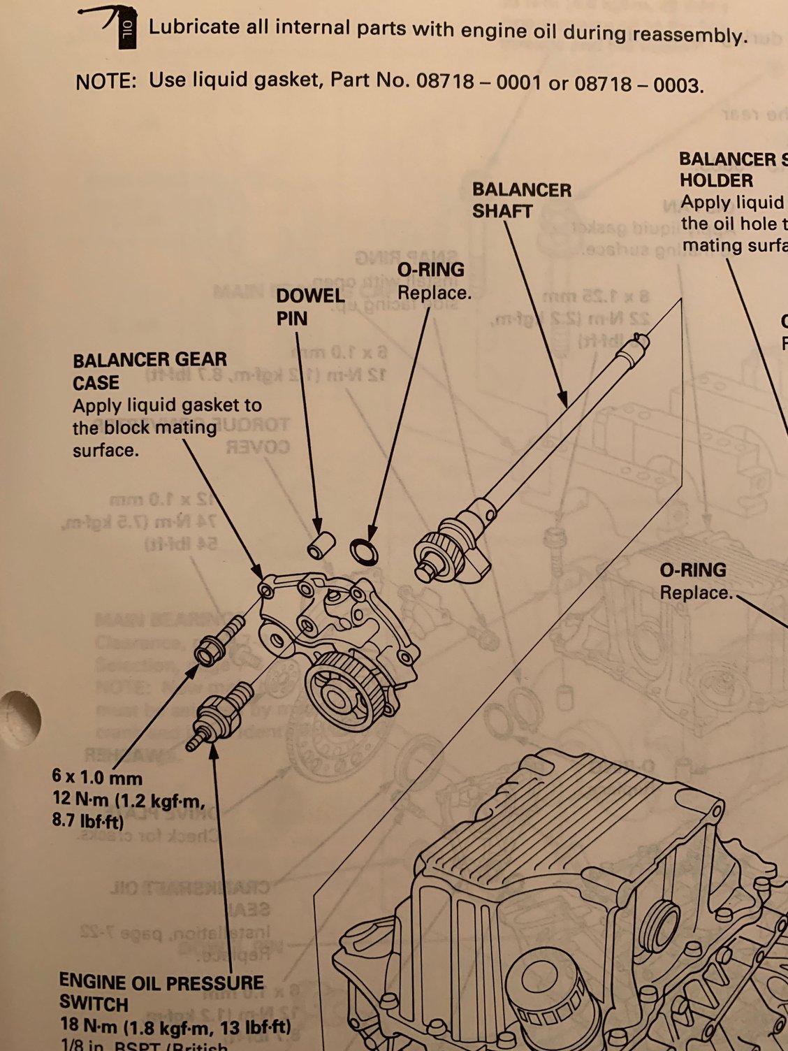

Since you did this I have one last question: How did you align the balancer shaft? The manual shows a "a maintenance hole" (see diagram) that supposedly can be used for alignment. However, when I changed my timing belt, I was not able to find this hole. Seems like it is really hidden and inaccessible unless you are a cockroach or have robotic surgery equipment. I could not even see it, much less access it. I wanted to do the alignment as described in the manual but unable to find this maintenance hole I just took out the old balancer belt and installed the new one being careful not to rotate the balancer pulley. All worked out well but still I'm curious where that balancer maintenance hole is. Did you find it?

Iam happy if I can help. But honestly my 96 don't habe this hole. All I did was to expose the balance shaft and move it on the correct marks. Like on the Foto i try to Upload Here. :-D

Oh thanks. I now wonder if that hole exists at all because I could not find it either, even though it is in my ‘96-01 RL manual. When I did my timing and balancer belt replacements I was afraid that it was not sufficient to line up the balancer pulley marks. If you look at this page from the manual (see photo below) you see how it seems like there are some gears behind the balancer pulley. It is possible that the pulley is connected to the balancer shaft through some sort of gearing ratio (eg 2:1, like the crankshaft and camshafts only line up every two crankshaft turns). In that case, it is not sufficient to line up the external balancer pulley marks, you would have to use this “maintenance hole” for proper balancer shaft alignment.
In any case, the balancer shaft alignment worked for both you and me, but it is perhaps something to keep in mind for the future. One problem is that you have to take off so much stuff to get to the timing belt on these engines that it is not possible to start the engine with the timing belt covers off to see how the balancer behaves and try a different alignment if there are issues.
Good to know that misaligning the balancer shaft causes vibration only at idle, and that this vibration is not affected much by vacuum or no vacuum at the engine mounts. I did not expect that, so thanks for finding out.
I guess not many engines have a balancer belt, (today’s Honda J engines do not) and the balancer belt marks are small, so I can see how an inexperienced shop may just replace the balancer belt and forget to line them up. When you take the balancer belt off that pulley, the pulley spins freely with no resistance. If you don’t have anything holding the balancer pulley in place it will for sure move by the time you have finished installing the timing belt.
