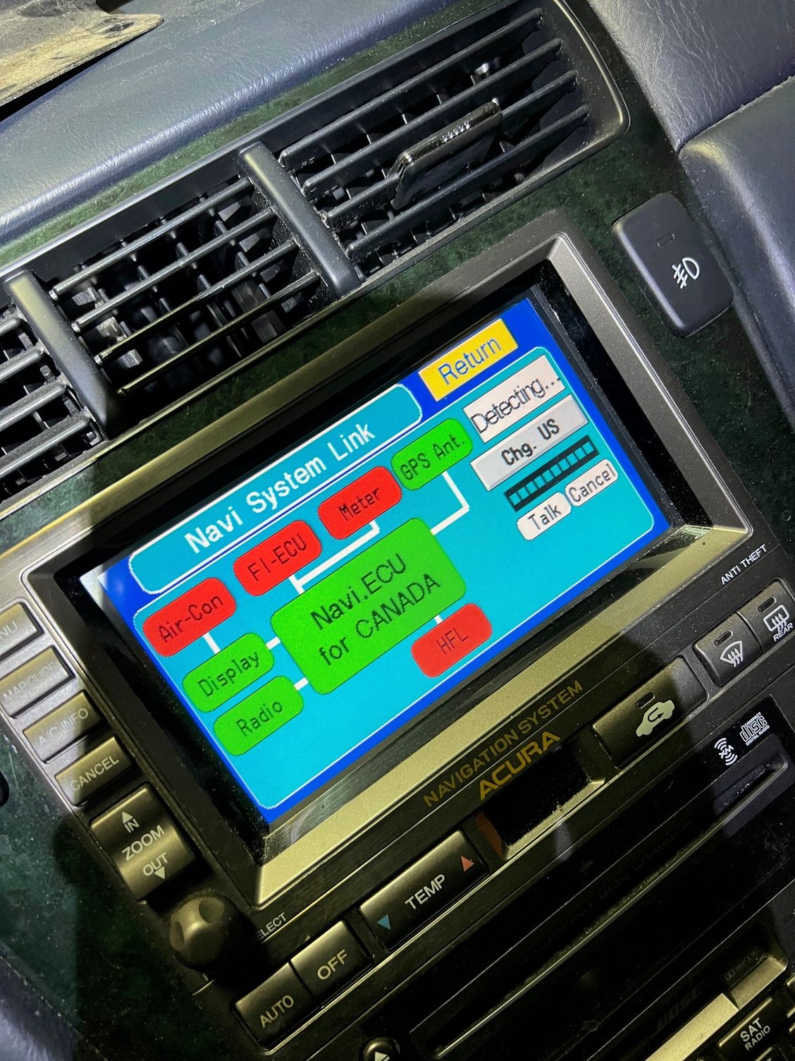

do you know there is possibility to start some service menu? If there is "code" screen you should press menu+zoom out. From "service menu" you can go to AC man steering after pushing AC/INFO

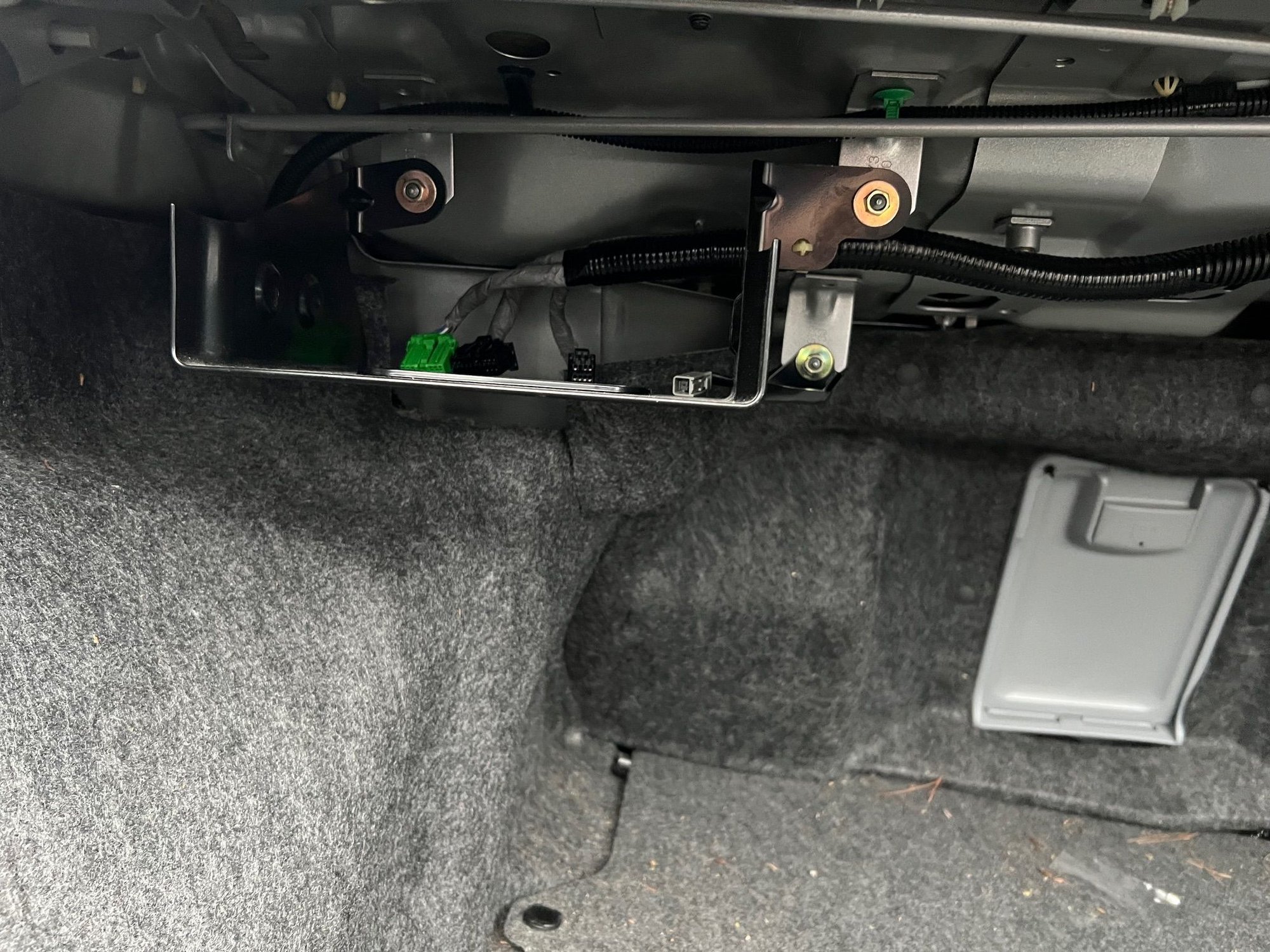

there is a success. I have acces to diagnostic screen, you have to jump wire to service conector in the trunk. I have serial number so it's possible to generate PIN ufff.
