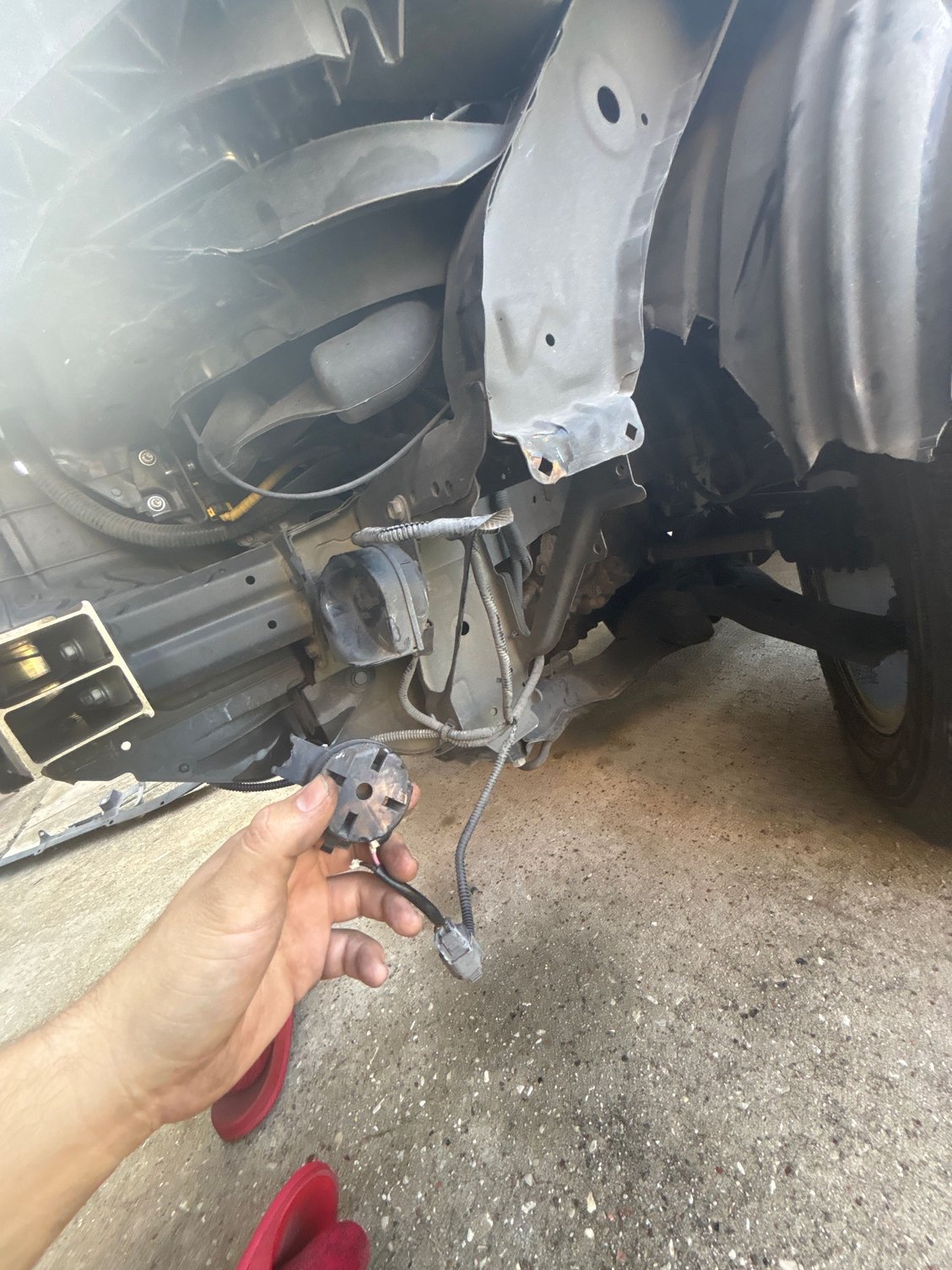

Got an issue on the way back home from xmas trip starting hearing a clunking on Driver side tire. Pulled over to check and found this part hanging from the bottom I guess hitting the car floor and I couldn't seem to identify where it came from so I just unplugged and kept it moving being that we are a ways from home. 😅 The car hasn't presented any issues while driving but we still have 5+ hrs to go and want to confirm it's nothing too bad if we keep driving it. Any Help would greatly be Appreciated

I could not find anything definitive on google image search?
When you get home, you may have to get under the car and plug it back in again to narrow down where it lives, somewhat.
The red arrow points at an area the may be the remnant of a bolt mounting point that is broken???

Trust Ive been On Google since it has happened 😂 issue is when it broke from where it is placed the wires were pulled so the positive side has ripped from the where it goes into the part so I tried plugging it back in to see/feel a difference no luck 😓 Thank you! I will indeed have to put it on a lift when I get home and try to find the random mounting bolt haha

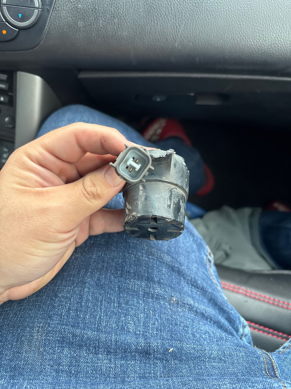

What is the part that your hand is touching? According to google that plug is a perfect match to a honda foglight plug. Does the other side look like it could be a cracked foglight?
Also the plug matches a Honda transmission solenoid in another picture, but the actual device looks nothing like the matching solenoid.

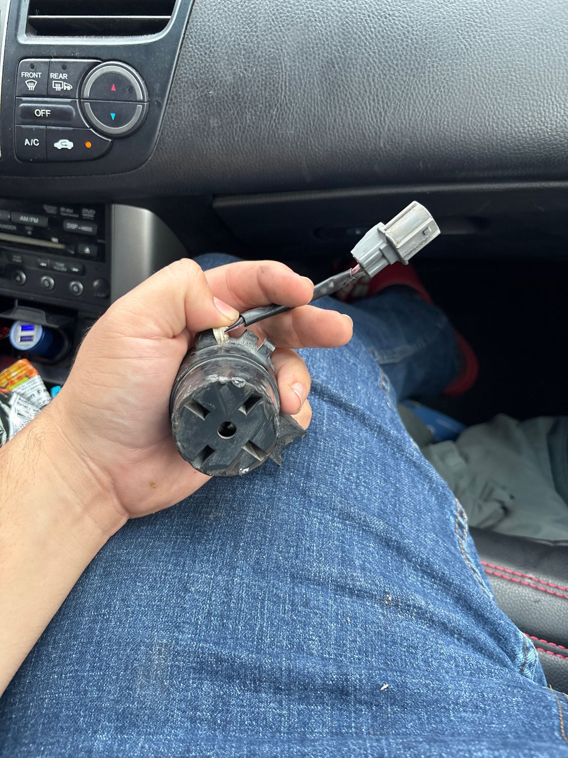

Also, looks like a torn apart pump, could be the insides of this $400+ part....
46460-STK-A01
And the plug seems to be a match.
https://extreme-auto-parts.com/acura...-46460-stk-a01

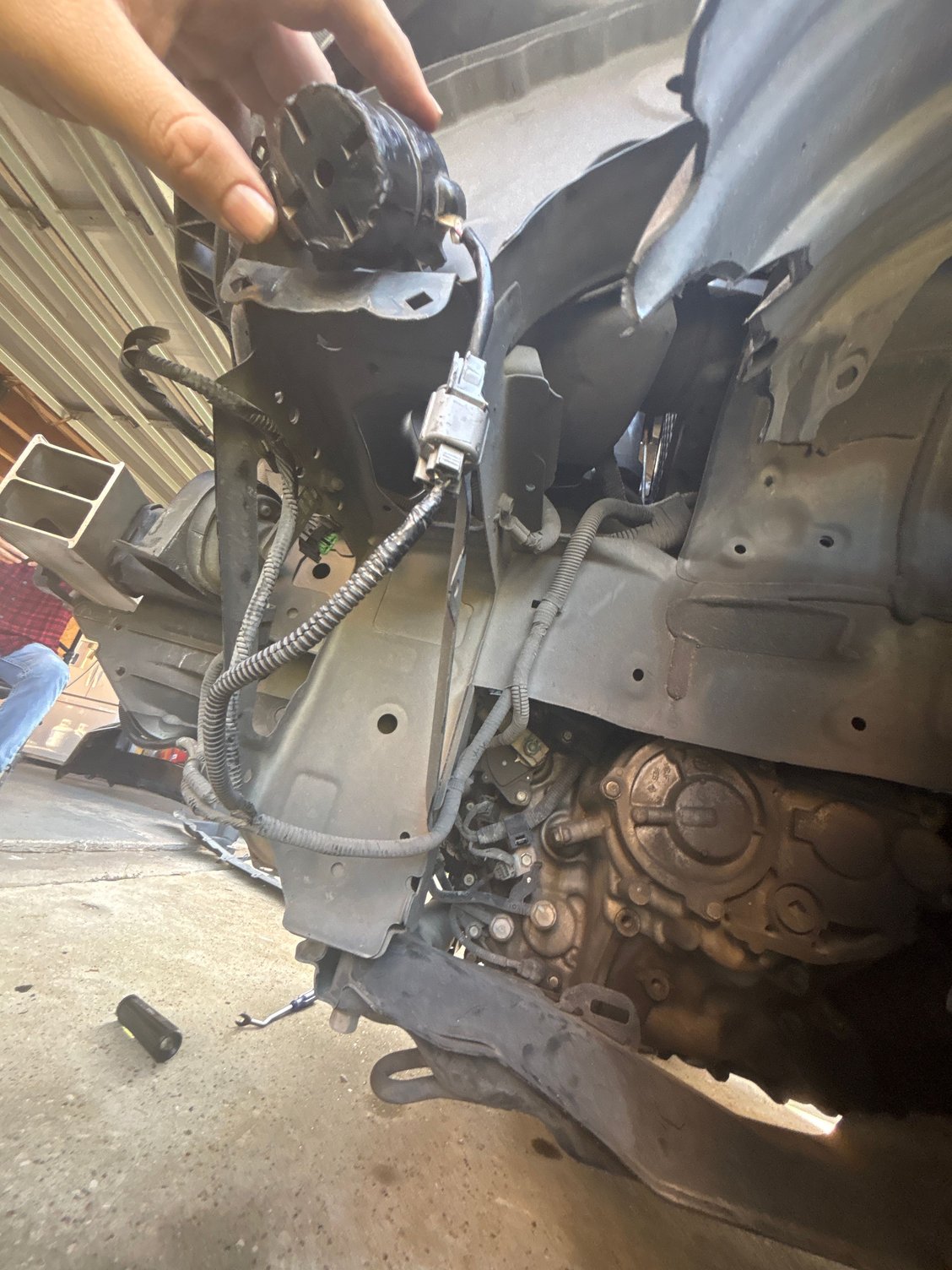

I have taken apart my bumper but still can't locate a bolt with a broken mount . Luckily we made it home still no issues presented only that the car no longer beeps when locked to confirm car alarm is set. Im searching my local pick-a-part locations in hopes they have one so I can follow the wire harness to see where it goes. I will update soon I appreciate the advice!
The purple arrow may show its general location??

You are a life saver! I couldn't come up with the name for the life of me 🤦🏻‍♂️ Looking for part to purchase now thank you so much!
