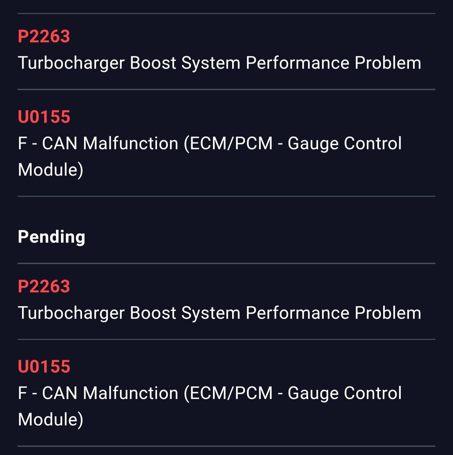

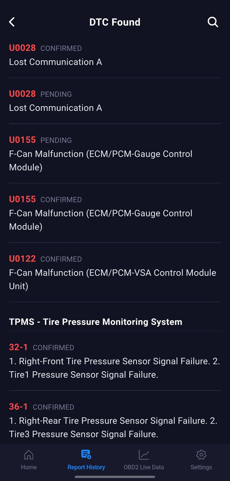

How to fix these multiple errors showed on my ODBII reader?
I have shown my car to multiple dealers and acura services center but no one is able to properly diagnose it and is able to fix it they say i would have to replace the turbo but then why there are stearing angle errors

What I'm thinking is that you have four underlying problems causing all these codes:
1. TPMS issues with the right front & rear tires - frustrating but not necessarily a drivability issue.
2. The dreaded P2263, likely caused by a worn eyebolt on the turbo actuator. Shops will tell you that you need a new turbo (technically that's what the service manual says), but there's a well-documented fix shared by other members on this forum - just search for the code with the 1G RDX subforum selected.
3. A whole bunch of ABS codes that may or may not all stem from the same failure. I can imagine e.g. a bad ABS pump causing all those codes, since it's also the "brains" for both traction control (VSA & SHAWD) systems.
4. The U0155 code pointing to an issue with the cluster gauge. Does it seem to be working properly?
P2263 and the ABS codes are more urgent to resolve IMO.

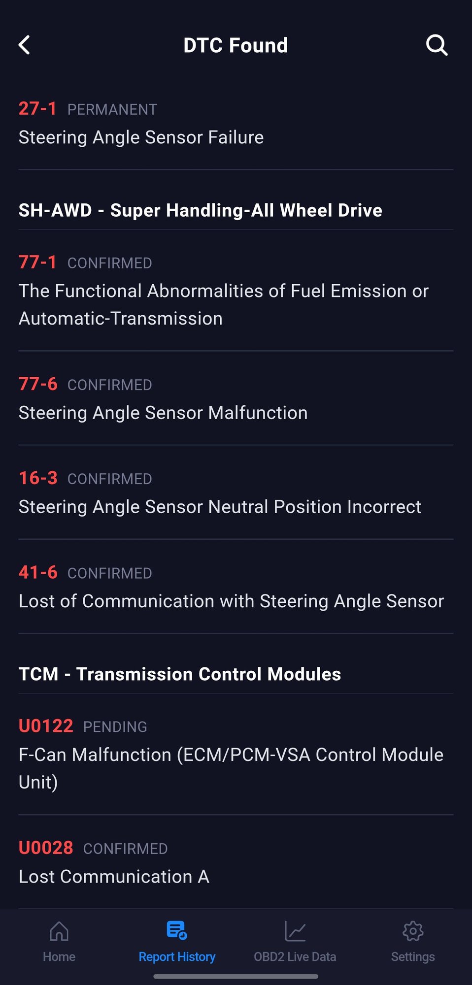

so basically i am not a mechanic i don't know much of the stuff it would be helpful if you suggest a good mechanic near boston.
But I guess the errors are due to the steering angle sensor after resetting it again the errors came back.

I'd guess it's a bad ABS pump rather than any of those sensors it's complaining about. I'm not far from Boston and have a spare on hand; it's a very easy part to swap and see if that changes anything.

The car came to me with most of the same codes listed above - including P2263*. I replaced the ABS pump, did an ABS bleed on all four solenoids with my scan tool, and then cleared codes. After a test drive, the only codes remaining were for the gauge cluster and TPMS. No more P2263 or ABS codes. Bingo, or so I thought...
I got a text this morning from Adwait saying he's getting lights on the dash and codes again. The codes are mostly the same as before:
P2263
U0155
ABS codes 25 (yaw sensor), 26 (lat acceleration sensor), 47, and 85
*I had brushed this off as the prior mechanic not cleaning the code after doing the fix. In hindsight this wasn't very logical and should have alerted me to potential electrical gremlins, which is now what I'm thinking.
This RDX needs a brake bleed which we'll be doing next. I'm not sure if dirty brake fluid might be part of the culprit, at least with the ABS issues? I'd like to think it is, but of course that wouldn't explain P2263 coming back.
