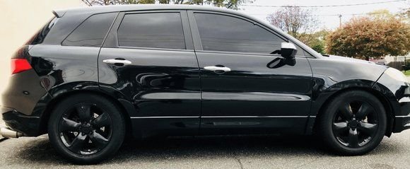

Old Sep 7, 2020 | 06:38 PM
CSmoney28's Avatar
CSmoney28
Joined: Nov 2013
Posts: 1,420
Likes: 182
From: New York State

You don’t need to go lower than the standard kit I’m half way down the coil over and the wheels have no gap at all
