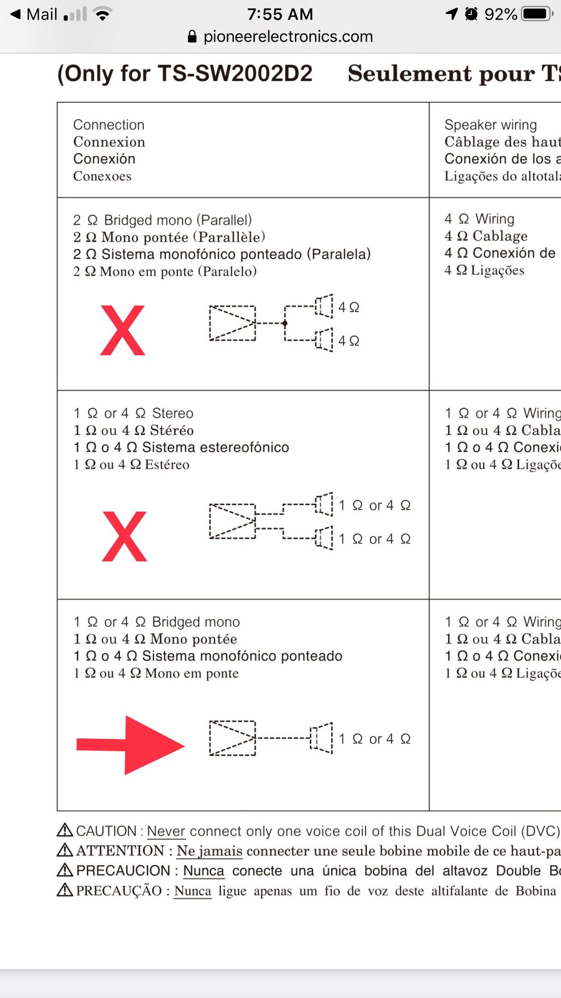

Ok, so looking at the manual again, it makes sense now, and definitely does NOT support a 2ohm configuration as a "drop-in"
See image below: the only supported config for our RDX ELS amp is a single speaker config.
As you can see in the image from the manual, a single speaker config only supports 1ohm (parallel) or 4ohm (serial) as indicated in that youtube video. A 2ohm config is only supported if you're using (2) of the Pioneer subwoofers in the configs shown in the first row of the manual image.
So yea, the Pioneer is NOT a compatible speaker for a drop-in unless you are building a custom cabinet and will be using either two of them or you're replacing the ELS amp with something else.

the Fostgate is a DVC 4ohm, which as shown in the video, if wired in parallel and used in a single speaker config, you end up with a 2ohm load, which is what is needed for our factory amp 👍🏼The key to remember when using DVC subs is that in our RDX, we are only using a single-speaker config. That's where it can be confusing like with the Pioneer DVC 2ohm where it shows 2ohm supported, but only when using two of them wired to the same amp.
