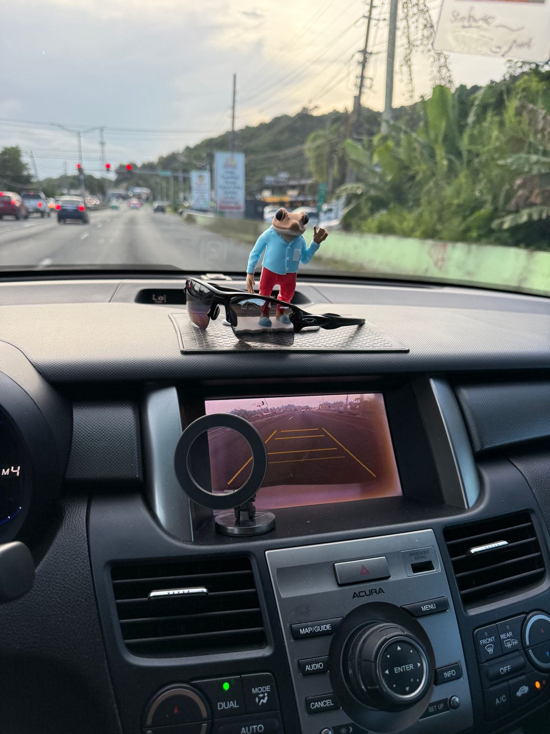

One day I was washing my RDX and suddenly out of nowhere, back-up/reverse LED bulb lights were ON.
I turned on the vehicle and reverse camera is stuck always ON. Had to disconnect my reverse bulbs because that was the only way to get them off.
Did it happened to someone over here?

Somehow that light blue wire that goes from the fuse to the backup lights is getting voltage even when the car isn't in reverse. Possibly a short from an adjacent wire? Where specifically were you washing the car when the issue started?

I was washing it in my house, no car wash. A while ago it started intermittently, while driving, backup camera popping in and out until that day at the house got stuck always on.
Do you think the Neutral Switch is bad?
How do I check that adjacent wire you mentioned?
