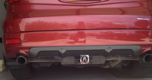

I did a similar 4-way wiring harness from eTrailer for my 08 RDX around 2014 for a bike rack with lights (fat tire ebikes) and swing out cargo carrier with lights. I ended up just doing the hang out the hatch when needed instead of trying to find a path for permanently mount the harness to the exterior of the aftermarket 2" hitch. There really wasn't a spot to mount the harness on the hitch I purchased from eTrailer? Just left it curled up in the spare tire wheel well until I needed it. Zero issues over the years doing the hang out back thing (handed down the RDX to daughter in 2019).
Old pic of 2" hidden hitch:
