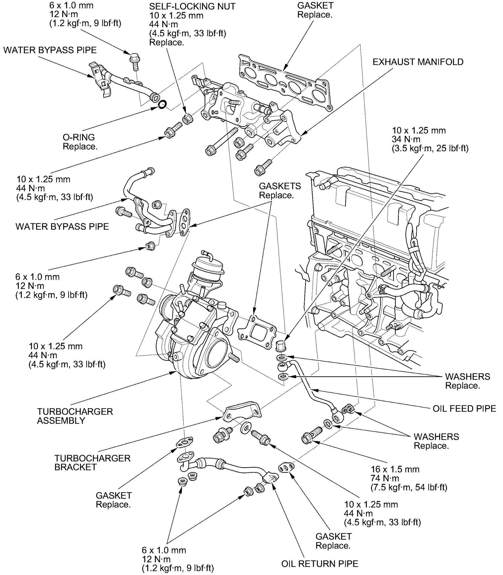

Looks like he was typing to fast & was talking about his 2009 RDX:
OP, are the studs you are referring to shown below?

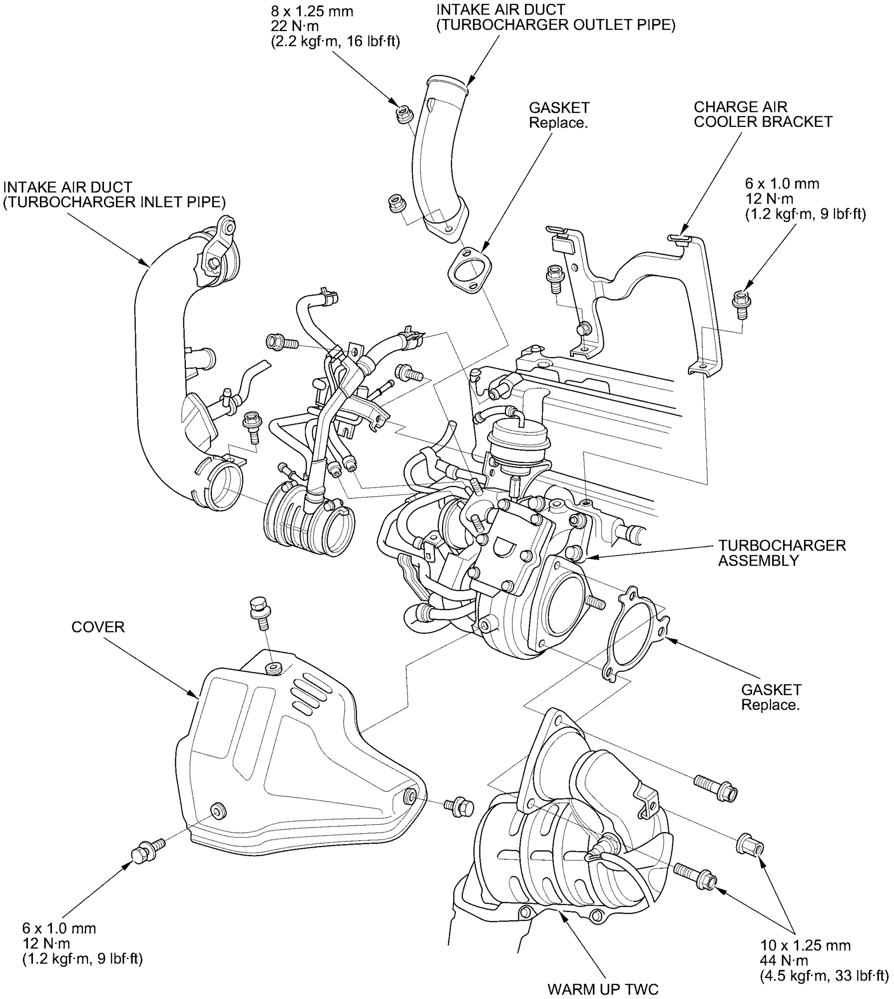

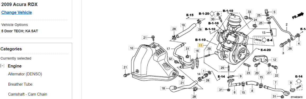

They mentioned in a previous thread they were replacing the turbo. I attached some additional diagrams but not sure how else to help. It's a whole bunch of M6 and M10 bolts for the turbo components.
