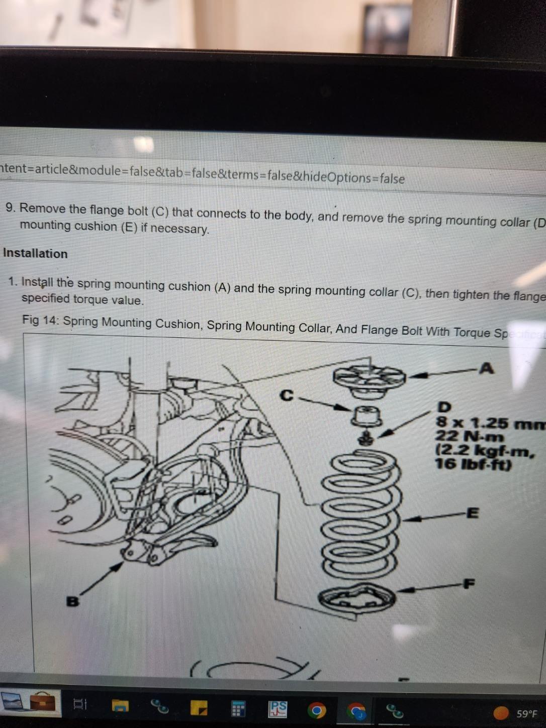

Next week I will be replacing the rear shocks, rear stabilizer end links, as well as rear springs. With this in mind, I thought I'd re-visit this thread which I bookmarked quite some time ago.
For anyone curious, my friend a mechanical technician at a local shop and forwarded me a few screen shots, regarding Acura's recommendation for removing the rear springs.
It is recommended that you remove the following:
a) Remove stabilizer end link from lower control arm
b) Remove flange bolt that connects the lower arm to the knuckle
c) Remove flange bolt that connects lower arm and bottom of damper (i.e. shock)
Theoretically, removing these three bolts should allow the lower arm to drop enough to remove the spring. Wish me luck!
