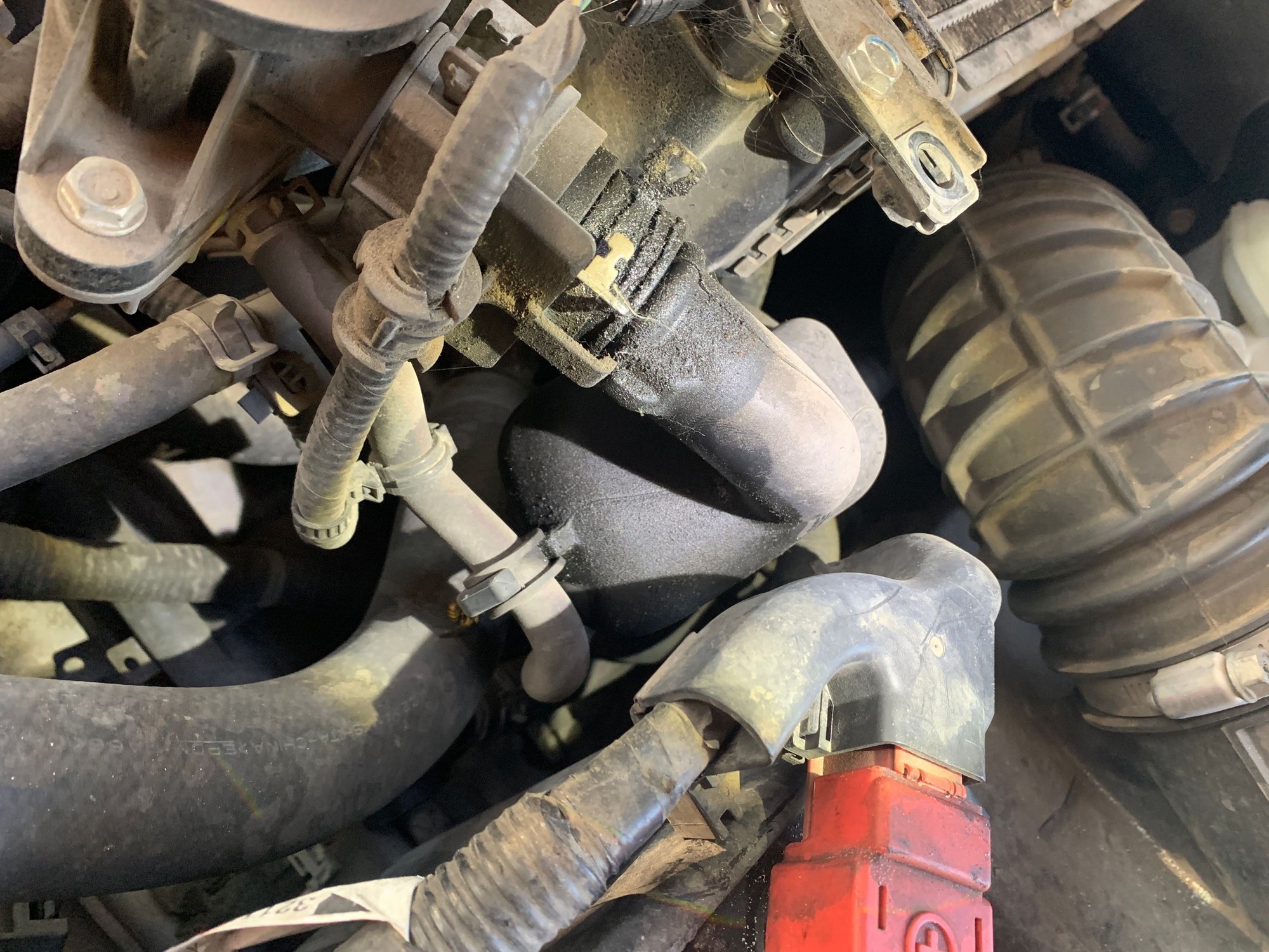

Hey guys, like the title says. Bank 1 too lean, as well as an AWD code which I’m pretty sure is just being thrown on safety mode because they turned on the same time.
From the research I’ve done, people are speculating O2 sensor, plugged cat, or vacuum leak. I don’t think it’s a vacuum leak because I looked around and didn’t hear a hiss. Any advice on where to start?

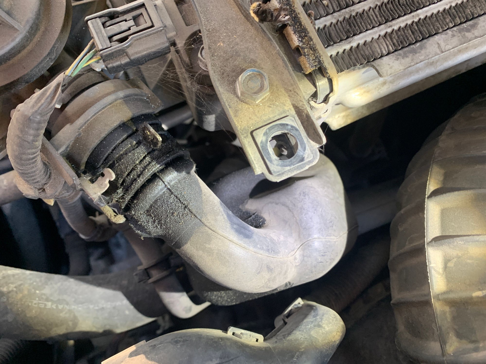

I did see some wet hose as if it’s leaking a bit of oil, not sure if it’s PCV valve? It runs from the inter cooler area to the intake pipe after the air filter. Photo attached.

Changed spark plugs with OE laser iridiums yesterday. Had a good look at all vacuum lines with the intercooler removed and didn’t see anything glaring as a leak, I.e. no cracked or otherwise faulty lines. Code reader saw normal voltages for the o2 sensor(.5-1v).. going to get fuel system cleaner today to hopefully clear out a clogged fuel injector if that’s the problem?
any insight or troubleshooting tips, please, don’t all jump in at once. This one kind of has me stumped and I’d rather not throw hundreds at it to guess and check. Thank you!
