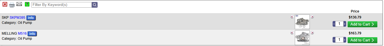

Oil pump availability:
RockAuto:
online OEM parts vendor:
