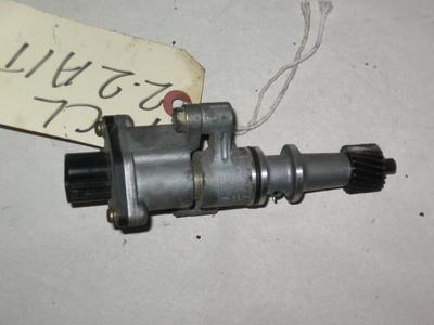

Pic i found on ebay:
Thats $55
I also see what looks like just the sensor (generic pic)
Do i need to replace the whole assembly (top pic) or just the sensor (bottom pic)

your problem does not sound exactly like mine. which is most likely just the sensor since my abs still works. you might try spinning individual wheels to see what happens. but try the sensor and if nothing then try the motor.

I would not recommend replacing that sensor unless your speedometer has quit working. That is a Vehicle Speed Sensor or VSS. That speed sensor has nothing to do with the ABS system. It is only used for speedo, ECU and Auto Transmission functionality.. replacing it will not fix an ABS issue.

I almost bought a similar VSS to the bottom picture that Blind_Shooter had posted. (My speedometer works fine so I would have wasted my money).
a) Is the top picture that he posted the correct looking one? Also, I tried the "acuraautomotiveparts.org" and "acuraoemparts.com" sites but couldn't find the right part #. Do you know what the OEM or aftermarket equivalent part # is for a Rear-right Wheel Speed Sensor?
b) Will the same WSS work for any wheel or does each one have a specific part?
c) where do I find and how do I remove the "ABS B1" fuse as you mentioned?
I'm almost sure cleaning won't work and I need the part since the light is off every time I start my car but turns on after I just start rolling. Like you said, the problem is VERY common and lots of us online have the same symptoms.
THanks a lot for your help.
Old Nov 25, 2008 | 10:09 AM

2) "57470-SV4-950" - Is this the OEM part # I need and does anyone know if there is a cheaper alternative equivalent part?
Thanks, I want to fix this asap!

2) Some are saying it's 57470-SV4-N00 instead? I drive a 2.2cl 4CYL. Which one do I need?
a) 57470-SV4-950
b) 57470-SV4-N00
Thanks

I called 2 different Acura Stealerships and both said the part I need is (57470-SV4-N00) which is $244.40 Cdn (Approx $198 USD).
Most of the online parts shops sell this part for about $117 USD. Problem is that most online stores say that 57470-SV4-N00 is for models:
Years: '94 - '97
Models: ACCORD WGN EX, ACCORD WGN LX ABS, ACCORD 4DR EX LEATHER/V-6, ACCORD 4DR EX V-6, ACCORD 4DR LX ABS/V-6, ACCORD 4DR LX V-6
And the online acura one I found (acuraoemparts.com) says:
Fits Models: All CL Models Except : CL 2DR PREM, CL 2DR PREM NAVIGATION, CL 2DR SPORT, CL 2DR SPORT NAVIGATION
hondapartscheap.com says that 57470-SV4-950 works for:
Years: '94 - '97
Models: ACCORD 2DR DX ABS, ACCORD 2DR EX, ACCORD 2DR EX LEATHER, ACCORD 2DR LX, ACCORD 2DR LX ABS, ACCORD 4DR DX ABS, ACCORD 4DR EX, ACCORD 4DR EX LEATHER, ACCORD 4DR LX, ACCORD 4DR LX ABS, ACCORD 4DR DX
I would figure my car should be similar to the Accord 2DR EX Leather since it is a 2.2(F22B1). So I am still stuck at square one:
Is it 57470-SV4-N00 or 57470-SV4-950?
Old Nov 26, 2008 | 03:42 PM

57470-SV4-N00 will work 100% on a 97. Accord shared many ABS components including sensors.
a) no. here is a picture of a Honda/Acura rear speed sensor. Honda/Acura ABS components always have orange connectors, just as all SRS components are bright yellow.
b) every wheel sensor is part-specific. There are 4 separate part numbers for CL wheel sensors. This is because they have to follow a very specific profile along the suspension and body.
c) the ABS B1 fuse is located inside the ABS fusebox. it is the smaller fusebox located near the battery. You can open it and see about 3 or 4 fuses and some relays. on the cover, you will see the fuse names "B1, B2 etc." The B1 fuse is the backup power to the unit. Obviously, this can only be done with the ignition off and only applies to 1997-down cars.
and ya, cleaning has a very small chance of fixing the problem. years of suspension travel just break the wires inside and cause them to short/open. since its a safety related item, the computer is ultra-sensitive to any deviations from the norm.

Thanks Mang...... I'll order the 57470-SV4-NOO and see if that works.
I appreciate the help.
