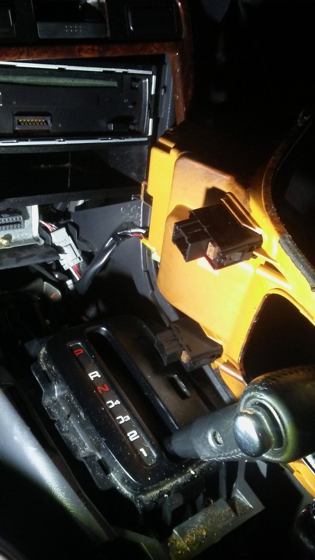

When i first got my car the heater for the seats worked fine. I read the posts above and it seems like mine wasn't working right either. The bottom(Ass lol) heats up but not the back. Same goes with the passenger. I recently took it to a mechanic who got under the wheel and I believe he did something with the fuse box. Not to mention that he had replaced my Shifter Cable. He kept the car overnight and the next day when I went to pick it up my seat warmers didn't work at all. I just finished repaving the fuses inside and the single fuse in the engine bay
Old Jan 10, 2017 | 10:21 PM
Duarte12's Avatar
Joined: Dec 2016
Posts: 21

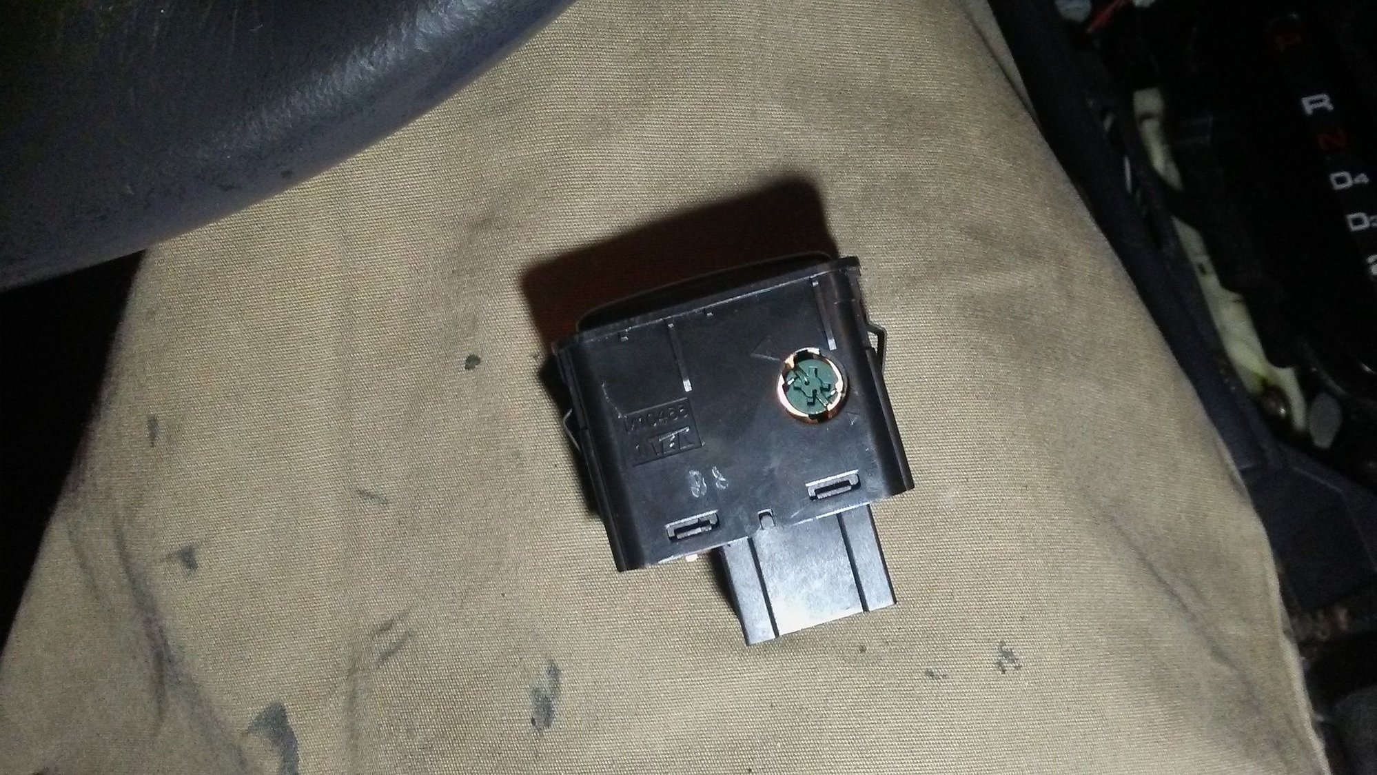

i think this is an old thread but i recently figured out what was wrong with heated seats. The cables where not connected to the buttons. I connected them and then i tried them and the driver side bulb worked. the passenger side bulb didn't. I switched them and i tried it again and i found out that the bulb on one was out. Its a small one (Didn't have a ruler or something) But i took some pics.
Also does the bulb have anything with the switch not working? or the bulb is just there for lighting the button.
I am looking online for a bulb if anyone can help me out with the dimensions.

green bit is the bulb from outside
