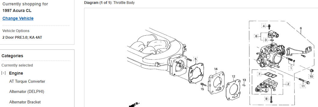

If you have a DTC for the EGR system it certainly would not hurt to investigate / clean.
In addition, if you have not cleaned the throttle body and / or the IACV, #2 below, recently that also may aid your efforts.
If you need a new IACV rockauto has aftermarket alternatives for a lot less the the $324.52 OEM.
Throttle Body - 1997 Acura CL 2 Door PRE3.0 KA 4AT
Thank you for the reply, seeing as I'm already going to remove the manifold I will also clean the throttle body and the IACV as suggested. I'm hoping I don't have to purchase any new parts (besides a new manifold gasket) but if I do I'll check out rock auto/ carparts.com. The car has 116k and a lot of the parts are original. I recently had a fun time with my ignition switch causing the car to shut off while driving (Acura dealership claimed my vehicle had no recall parts LOL), just replaced it anyways and it stopped doing that, So naturally my car has decided to be stalling out for another DIFFERENT reason!
