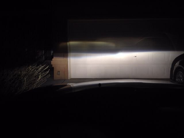

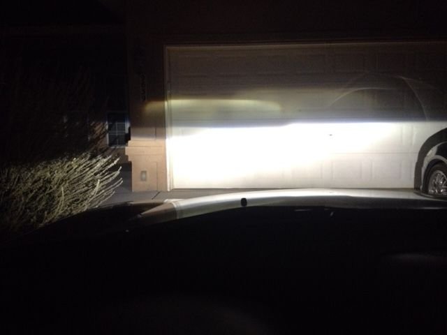

I would get some extra clips in assorted sizes just in case you find missing ones or damage a few during removal. I ended up replacing 1/3 of the clips on my 08 RDX when I upgraded the HIDs (OSRAMs Cool Blue 5000k-6000k) because of them being missing, damaged during removal, or the clip hole was worn too large for the OEM clip to stay secure.
Amazon Amazon
I liked the OSRAMs so much on my RDX and I upgraded my HIDs on my MDX with the same ones. Noticeable improvement over OEM HIDs bulbs. It would just be an extra 1 minute to install since you already going to have the headlight assembly off. SIDE NOTE: you can upgrade the HIDs later and you don't have to remove the bumper of the MDX. I was able to change them out and I just removed the battery to give me more room on the driver's side.
Amazon Amazon
OEM HIDs before install in 2014:
OSRAM Cool Blue 6000k the next night after installation:
