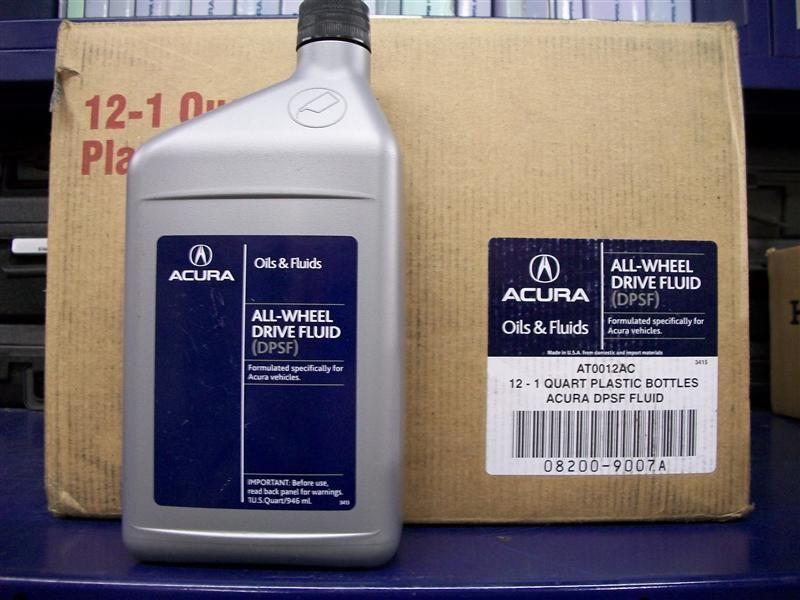

1G Uses 3 quarts of VTM4 Fluid: 08200-9003 but its sold as a Gallon:
2G Uses 3 quarts of AWD DPSF Fluid: 08200-9007A Sold by the quarts:

one more thing, I try to start new thread and cannot find way. my another question is what's difference between honda 08200-9007 is Dual Pump Fluid II and acura 08200-9007A is DPSF, the part number has a little difference, i guess A means Acura. can i just bought dual pump fluid II for mdx use? thank you.
Old Apr 21, 2017 | 05:09 PM
Skirmich's Avatar
Joined: Jan 2009
Posts: 6,509
Likes: 1,021
From: Baja, México.
If it was any other Part Number you will be correct, That "A" only means Acura in a lot of cases but in this case:
The difference is that one is made for your car and the other is not.
Honda DPSFII (Dual Pump System Fluid II) is designed to work with the far lesser system used in the Honda CR-V AWD which uses a different Differential system than the SH-AWD. The CR-V Diff uses a direct coupling wet clutch to send power to the rear wheels which means the oil has to have lots of anti-slip properties in order to hold the direct drive from the diff to the wheel.
Acura AWD DPSF was designed to work with SH-AWD Differentials.
The SH-AWD Differential is a Different Animal all together, since it can over-drive the rear wheels in order to Torque Vector through a corner it has a set of Sun and Planetary gear sets for transmission. The Clutch Disks only function as a Stop Mechanism to hold the Planetary Gear set in order to overdrive the Specific Wheel.. This means the Oil has to have more Gear Protection than Anti-Slip properties.
You can have both side to side and immediately notice that:
1.- Color is Different, SH-AWD is a Caramel Color while Honda DPSF II has a Dark Tint.
2.- Smell is Different, SH-AWD has a Strong Synthetic smell while DPSF II has a normal ATF Smell to It.
In Summary..
DO NOT USE HONDA DPSF II FLUID.
Use only Acura AWD DPSF 08200-9007A.
They are not interchangeable and do not Trust a Honda Service Clerk telling you it will... Acura AWD DPSF is not a Repackaged Honda DPSFII in any way shape or form.
