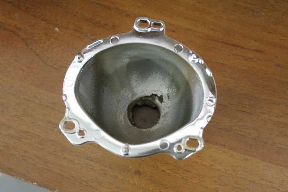

Are you sure that sometimes they shine brightly? If not, then I would take off the headlight, take out the bulb and check the reflector. If used correctly, Acura does not have problems with reflectors, but some people constantly drive with the light on and reflectors burn out, in my practice there was Acura in which, after 6 years, the OEM reflectors burned out.

The lenses are glass and have an unlimited lifetime. But the inner reflector is plastic and could burn out. It is necessary to remove the headlamp and take out the lamp to look into the lamp hole and visually diagnose the condition of the internal reflector. In Russia, reflectors are made on MDX, they are made of iron, unlike OEM and have a lifetime warranty. It doesn't take long to replace them, but you will need a kitchen oven and 3 hours of time. https://www.alpha-light.pro/remkompl...-otrazhateley/

I came across this post: https://acurazine.com/forums/third-g.../#post12741936 It states painting inside black. How would that be different than in this situation where possibly my projectors housings are degraded and are not reflecting light? Is there a different bulb that sends the light out directly forward and doesn't need to rely on reflective housing?
I think you have 2 cheap choices.
1) Buy Afrermaket ($ 360), and spend 1 hour replacing them. They are for 2007 - 2009 MDX , but I still have not found any differences, so I think they will fit in 2010
Amazon Amazon
2) Buy reflectors ($ 120 with delivery) wait a month for them, then spend 3-5 hours replacing them and polish( $23
Amazon Amazon
) the inside of the glasses.
