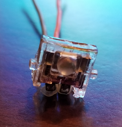

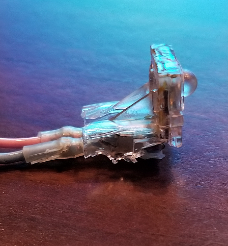

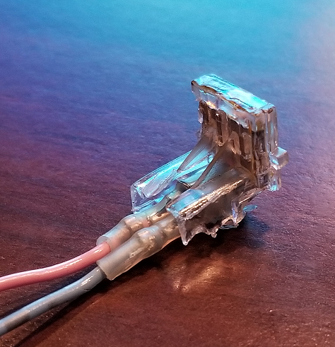

This is a LED for the Acura illuminated sport running boards.
Anyone have an idea where I can source a replacement LED?
Unfortunately, there are no identifiable markings on it.

All things considered, I'm thinking a marine application LED would be the best from an environment standpoint.
I'm guessing those running board LEDs are 12V?
its best to check with voltage tester

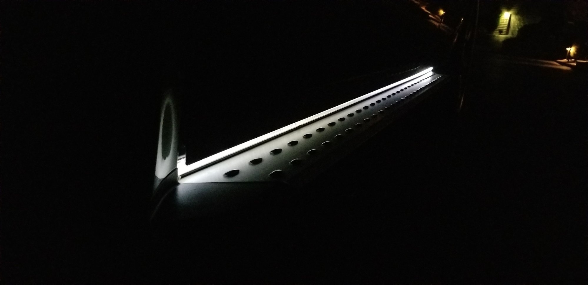

Pulled the side panel, yep 12V.
Soldered in the replacement, back to OEM illumination.
