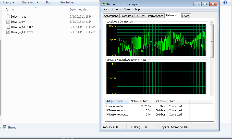

I have 4K jumbo frames enabled at all locations on my network running a GB switch and cards.
Writing a drive backup over the network peaking around 75% utilization:
Anyone have any real world data on benefits of 9K vs 4K jumbo frames?
