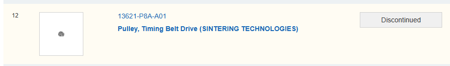

Acura discontinued crankshaft gear
Any time you come across a 'discontinued' component on any U.S. Acura / Honda online vendor, check the part number on amayama and it may be available in Japan?
