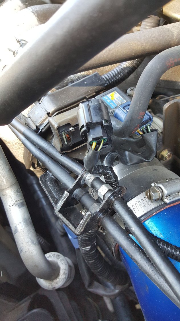

Hi there,
I have an 02 RSX Type-S and I recently got in an accident which broke the sensor pictured below. It is located above the throttle body and I was wondering what it is, where to buy another one, and how to replace it.
If I could get some tips that would be great!
Thanks!

https://www.oemacuraparts.com/v-2002...le-body-type-s
Either the MAP sensor or Purge Control Solenoid

Acura Part No.: 36162-PNC-005
Valve Assy., Purge Control Solenoid
