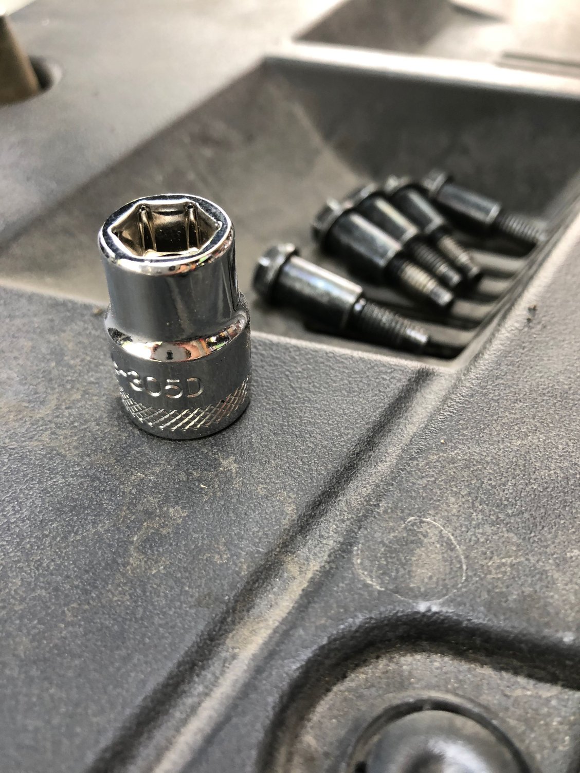

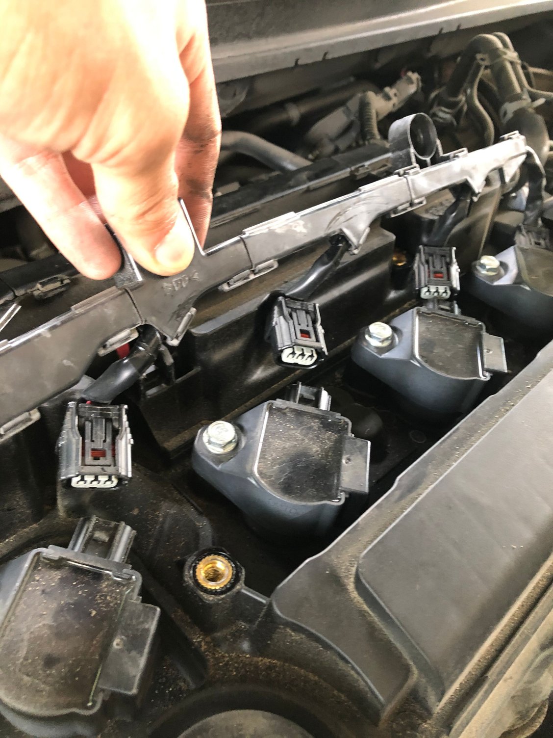

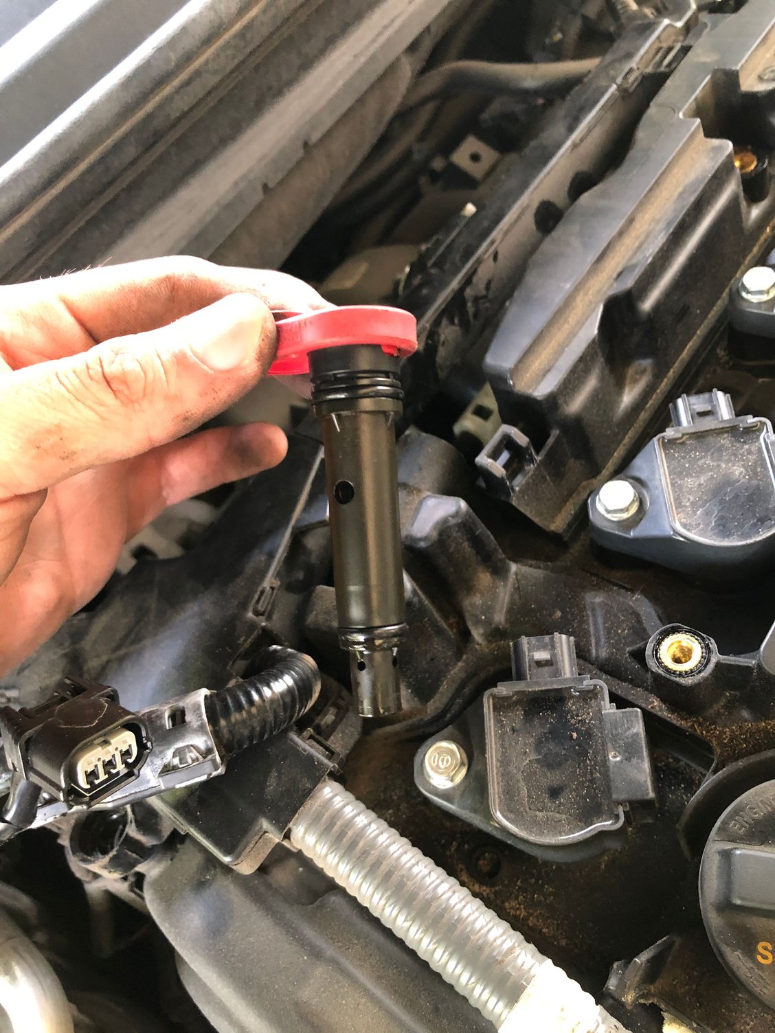

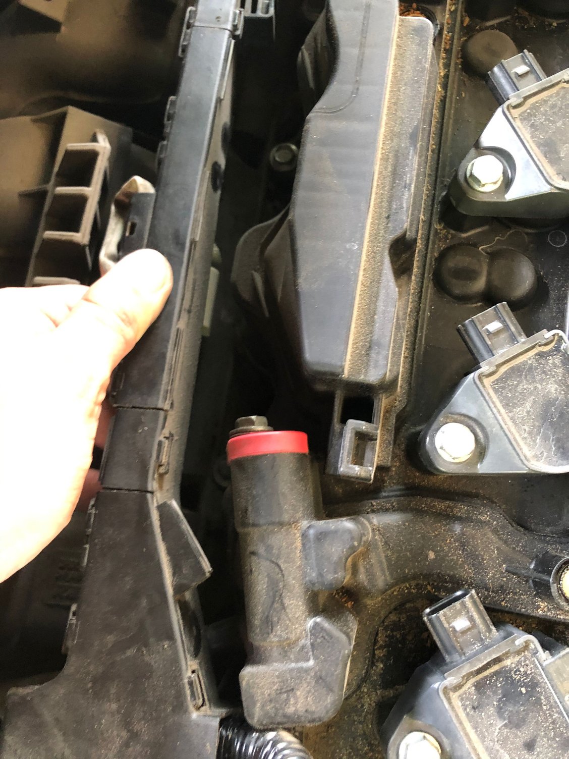

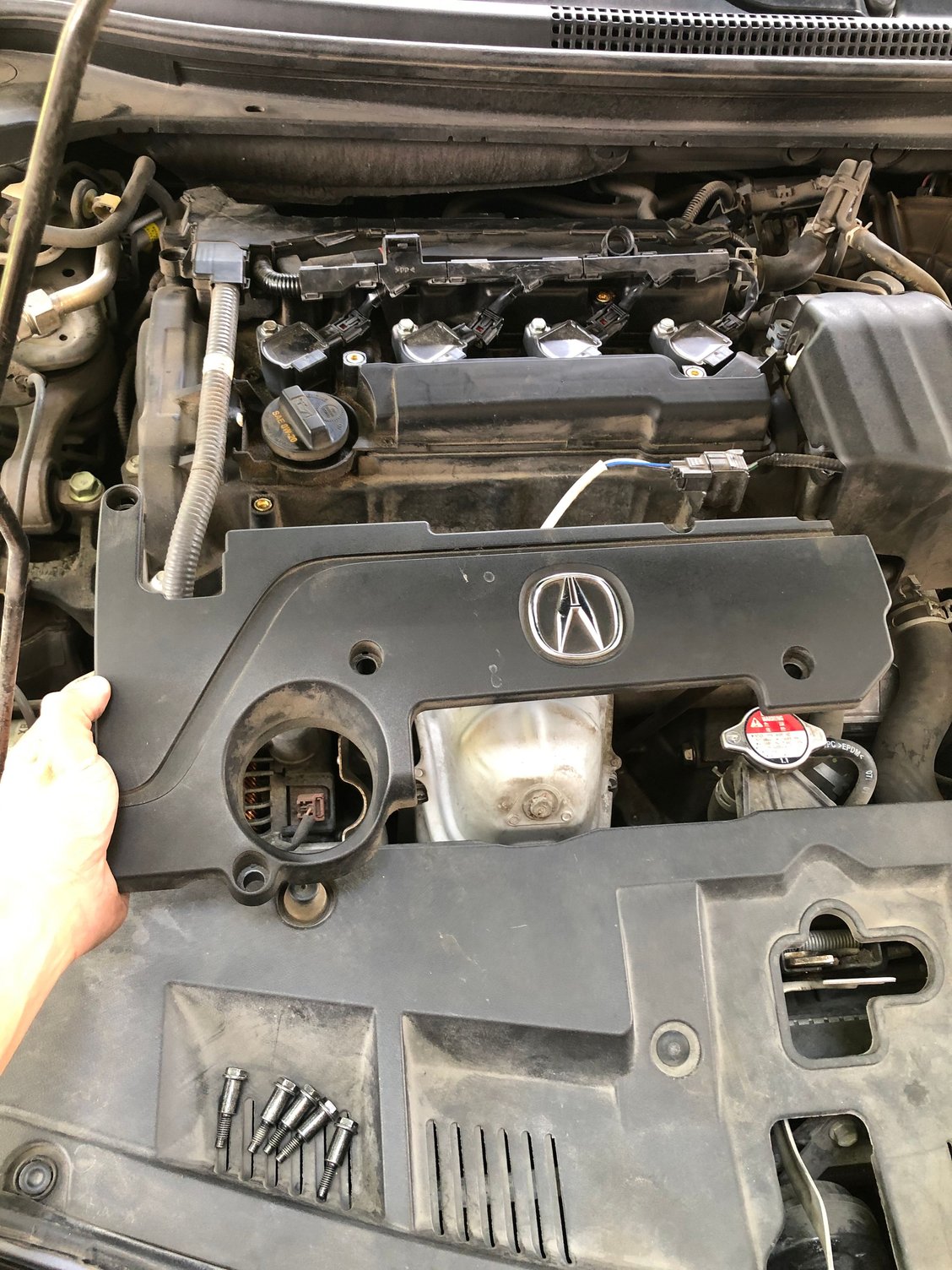

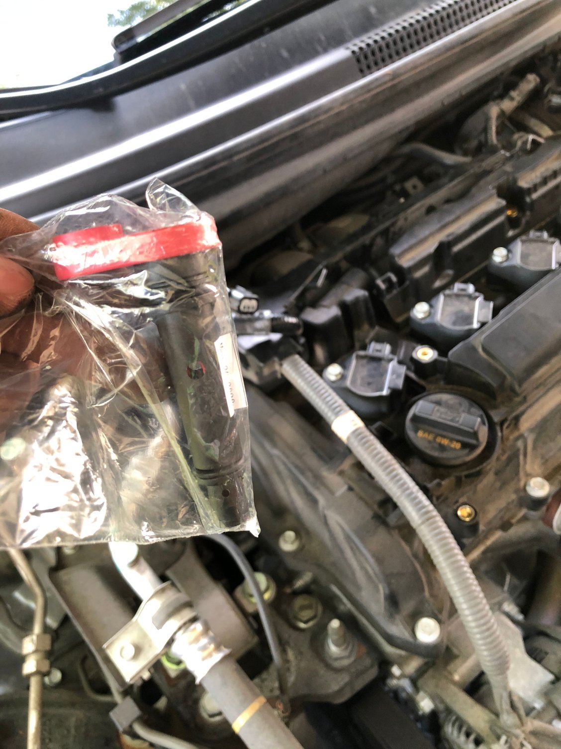

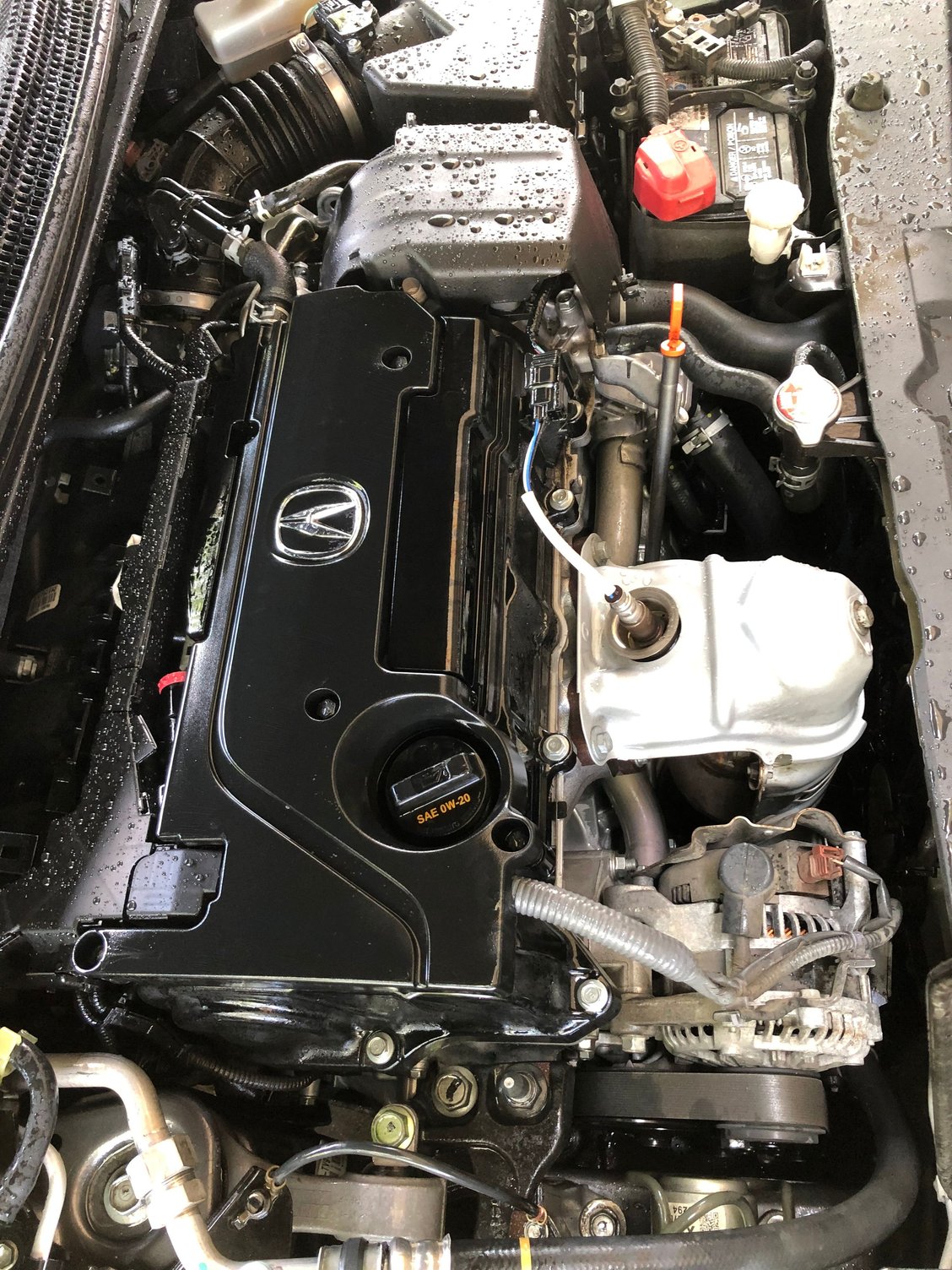

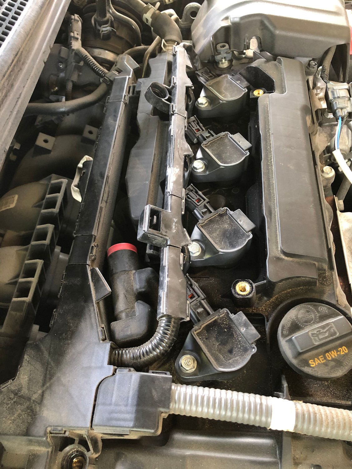

Here’s the steps T
10mm will do it all
Unscrew all with 10mm then set the cover to the side
Pcv is right there hidden

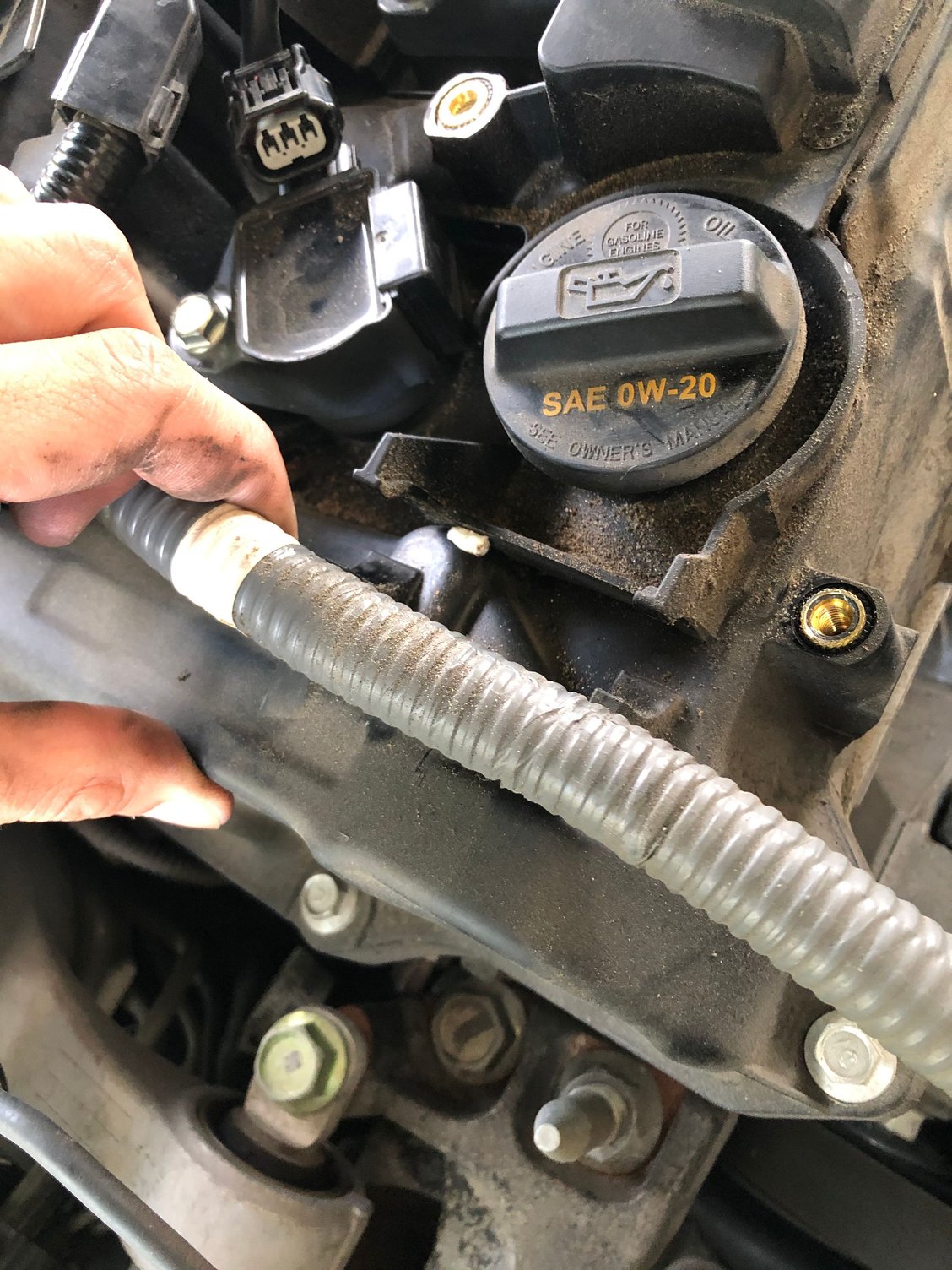

Unplug all coils
Pull this to up and move to the side

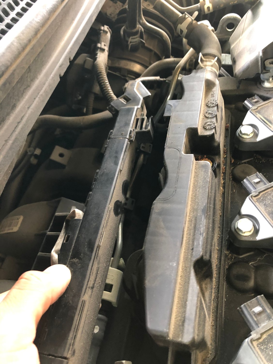

Slide it down to your direction
Slide it more to the side for more space

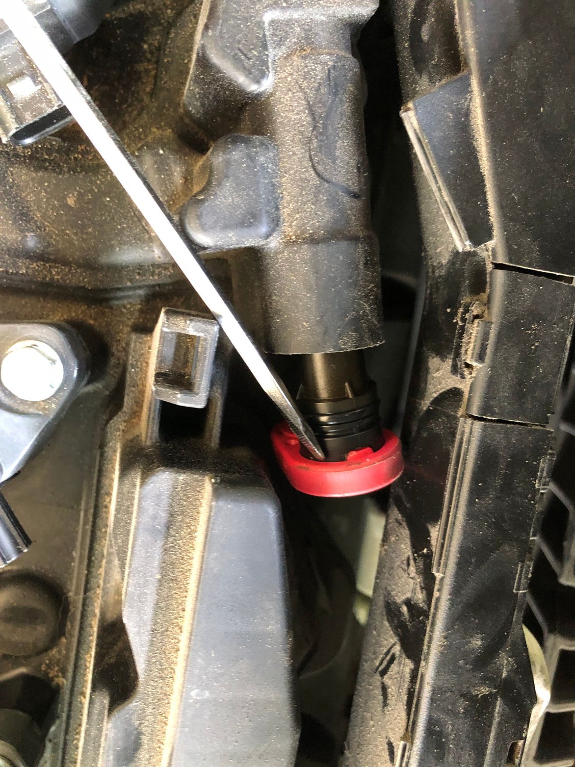

I used a flat head which was way easier
Ta-dah

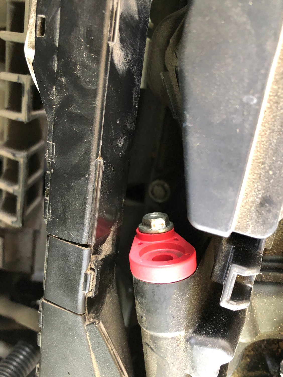

Now just simply add the new one in and screw it back but not hard since it’s plastic
New one done
All set
