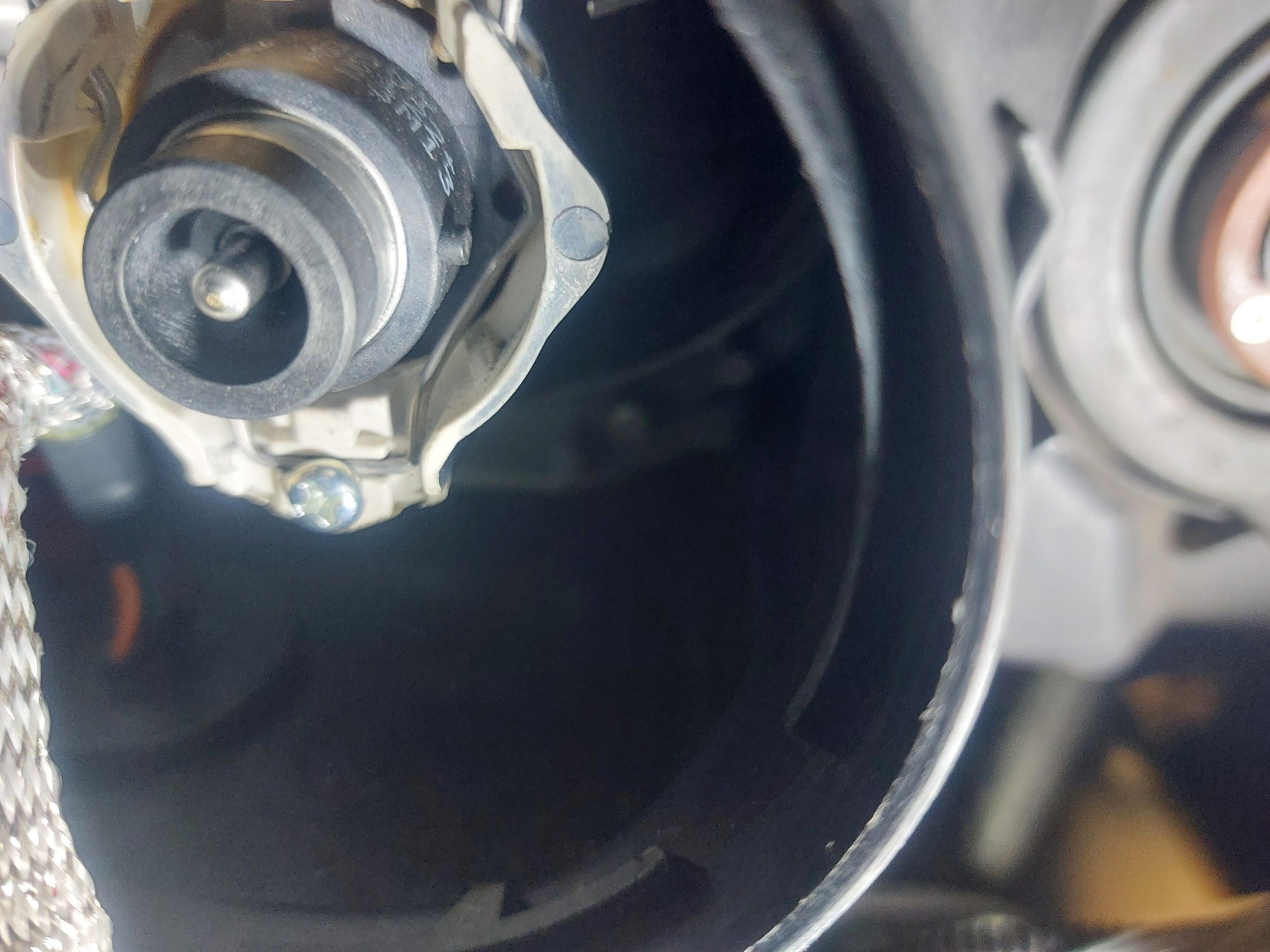

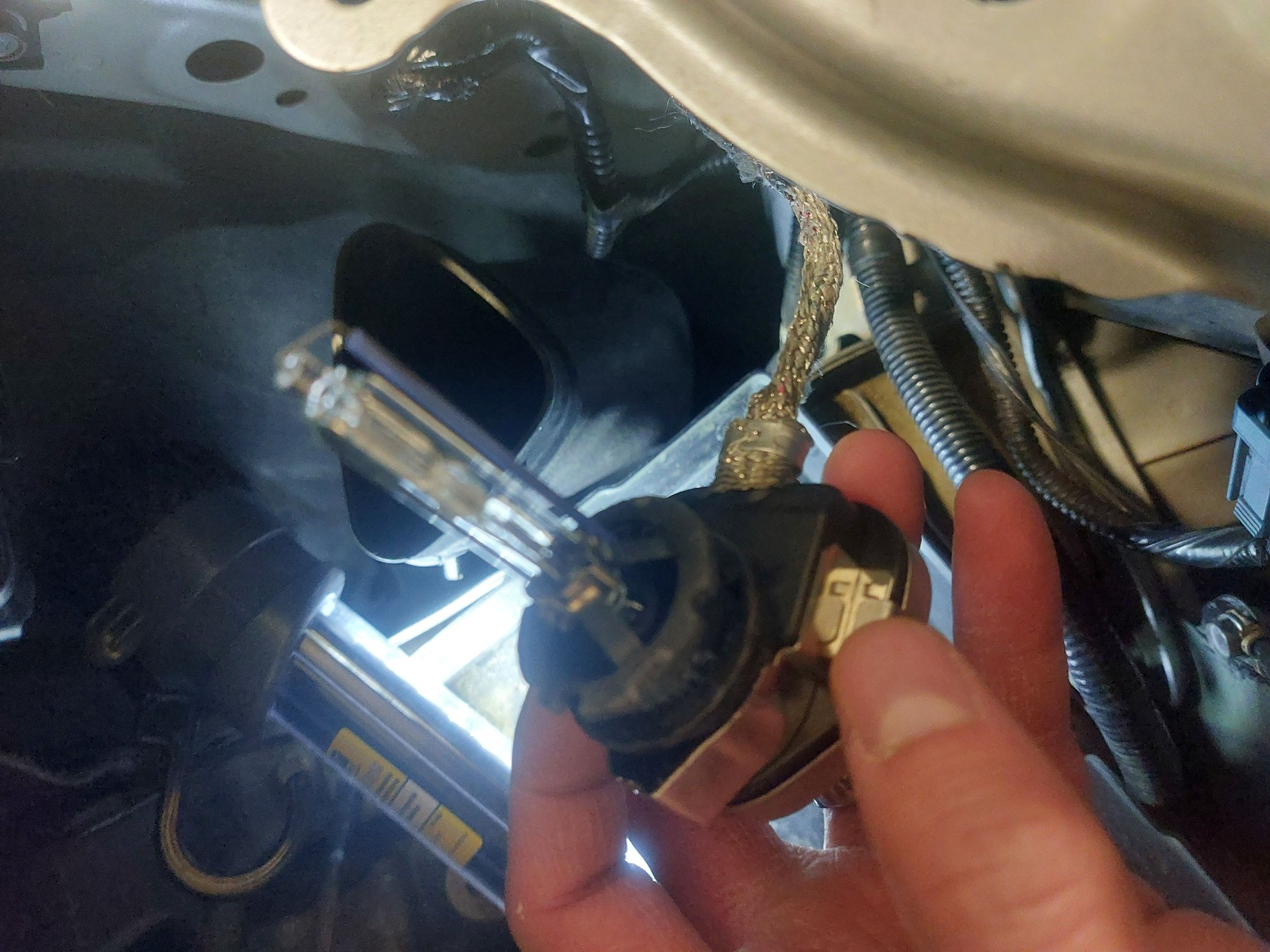

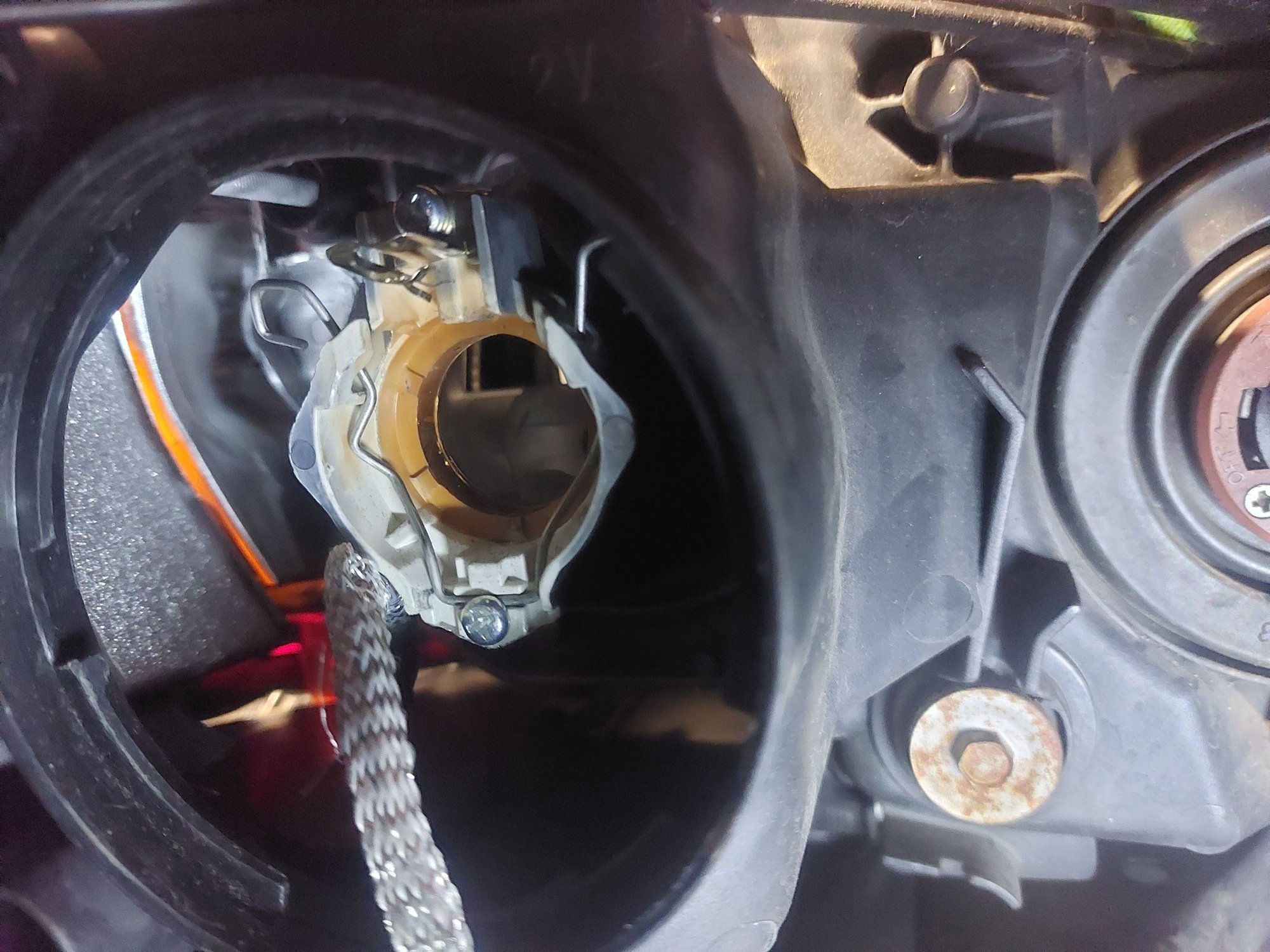

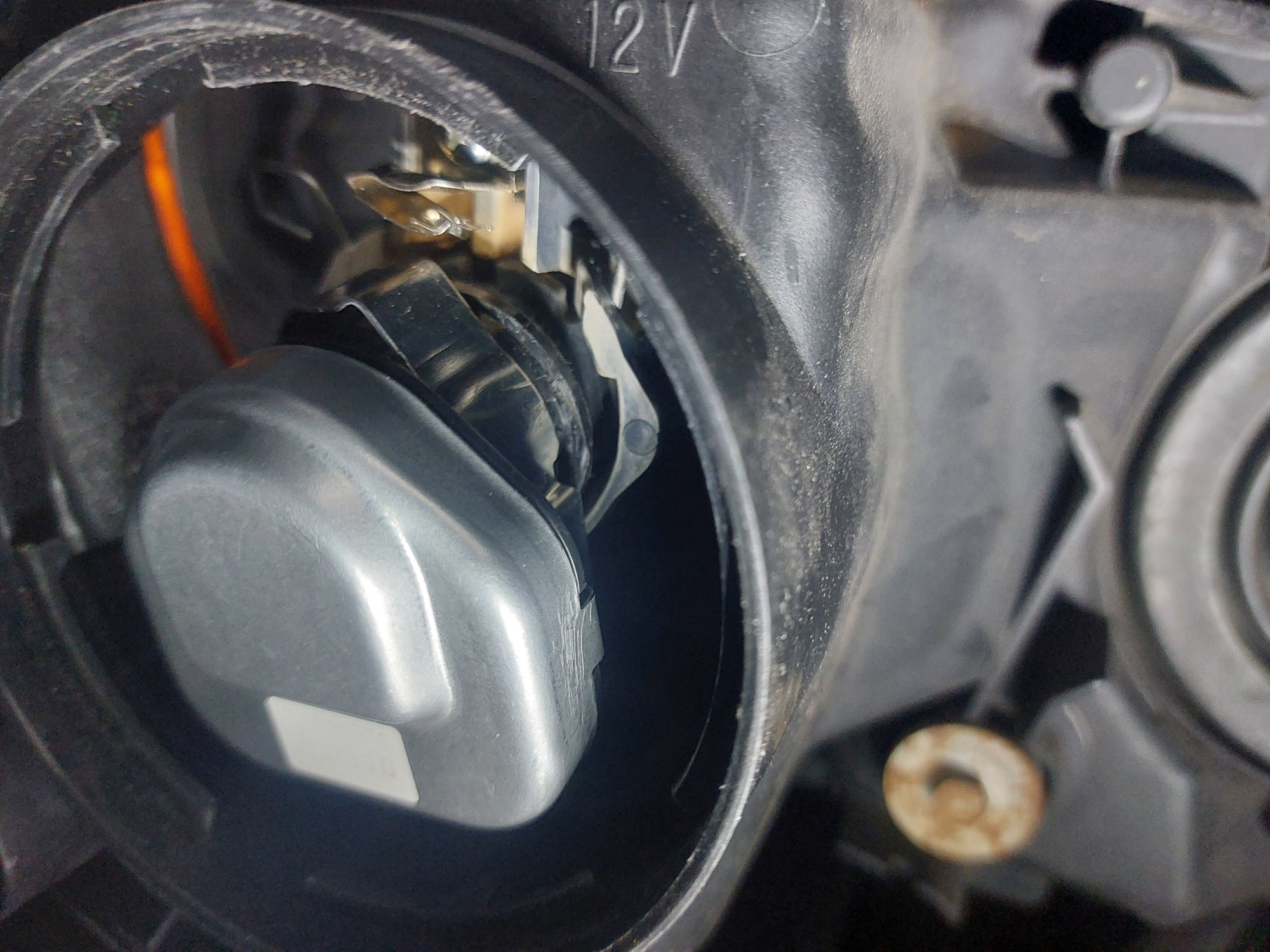

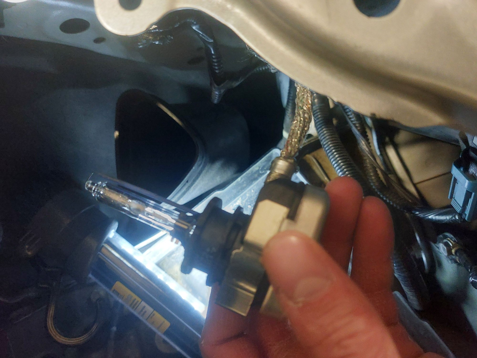

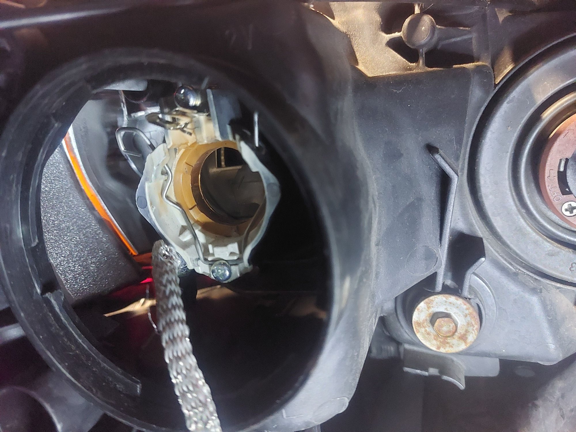

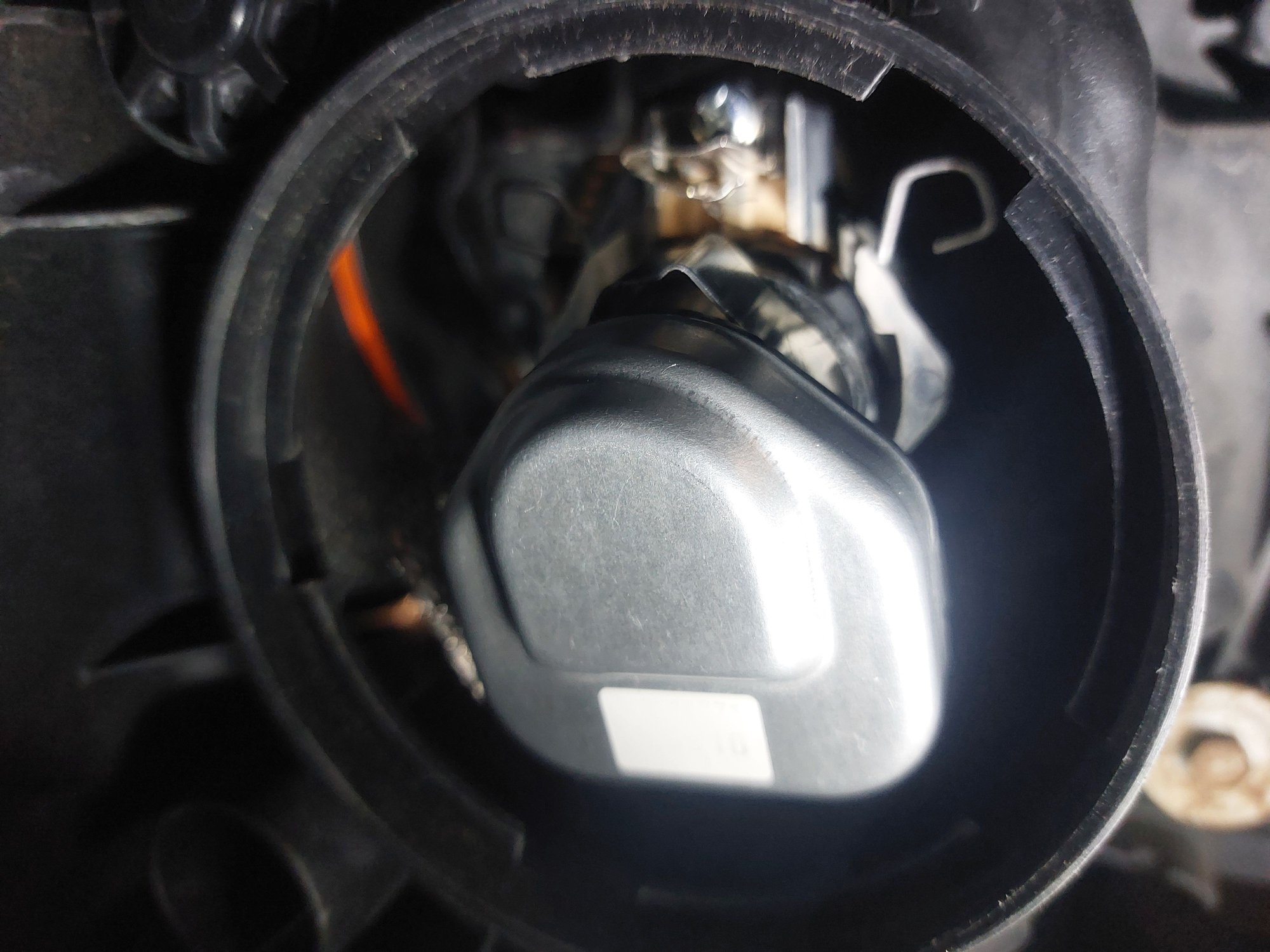

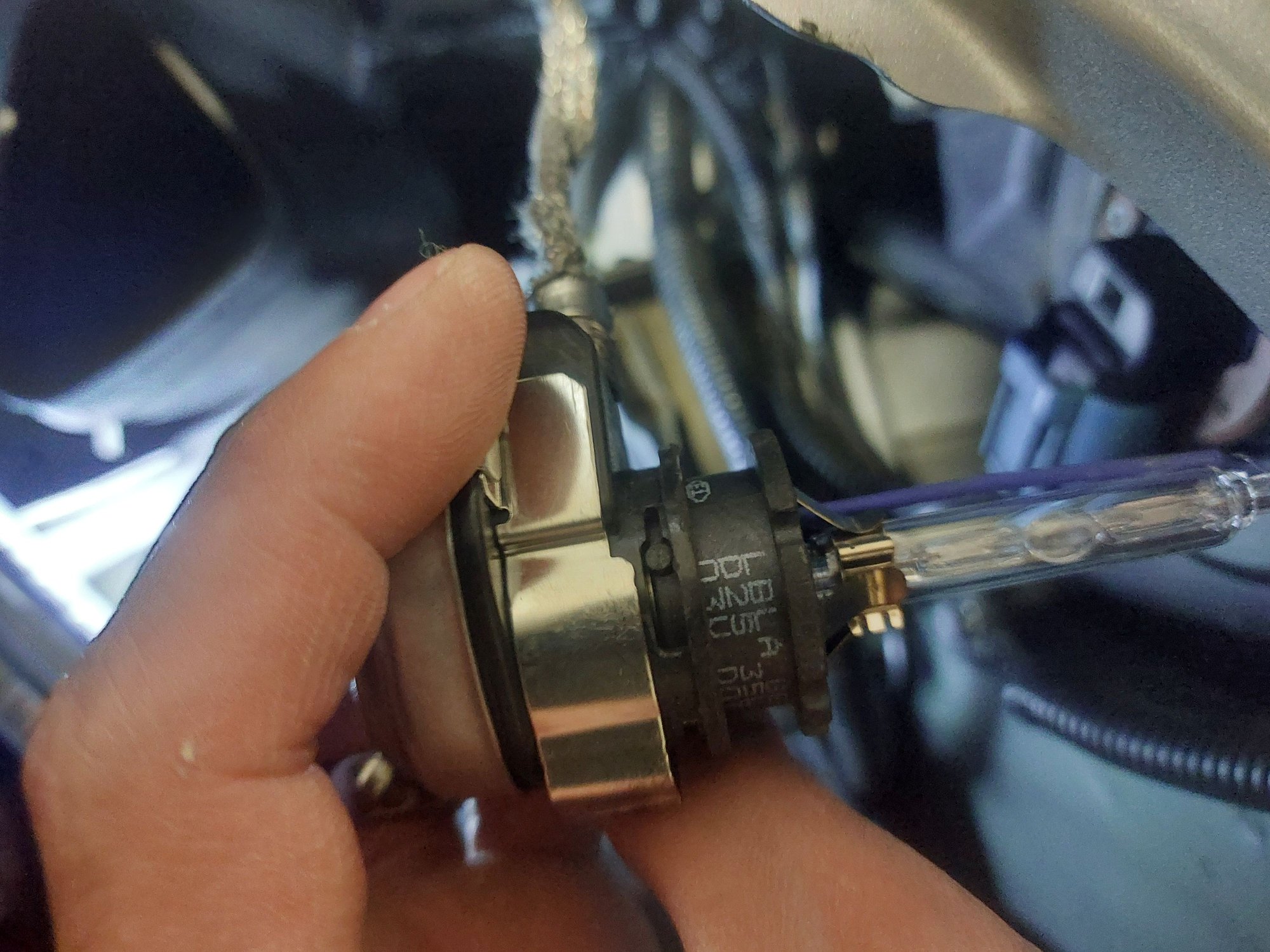

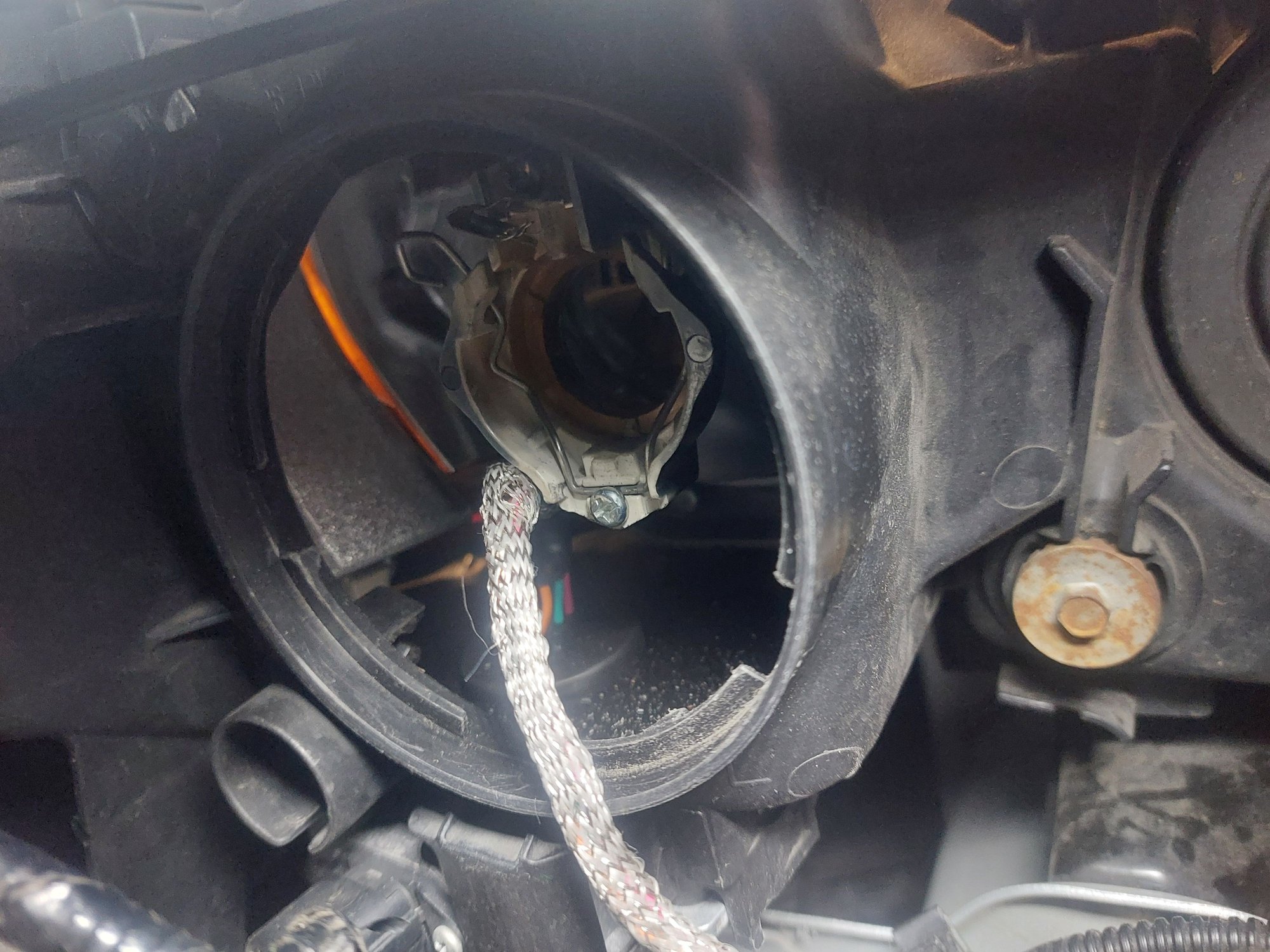

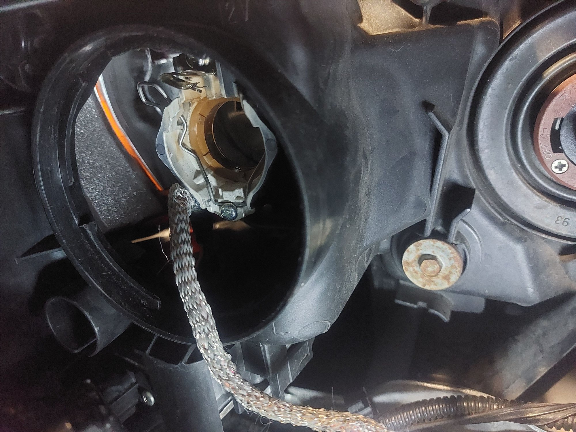

The bulbs fit tight and okay in the ignitor socket. It seems the problem is when installing the D2S bulb first in the headlamp socket, the retainer string clip doesn't hold it well in place and it rattles around. The previous bulb was damaged from this rattle.
The ignitor fits fine over the bulb in the headlamp socket. I believe it may be the spring if you notice in the pictures even when it's fully locked it doesn't hold the bulb.
Old Jun 1, 2024 | 12:08 PM
Posts: 48,296
Likes: 9,170
Yeah the retaining spring looks like it may have been tweaked improperly to the point where it is not putting pressure on the bulb properly. Try taking it off and bending it back into form.
Yes, that's what I just did about an hour ago. It seems to hold better after I bent the clip.
Still doesn't fix the problem with intermittent bulbs flickering/dying. I think the ballasts for both bulbs are worn down from all the autostarts when entering the garage and then immediatley shitting down.
