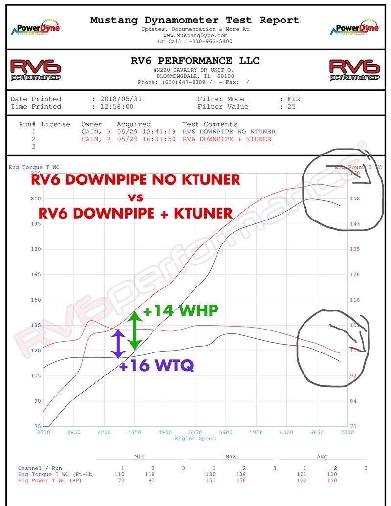

Interesting. We had a ‘14 TSX with the very similar 2.4 in it and they made power past the redline of 7100rpms; same with the last gen K24 Civic Si. It’s just strange to me that one of the last of its kind high rev-ing VTEC engines short shifts well below its indicated redline.
Looking at the dyno of a ‘16-‘18 ILX with a Ktuner on mild bolt-one, it really increases the power in the upper rpms.
https://ktuner.com/16ilx/
My original question though.....is there an option for buying a Ktuner for a 2019-20 as only ‘16-‘18 is listed. I’m not aware of any mechanical changes for model year 19/20.
Old Oct 19, 2020 | 02:35 AM
Uhh, in the graph you provided....power is falling after 6600RPm

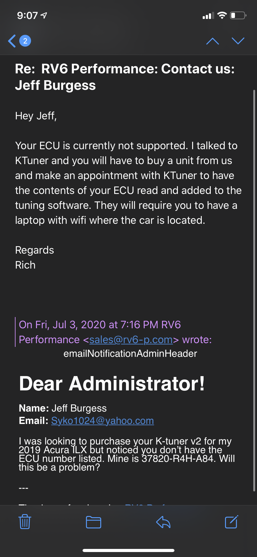

I reached out to RV6 performance as I have just purchased their PCD downpour for my 2019 ILX and this is what they told me. Hope it helps.
Old Oct 24, 2020 | 08:11 PM
Chris Cifuentes's Avatar
Joined: Jun 2020
Posts: 11
Likes: 6
I reached out to RV6 performance as I have just purchased their PCD downpipe for my 2019 ILX and this is what they told me. Hope it helps.

Thanks for the info! I'll get around to it eventually, probably around the first of the year when we'll have some more miles on the car and I feel it will be fully broken in.
