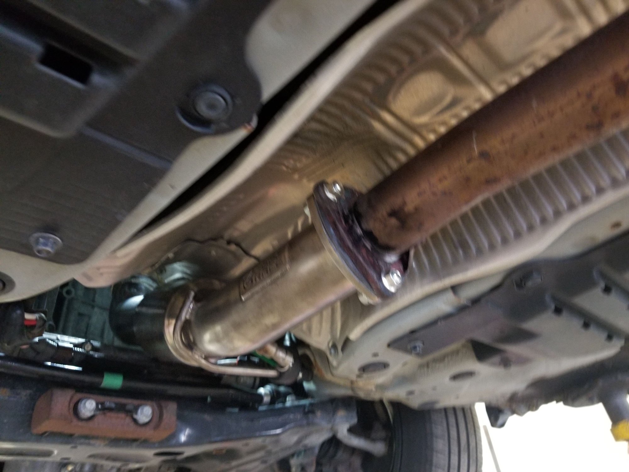

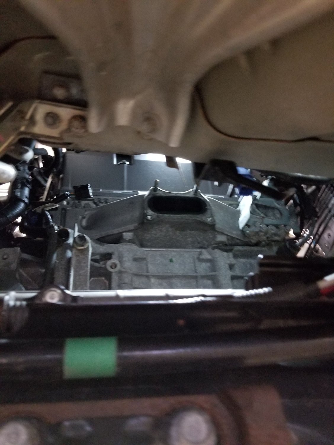

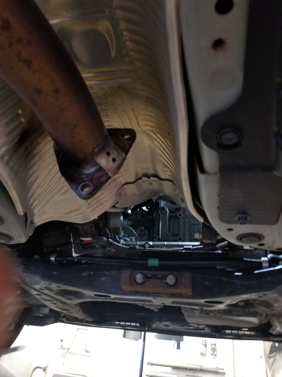

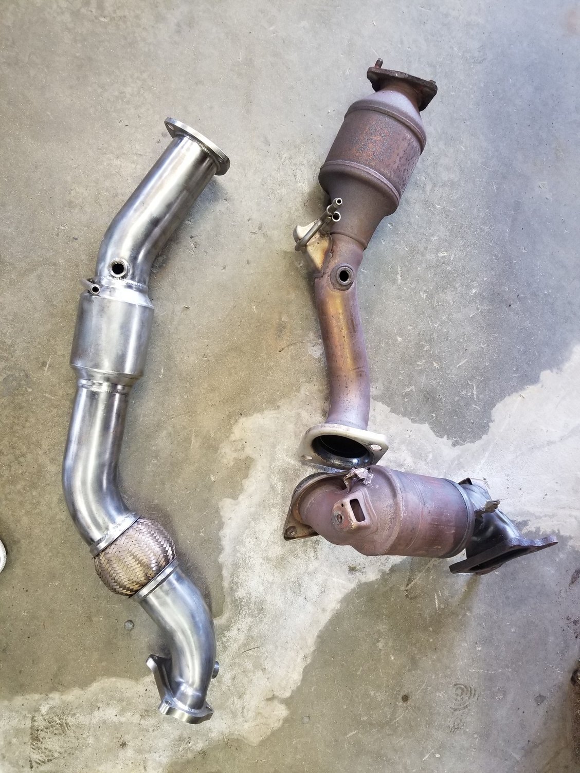

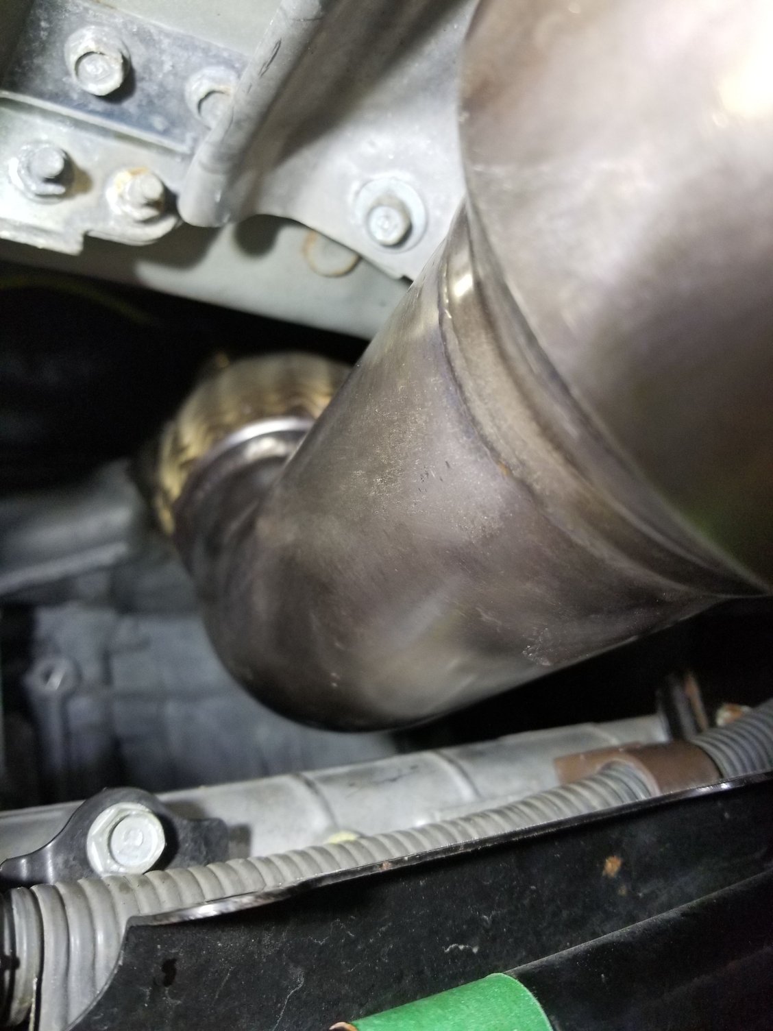

Its the same. I went with the Full Race 3" catted downpipe. You will need a rear motor mount from Hasport or else it will bang up. There is very little clearance.
Old Oct 28, 2019 | 08:42 AM

Thanks for the heads up and I appreciate the posts. The pictures give me an idea of what it looks down under.
