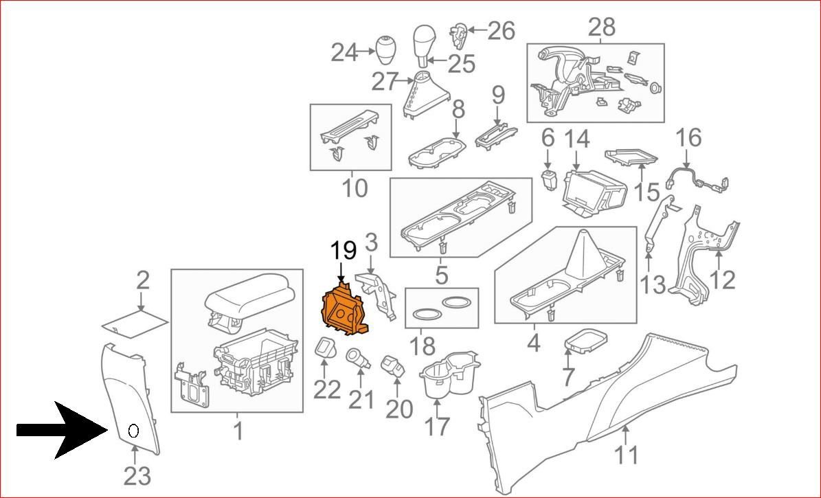

having 2 teenage kids that are constantly on their phones, i was looking to add a USB connector at the rear of the center console armrest , see attached diagram with arrow and switch i want to add, the question is before i take anything apart, has anyone taken apart the armrest and know how much space there is actually behind the panel i want to add the switch to?
i will be doing this project this weekend and will find out for myself, but just wanted to know what i am up against beforehand

Well wrapped up the project this weekend, one glitch which i will get into later.....panel came off pretty easy....used a flat head screwdriver to pop off the panel...unfortunately things in the way at the upper end had to place switch down low, still looks good, i tapped into the sunroof fuse with a fuse tap, and installed it correctly but the usb stays hot even after i turn the car off...will investigate more and try out other non essential fuses when i have more time or just place a on/off switch somewhere in between the fuse and the usb
