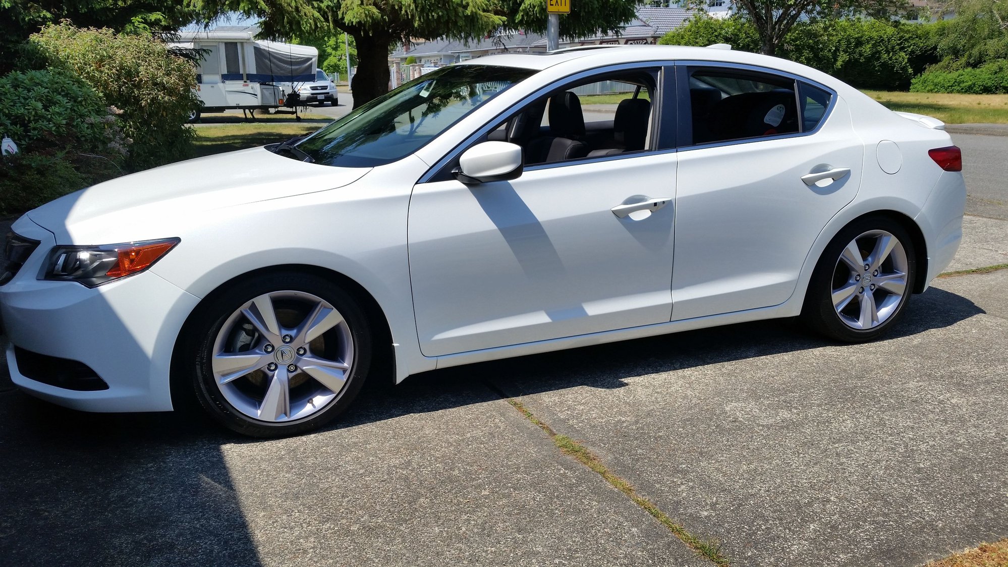

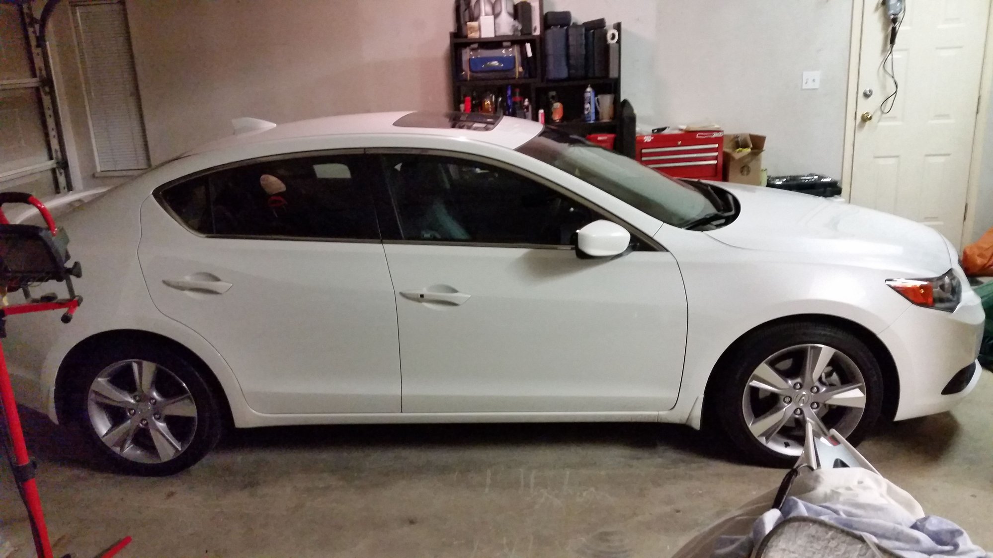

Before the springs, yes right before we did the install (sorry for the bad picture quality = low lighting in the garage).

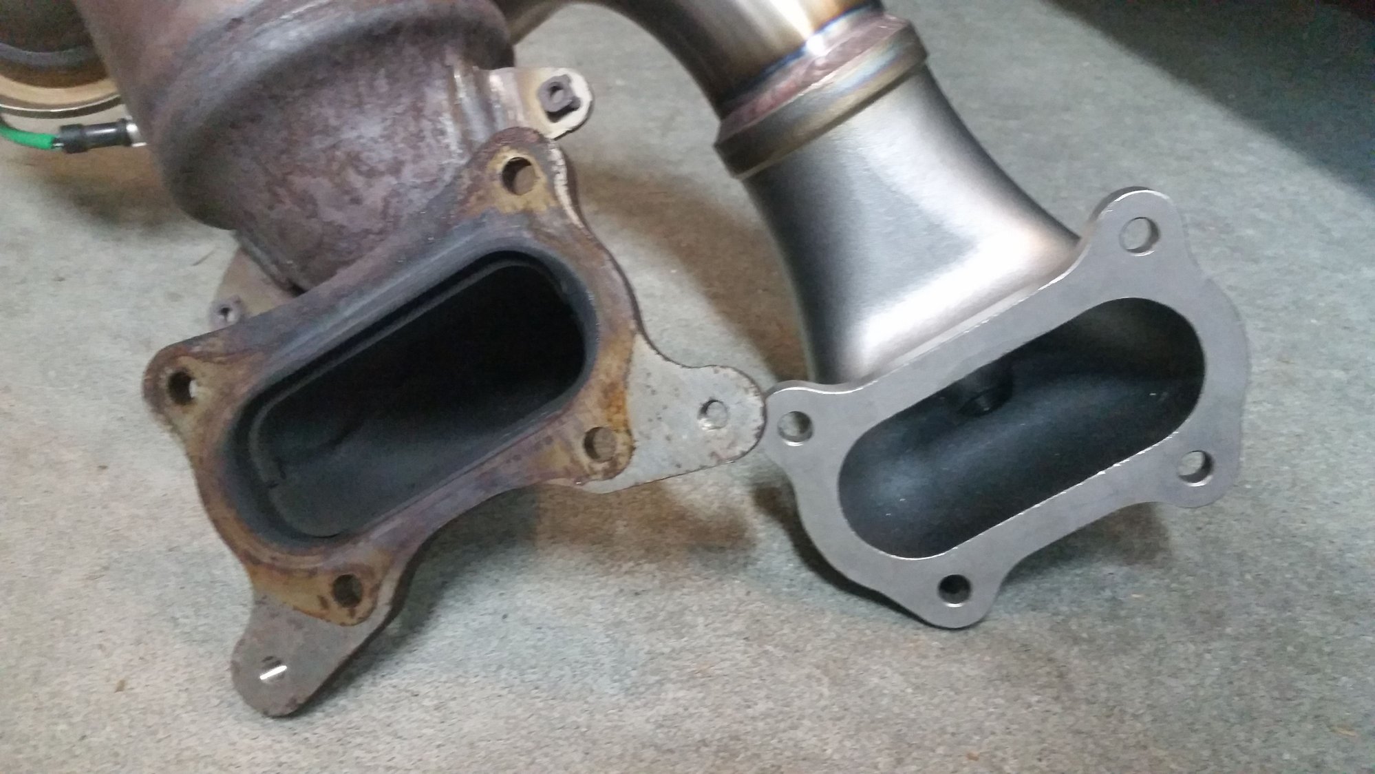

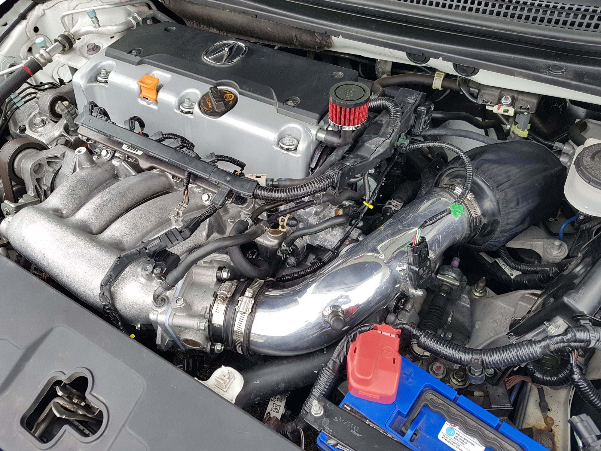

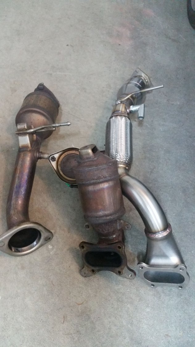

Out with the old and in with the new.... Injen CAI and RV6 Stainless Steel Downpipe (with high flow cat).

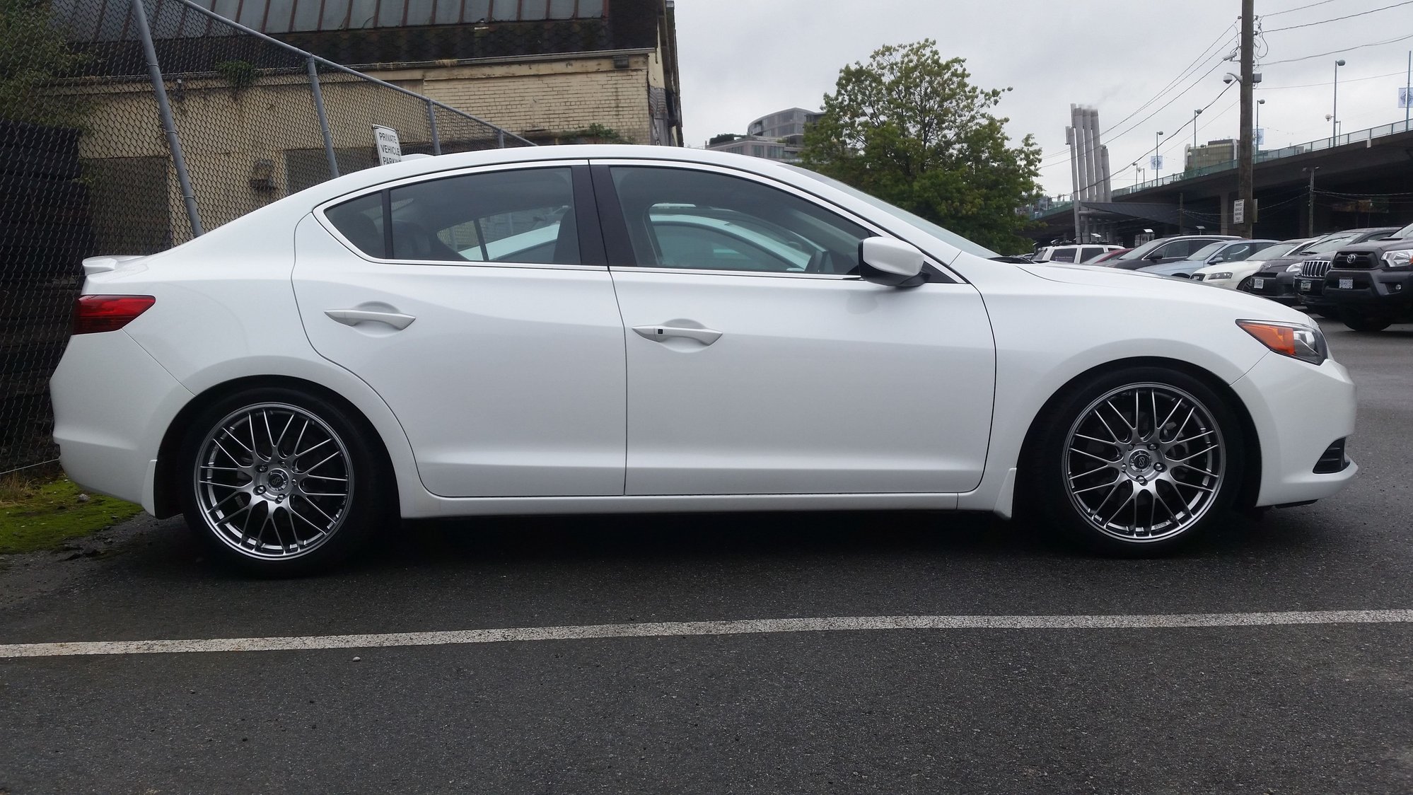

Next Hondata Pro... And Rims/Tires
Enkei silver EMK3 18"
Continental DWS 06 - 225 40R18
Of course I ended up pushing out the rims later with 25mm spacers front and rear.

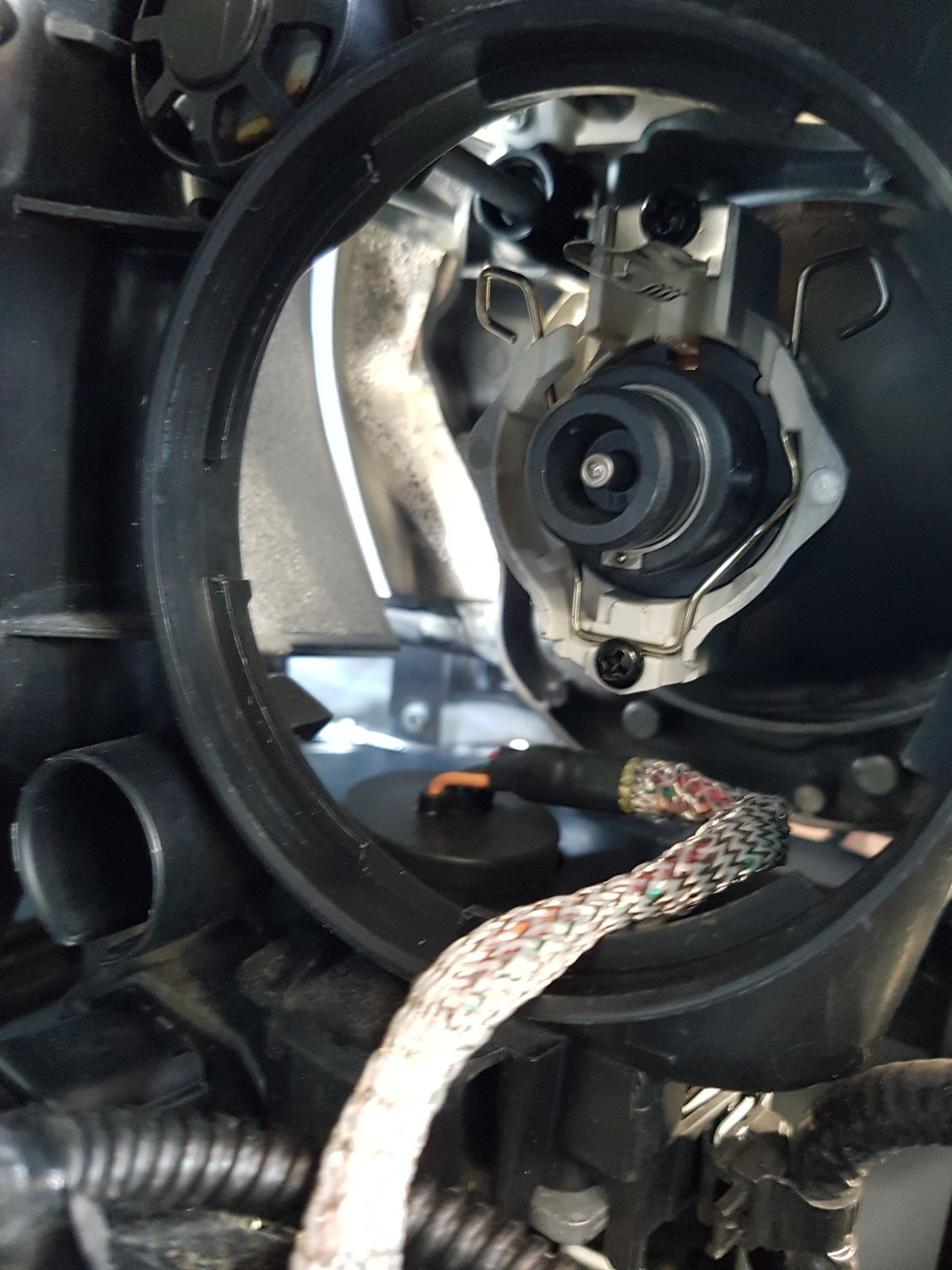

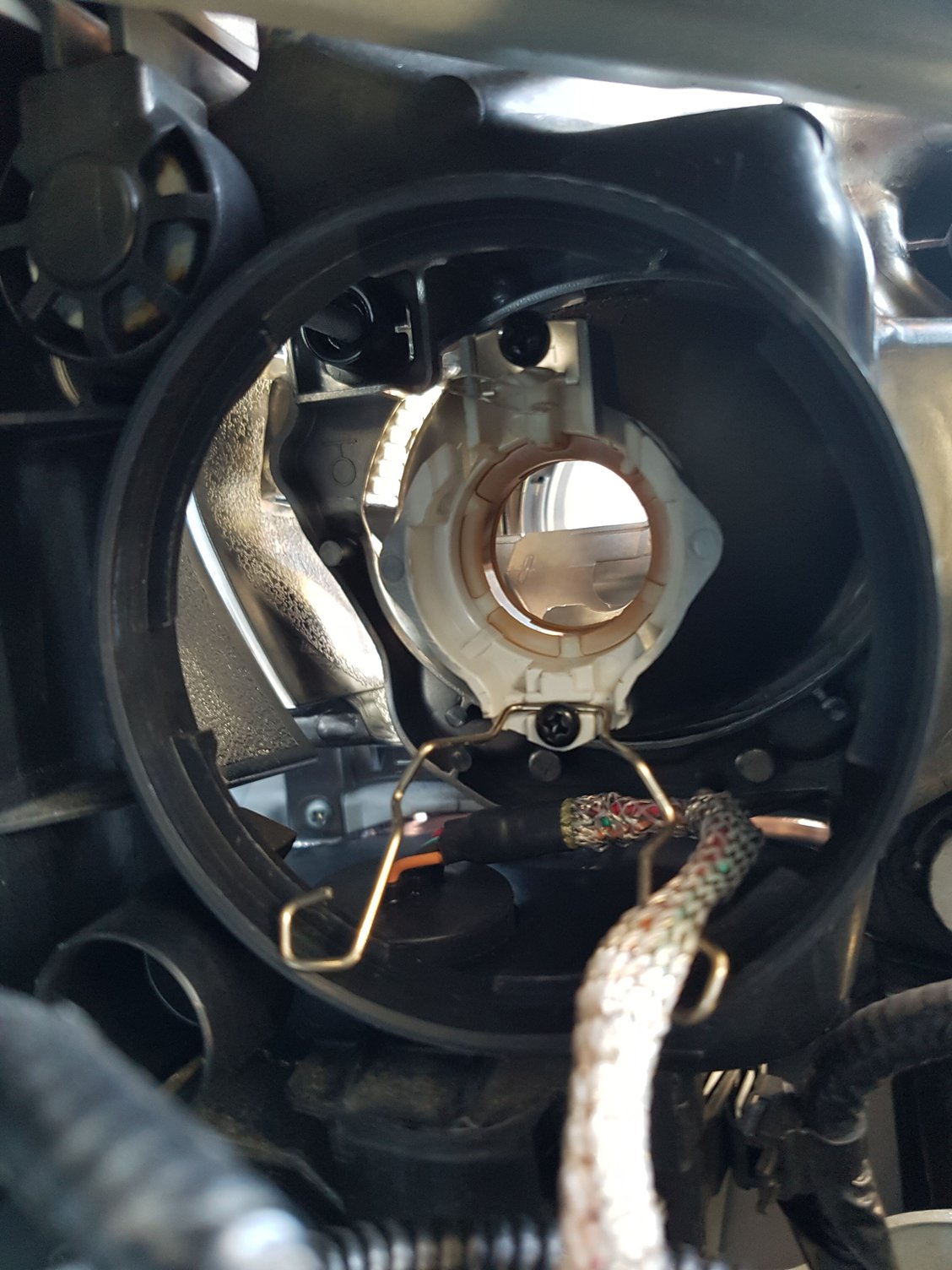

You may have noticed I cracked open the headlight assembly and took out the ugly orange plastic, I did however epoxy the orange reflector to keep the vehicle compliant. I really hated the orange reflectors inside the headlights - It made the vehicle look dated (IMO).

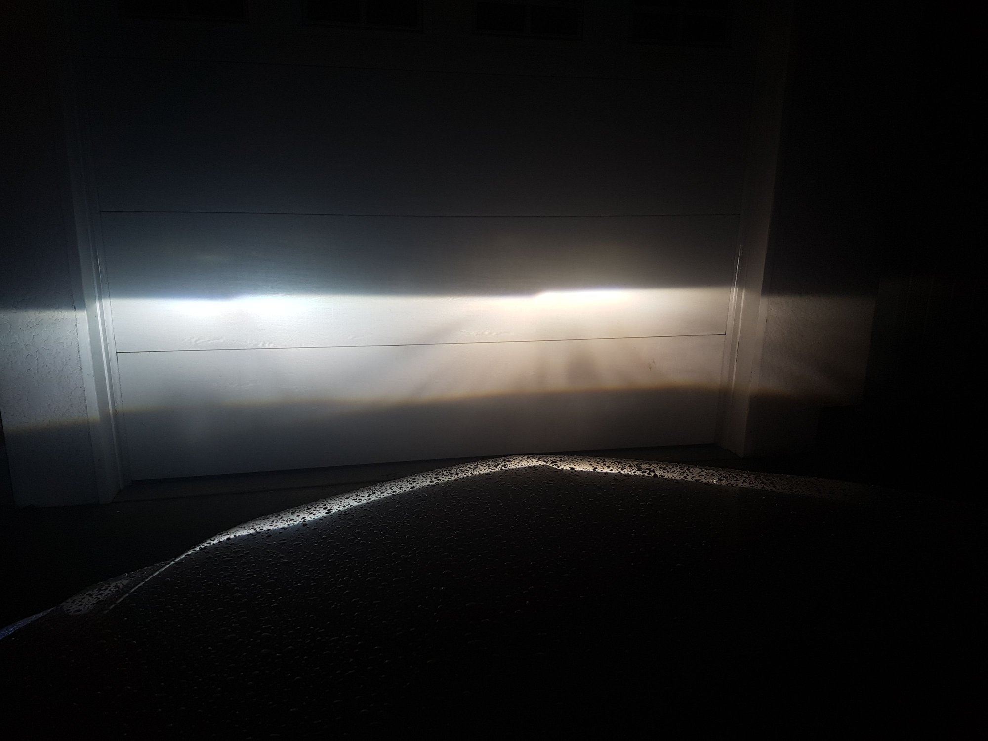

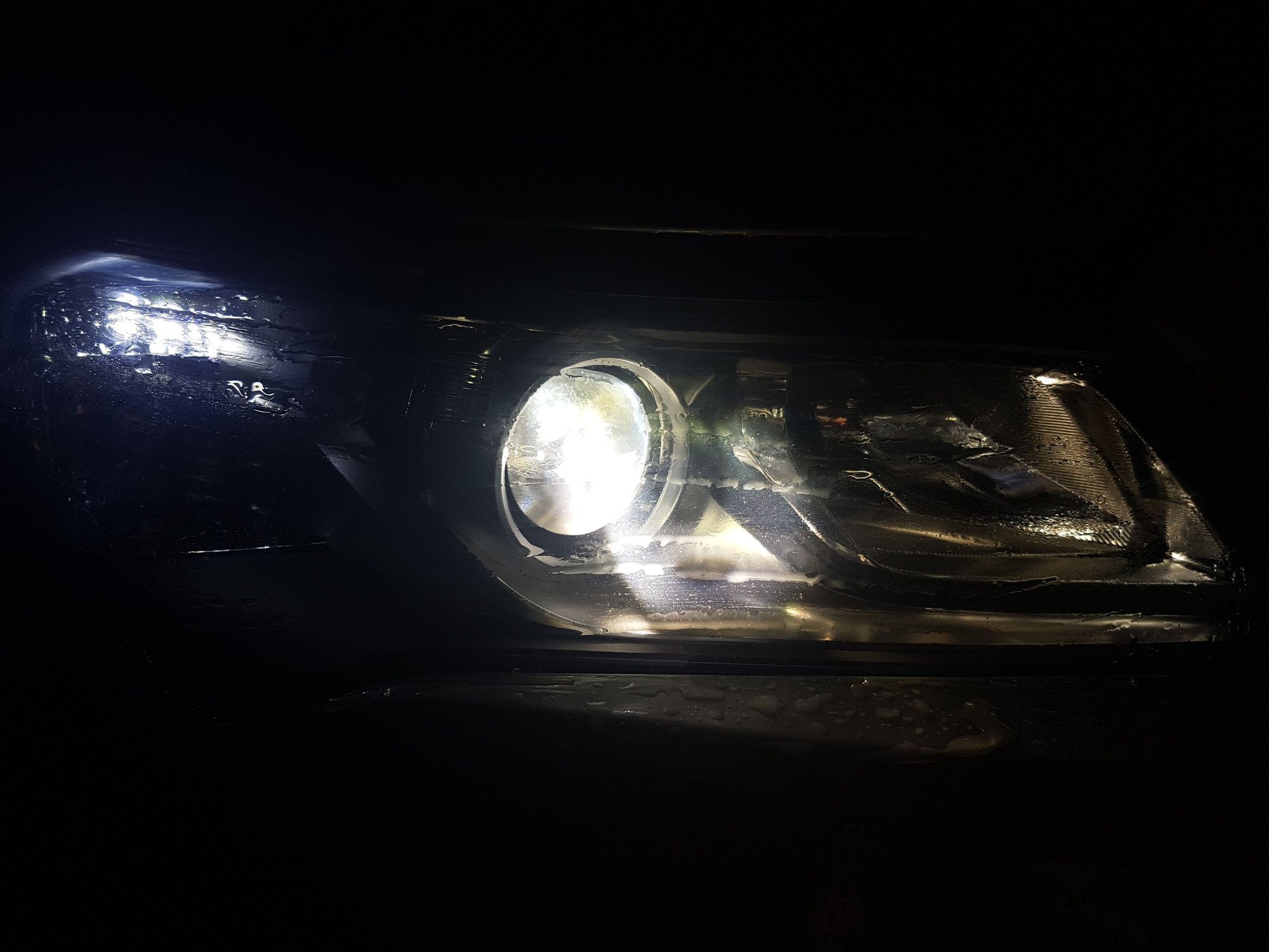

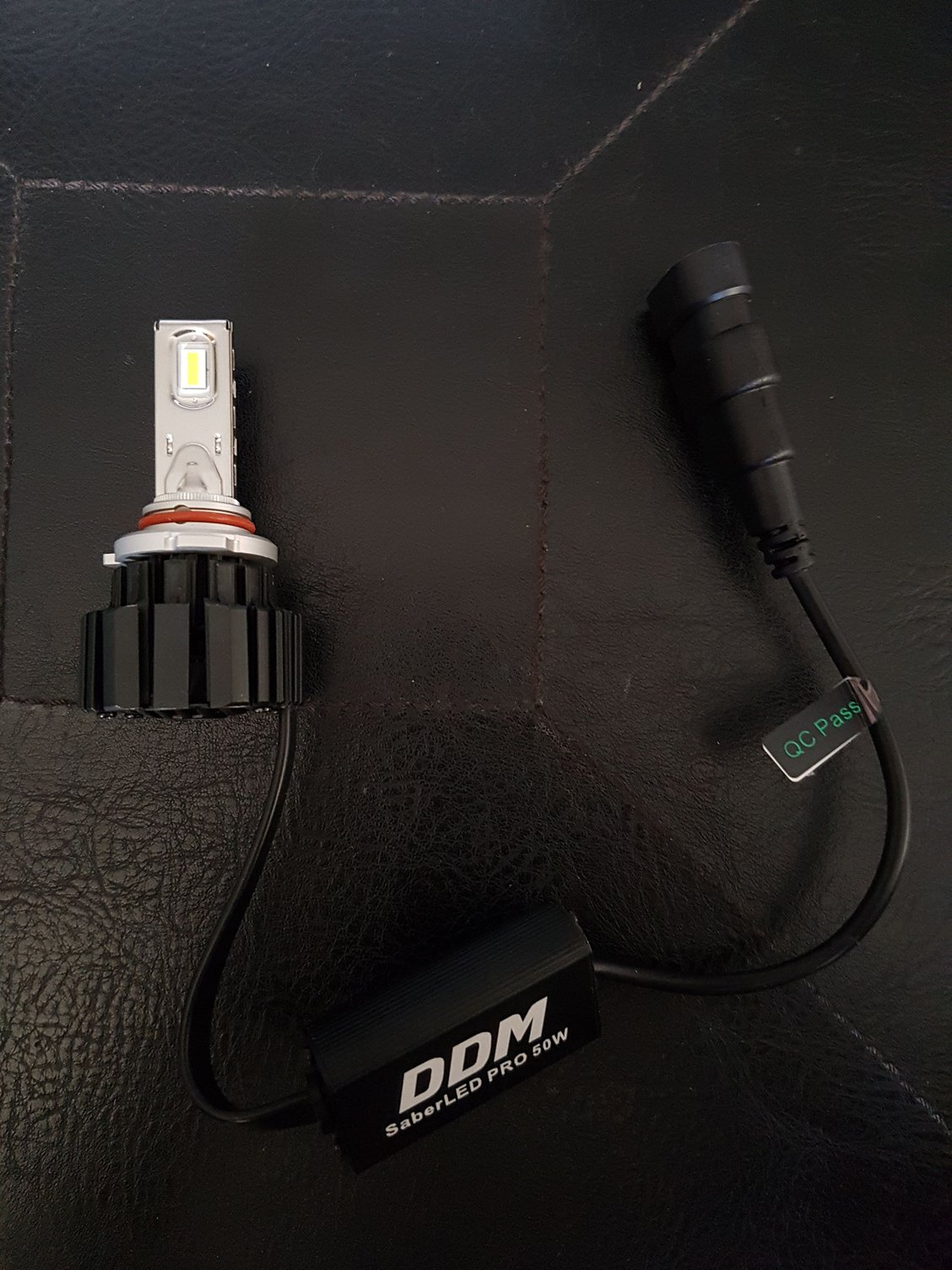

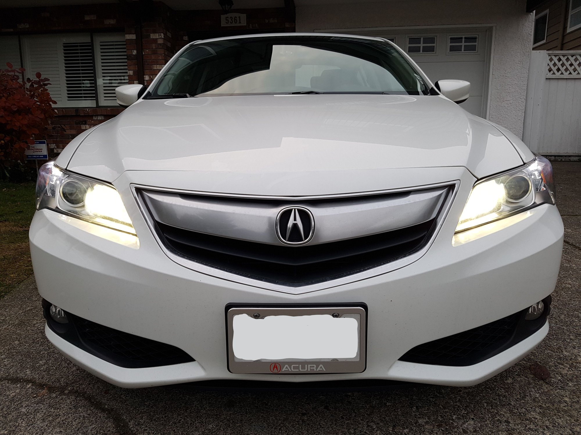

Lights up front!!! Changed the stock fog lights to white HID (Aftermarket kit for H11's).

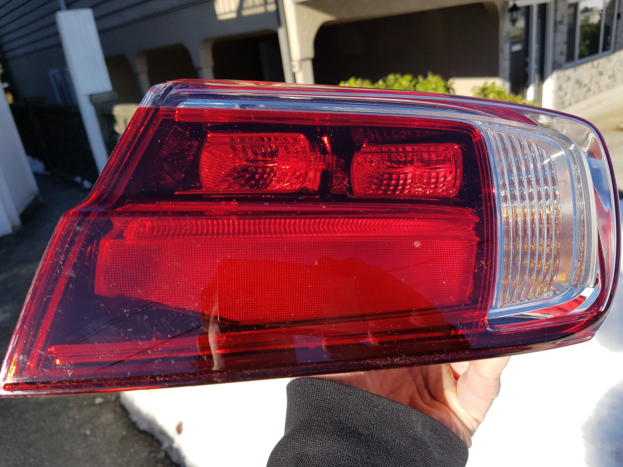

Lights in the back....After lots of going back and forth on this one I finally bucked up and spent the cash.... Converted the rear tail lights from 1st gen to second gen.
I later changed the front and rear corner markers to amber LED's. Also changed the fog light bulbs to 3000K ambers (not as nice as some of the aftermarket LED projector fog light kits - But mine only cost me $60).
I have also upgraded the rear subwoofer to a Kicker Comp 8" 2 ohm speaker. It does sound better however the frequency is still crossed over at the stock amp = You will not really hear too much lower frequencies.

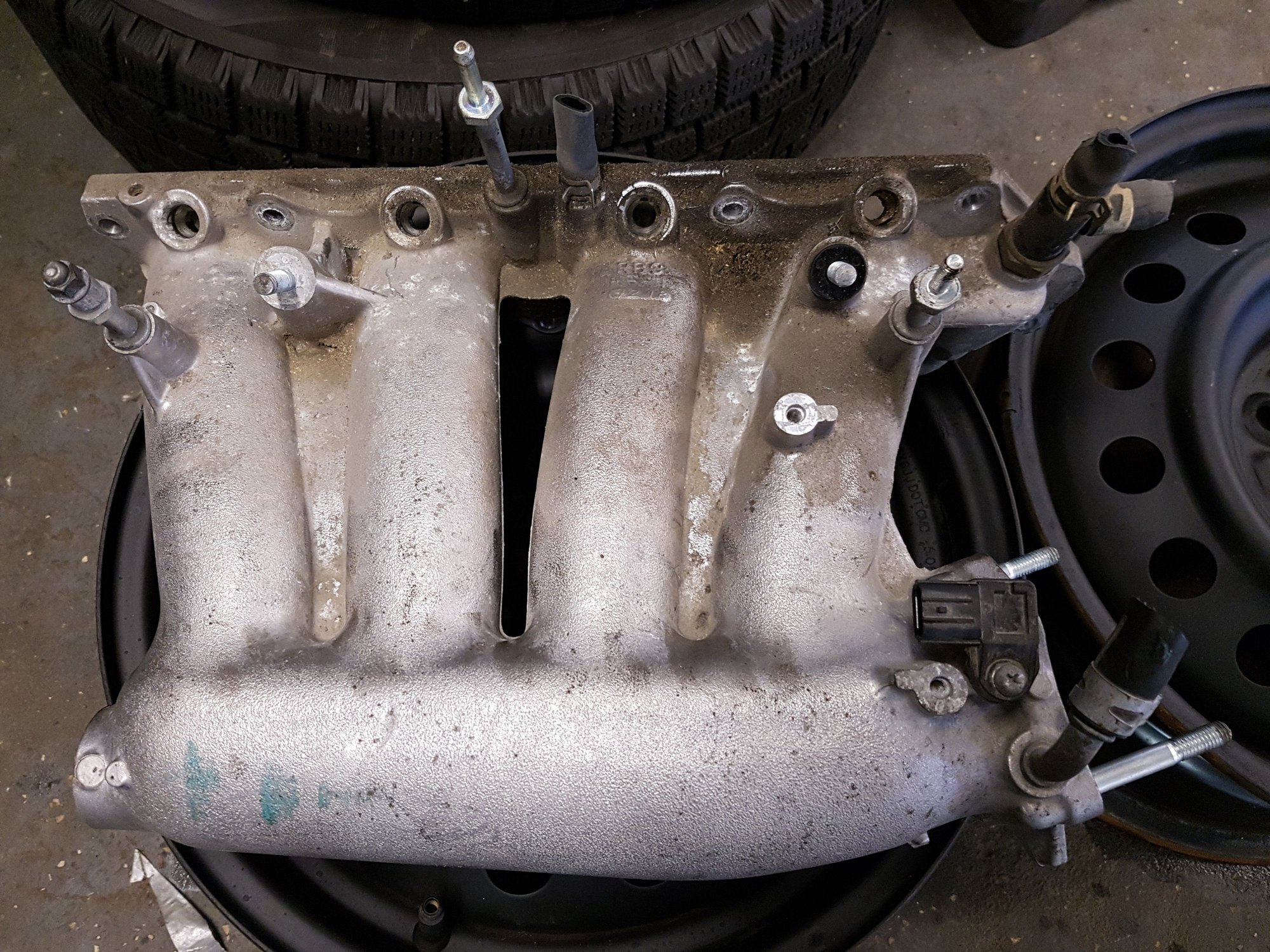

Civic SI - RBC Intake manifold. Picked this up used for $125 CAD. Contrary to its appearance above it is in good condition and I have since cleaned it up. I used to have a 2008 Honda Civic SI and totally miss that VTEC punch growl, I am hoping this will bring back that sweeet sound!

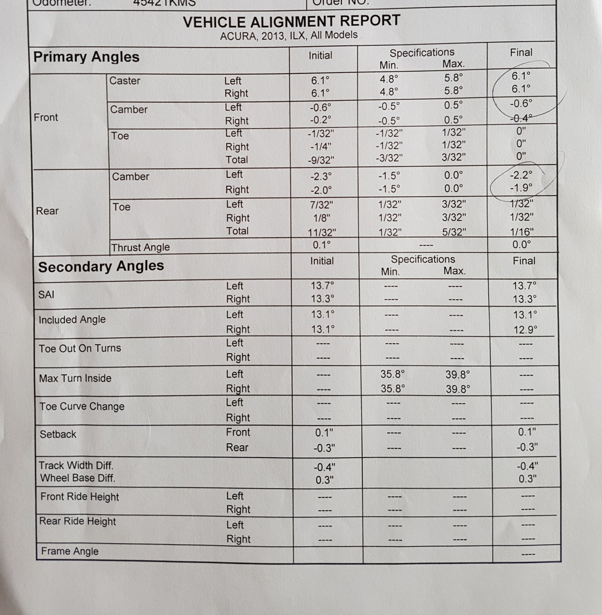

How was the camber after the drop? Did you need to adjust them?

Hello itsdannylam,
I did take my vehicle in for alignment shortly after the springs were installed. Based on my the springs and my tires/rims, the camber is off by 1 degree or less from Acura ILX manufacture specifications (see below). Essentially was not really worth the $$$ in making further adjustments - The tires will wear slightly more but not really noticeable.

Great to know. Thanks!

How straight forward was the tail light install? Did electrical match up?
Old Jun 8, 2017 | 01:30 AM
Chrifff's Avatar
Joined: Apr 2016
Posts: 258
Likes: 94
From: BC
Hey Jon,
The side taillights are plug and play (exact fit) - These will take literally 10-15 mins tops to replace. The tricky part is the trunk lid ones, this requires two things:
1) Removal of a couple screws in the trunk lid and pulling apart a portion of the sticky adhesive to remove the lid and extract the original 1st gen taillights.
2) The brake lights are plug and play however you do need to run a set of wires to power the LED lights (this is not necessary for the side/outer lights). I spliced the power needed from the license plate lights.
I am debating on running a separate thread on a "How To" for this mod, if there is enough interest that is....?

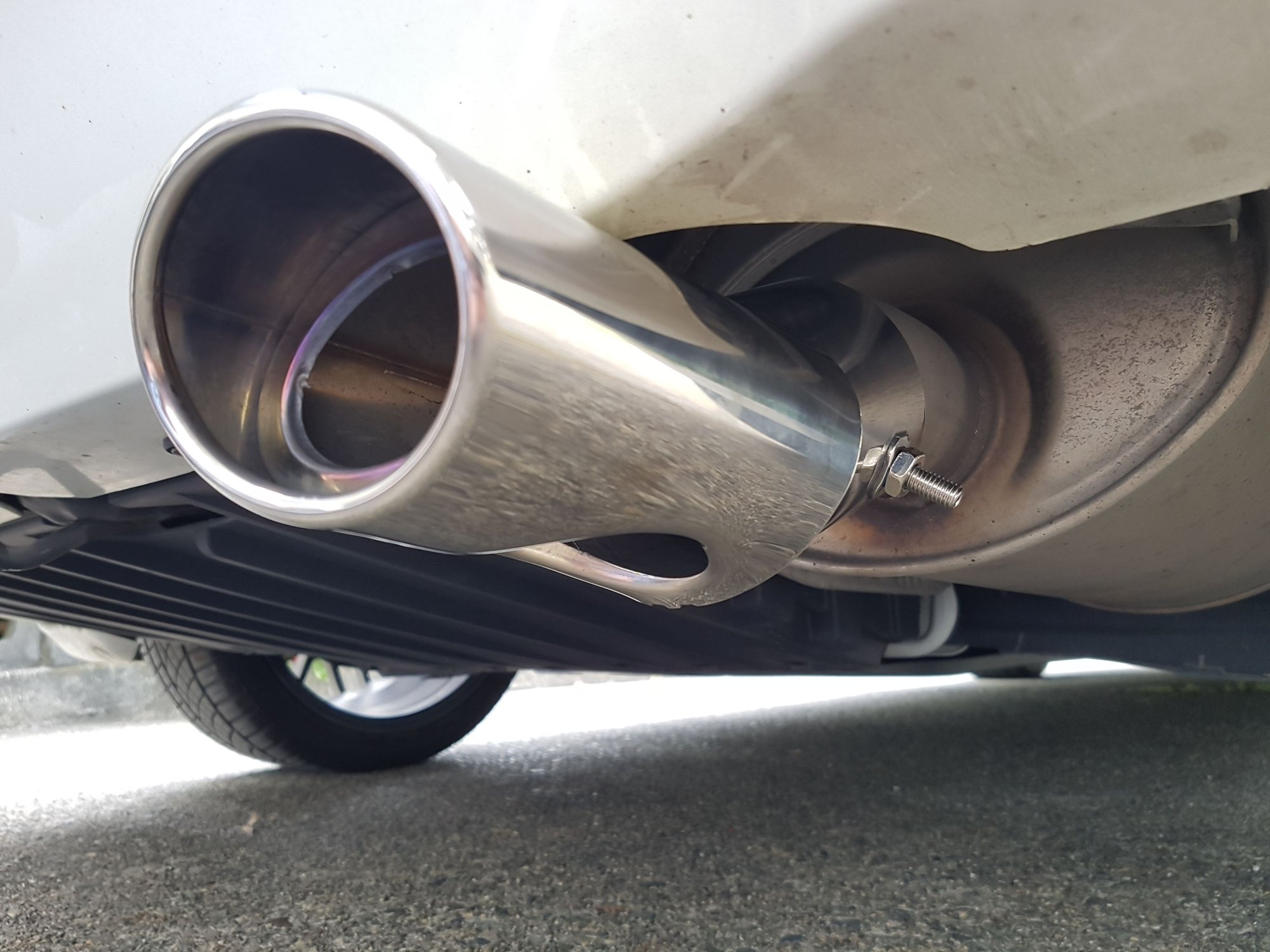

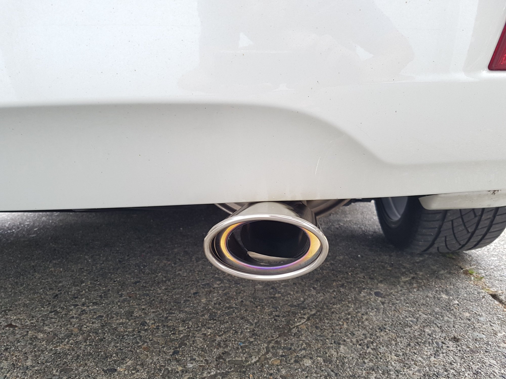

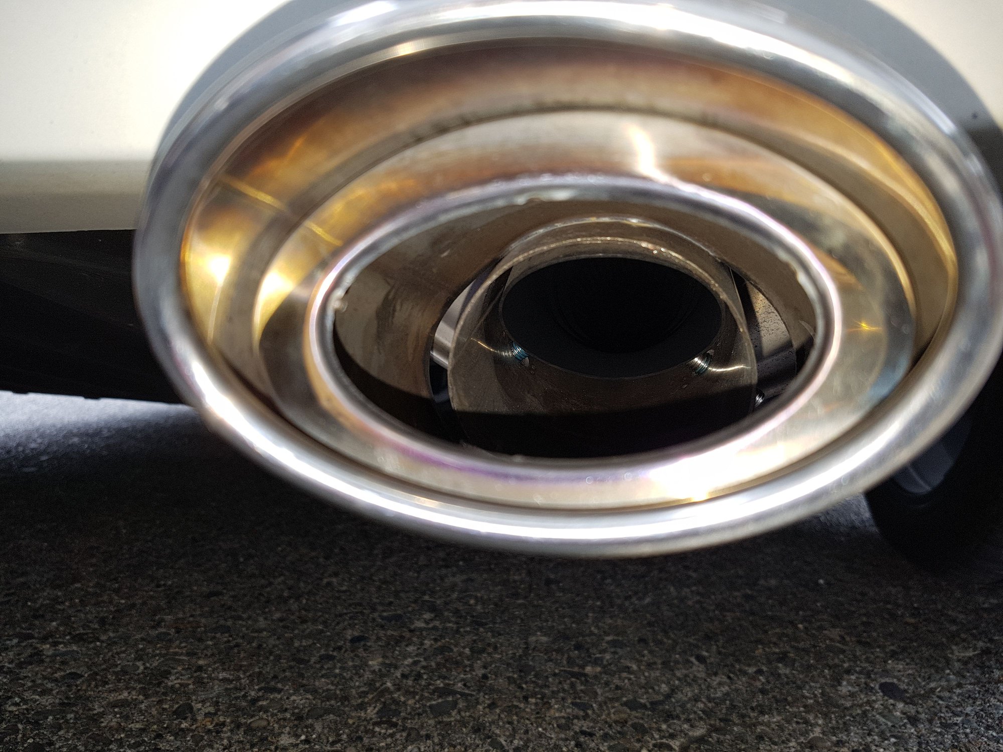

Ok, so I finally got around to installing the next performance mod
Ahhhh-Yeah!!! And this one is good for a whopping zero HP increase.....
This is just a cheap bolt on exhaust tip that has a bend in the pipe. The hole on the bottom is actually where the exhaust exits the finisher.
I had noticed someone else try this and I figured why not, it is fairly cheap.
Truth be told, I am still debating on cutting away a portion of the bumper to put a proper tip on, but this will have to do until then.

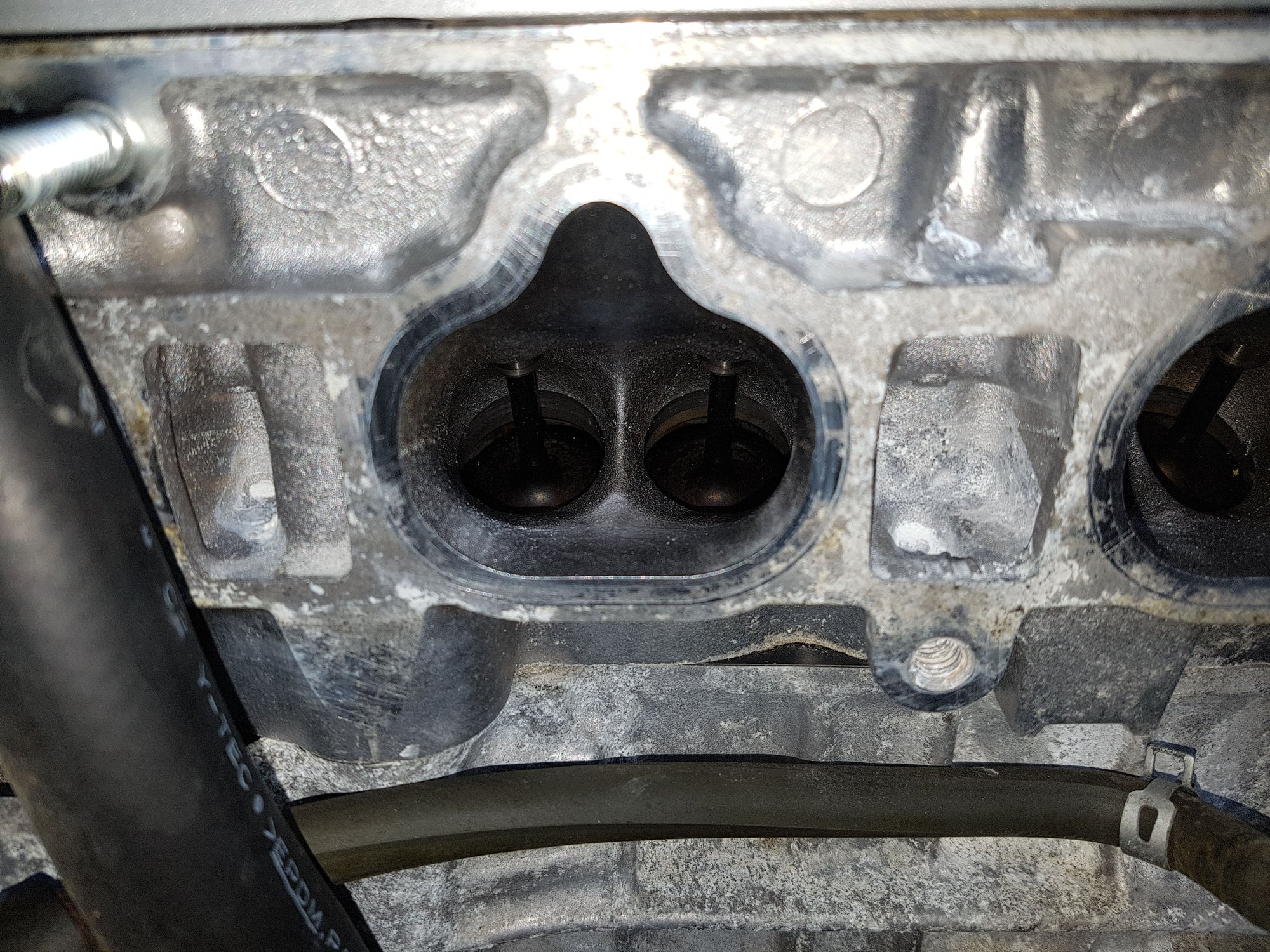

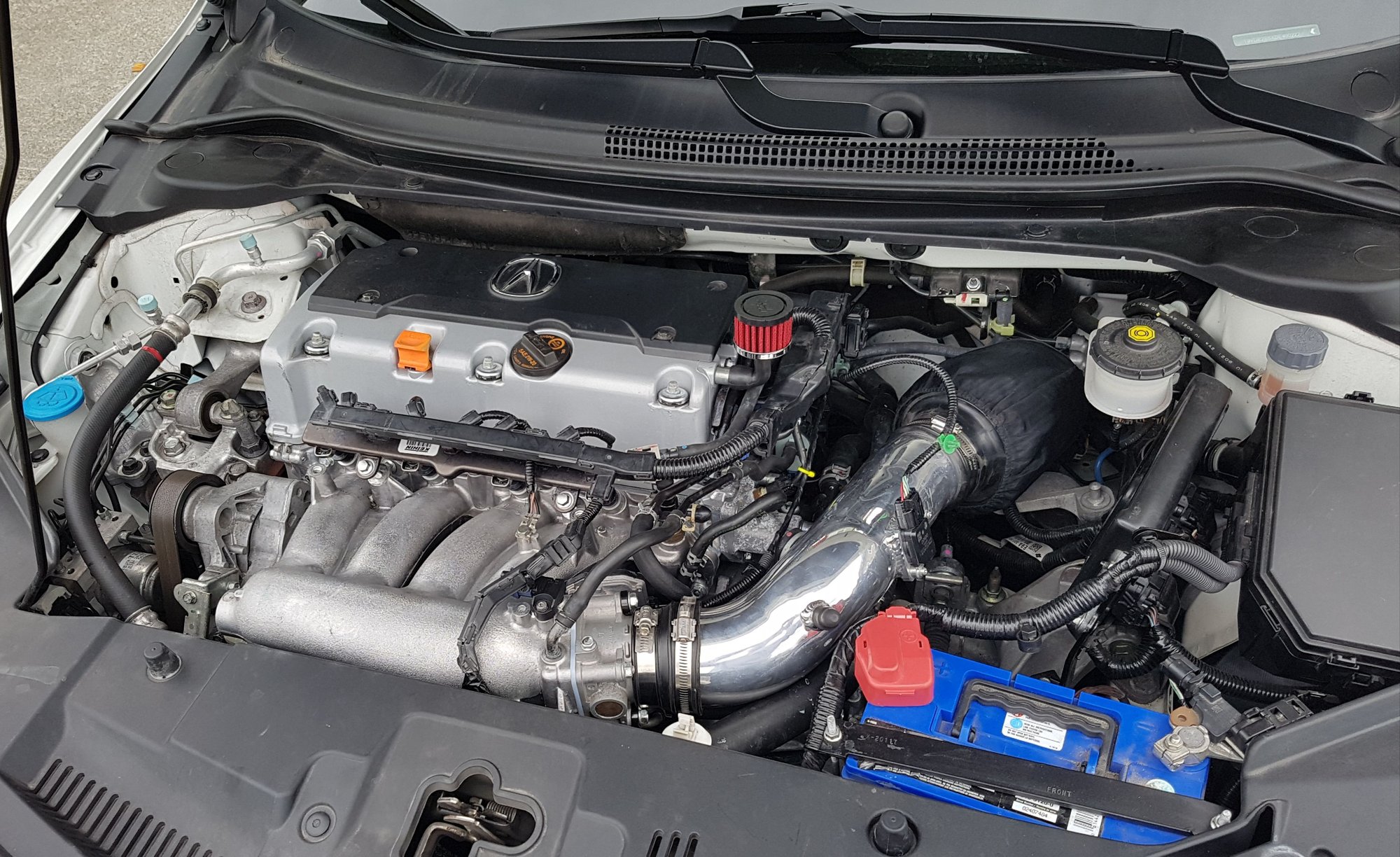

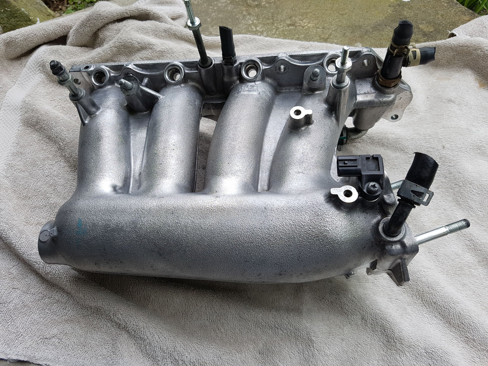

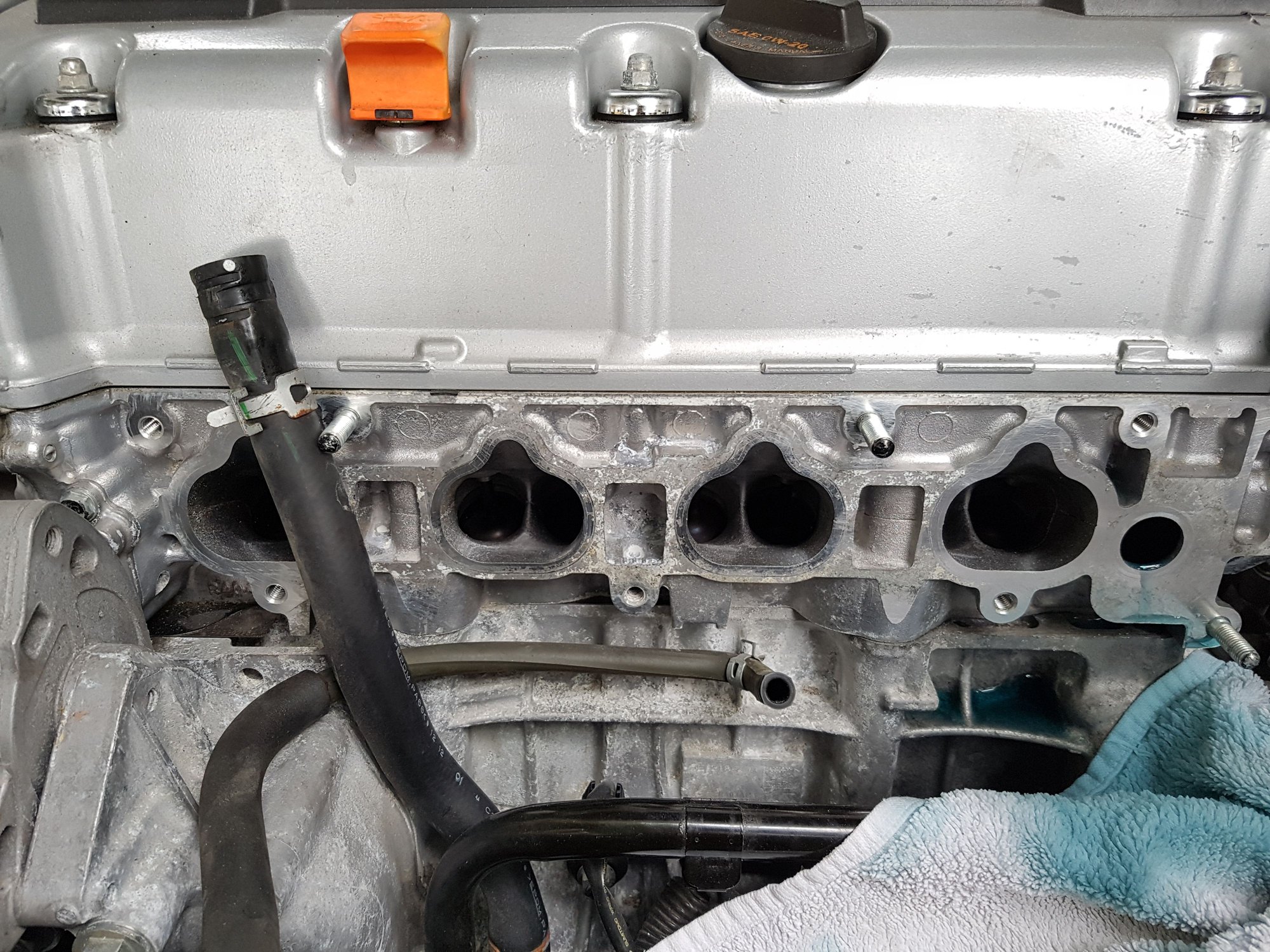

Ok... Ok... I know, the exhaust tip was just a teaser. My actual next mod was the RBC intake manifold, and this one should be good for a few extra ponies!!!
This took a bit longer to do than expected and was not quite an exact match.
I did pick up the conversion gaskets and fuel injector spacers.

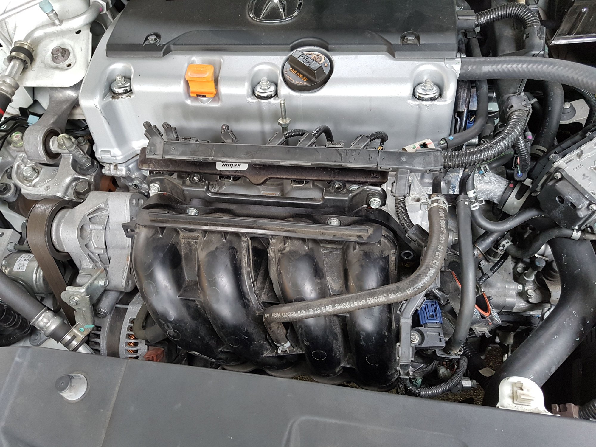

This is the old stock two piece intake manifold.
The black plastic piece has a resonator built inside, partly the reason for air restriction.

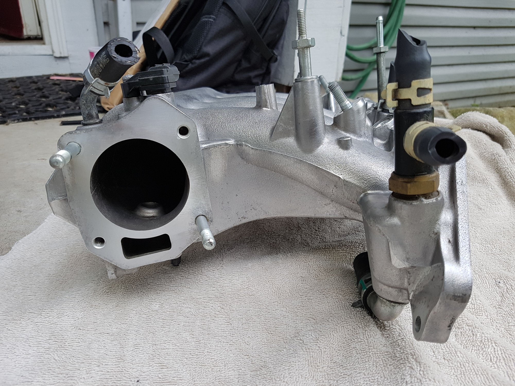

Ahhhh, finally after some coolant spilln' the space is now available for the RBC.
Close up of the valves.

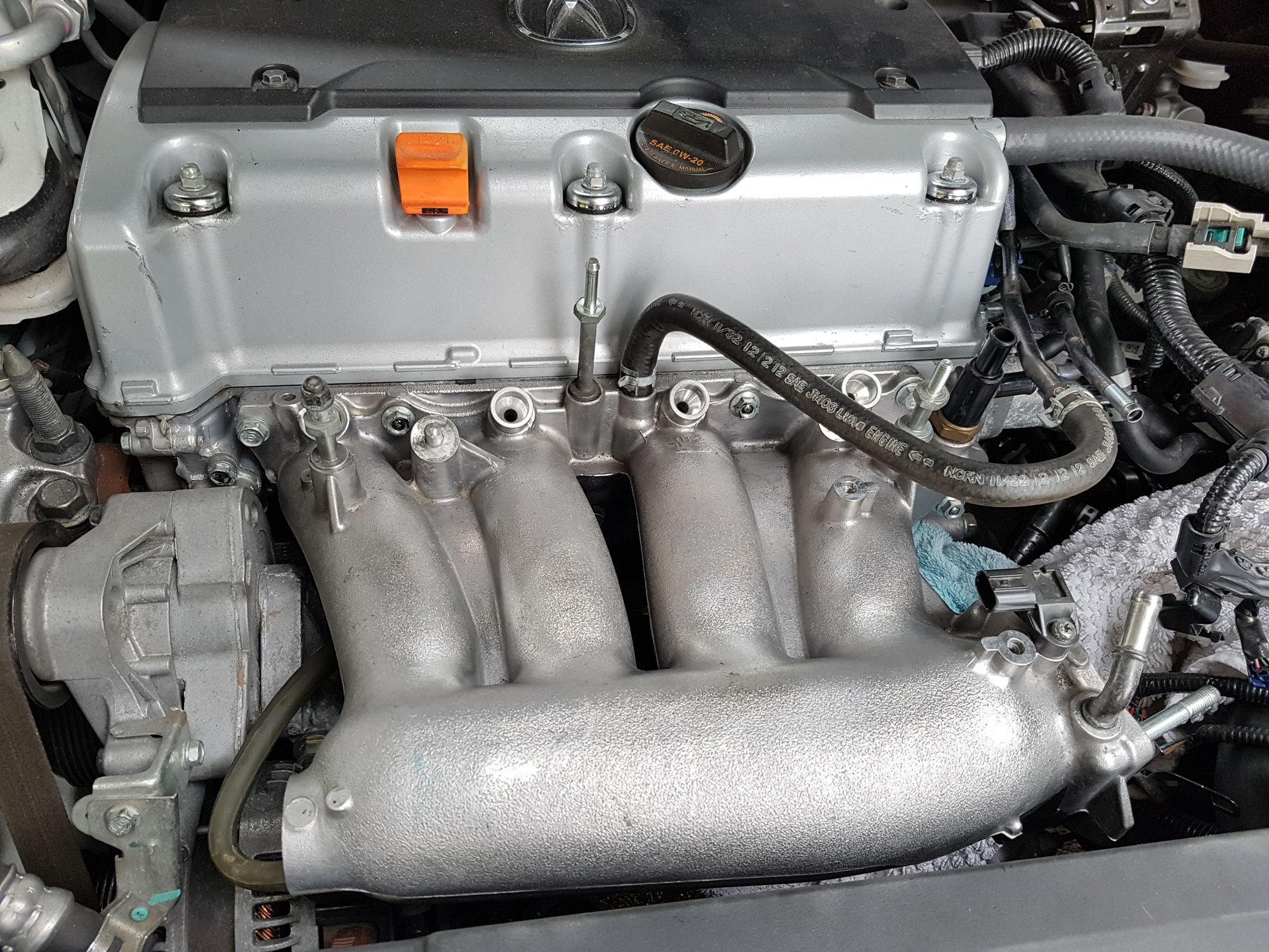

Fits like a glove! Shot wit the fuel injector spacers.
Phew, finally all done. Close fit, but she is in there! Looks much more premium over the cheapo plastic (IMO).Sorry the engine/area looks dirty, I did not get the chance to clean things up.
Also, my CAI had to be moved, making it more of a short ram intake as the throttle body of the RBC is in a different location. I may keep it this way, unless I figure a better way to route it.

Thanks for the inquiry and comments....
The tail pipe finisher will burn/melt a portion of the bumper if you leave it touching like I did, make sure it does not touch, it only lightly singed the lower underside of mine, I thought that because only a portion of it was actually touching the car exhaust I would be fine - But no, I only drove if for a short while like 20 mins and I noticed it later. I moved it out a bit further and it appears to be fine ( a few mm should be fine, as long as it isn't touching). This thing is only attached by two screws that are tightened by a supplied allen key/hex key. I used lock tight along with lock washers and so far no rattles or shakes!
Personally I feel that if it burned the inner bumper to much or fell off I would just cut away the bumper and put in a proper finisher, however so far so good.
Here is the link (I think this is the one I used - make sure it is the one that fits the CRV - the exhaust is larger than some other ones):

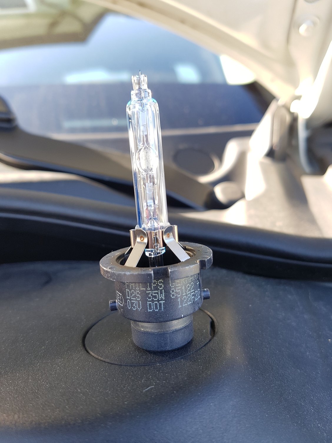

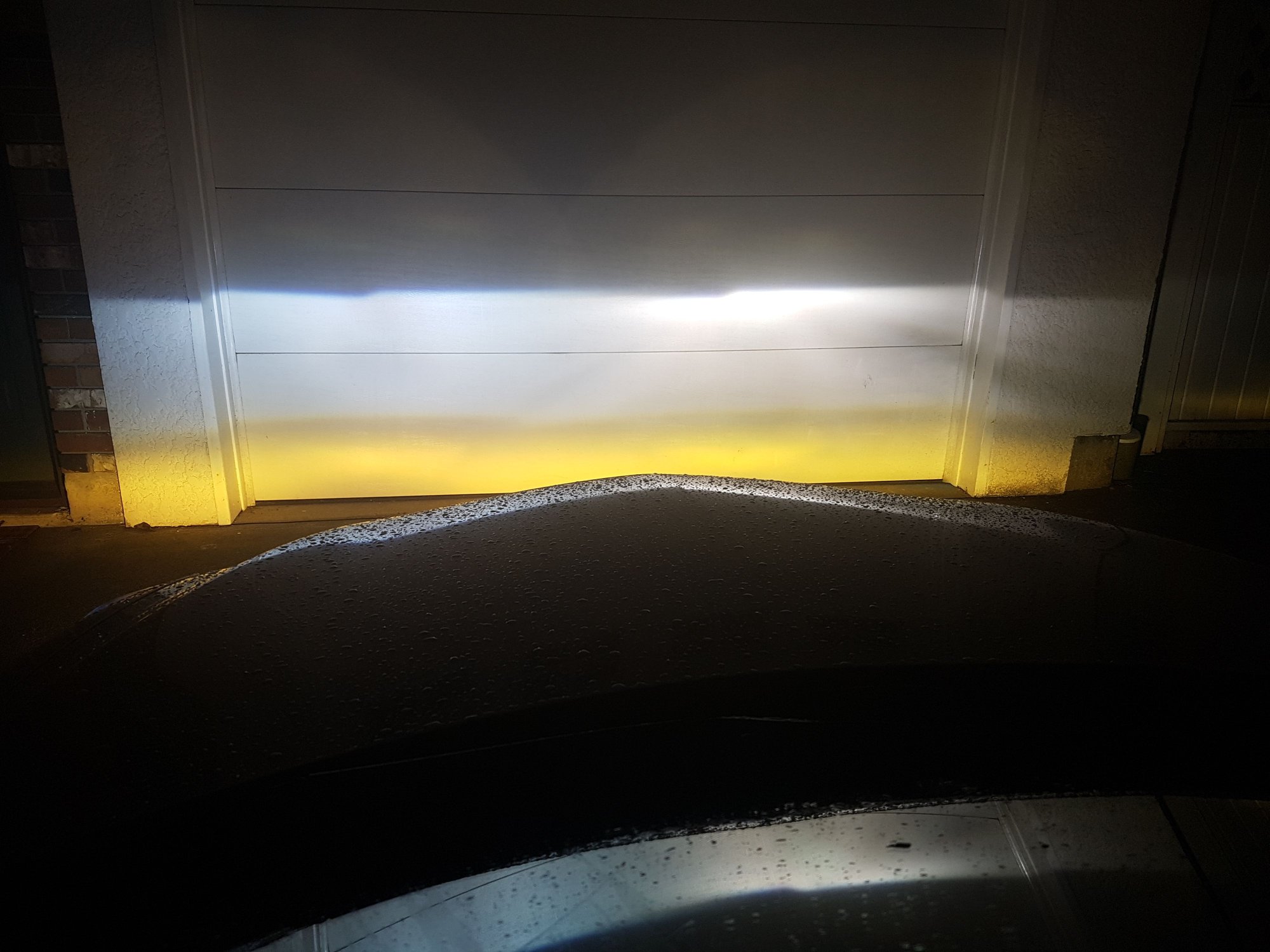

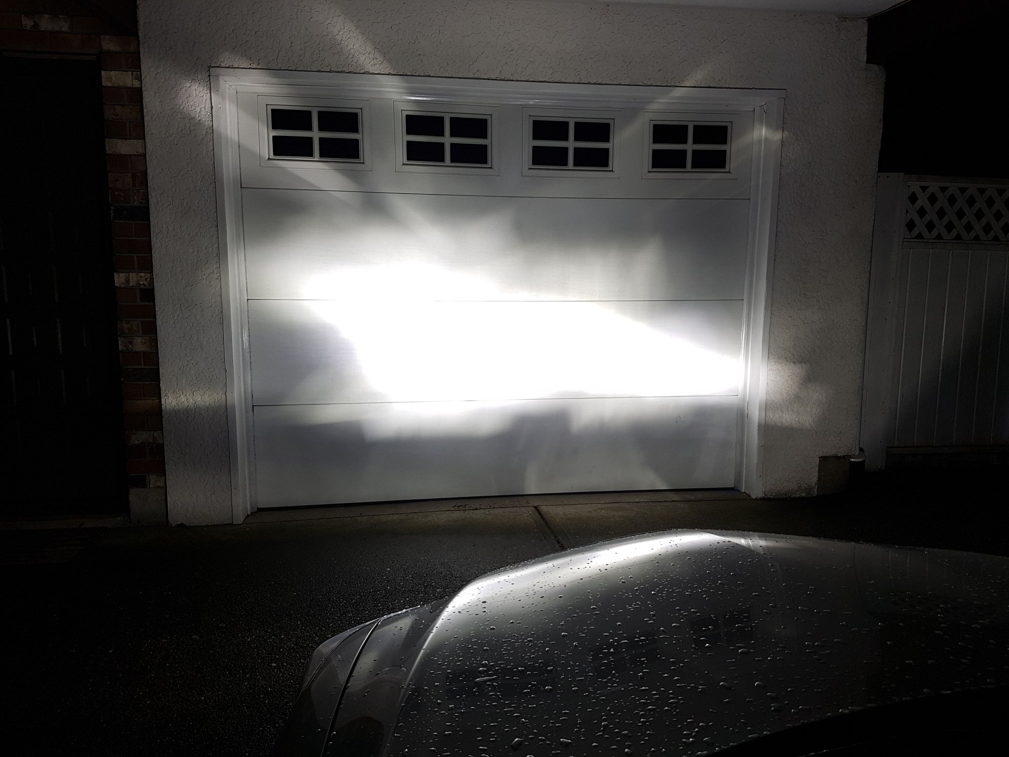

Ok firstly, I must say I am sorry it has been a while since I have posted any updates = I have done a couple minor additions but have never got around to posting it... So here goes:
I have been wanting to address the headlights for a while, yes they come stock with HID bulbs however the color temp at 4300 kelvin is a little too yellow for my liking (and yes I know 4300 K is a bit better for illumination, but I wanted a different color temp).
It is pretty easy to access the bulbs, although it is better if you have smaller hands (haha)

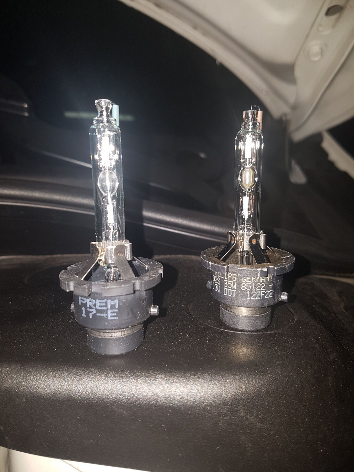

The stock bulb is a standard Philips DS2 35 Watt
Stock Bulb on the right; aftermarket 35 Watt DS2 5500 K color temp on the left (Looks like it will fit.... Hmmmm, lets see...)!
Alas, it fits!!! Again stock on the right at 4300 K and aftermarket 5500 K on the left - Definitely a cleaner white hue.
5500 K - Off centre shot 4300 K Off centre shot 4300 K on the left; 5500 K on the right; 3000 K HID conversion to fog lights on the bottom.

Okay so that was the main bulbs but what about the daytime driving lights/high beams (Bulb size: 9005)??? I have been wanting to upgrade them as well and to change them over to LED bulbs however I have been waiting to find something that would show a dramatical difference between highs and lows - Especially if I needed to high beam another driver. FINALLY I have my answer!!!
Nope, not a product plug - I do not work for Saber.
These have a built in fan, but you can't hear them. Yes they fit, and yes it is plug in play. I did not need an additional harness and they worked without any error codes. I have included a picture of them turned on below, however the picture does not do it any justice. Also just in case you were wondering the high beam is very bright with a decent throw distance which can be an issue with some other LED bulbs!
LED bulbs don't really do well in pictures, they look much better than this on.
High beam spill, yes they are very bright - I would say they are definitely brighter than stock. Sorry I did not include a picture of them from the cockpit, but trust me they are bright!
