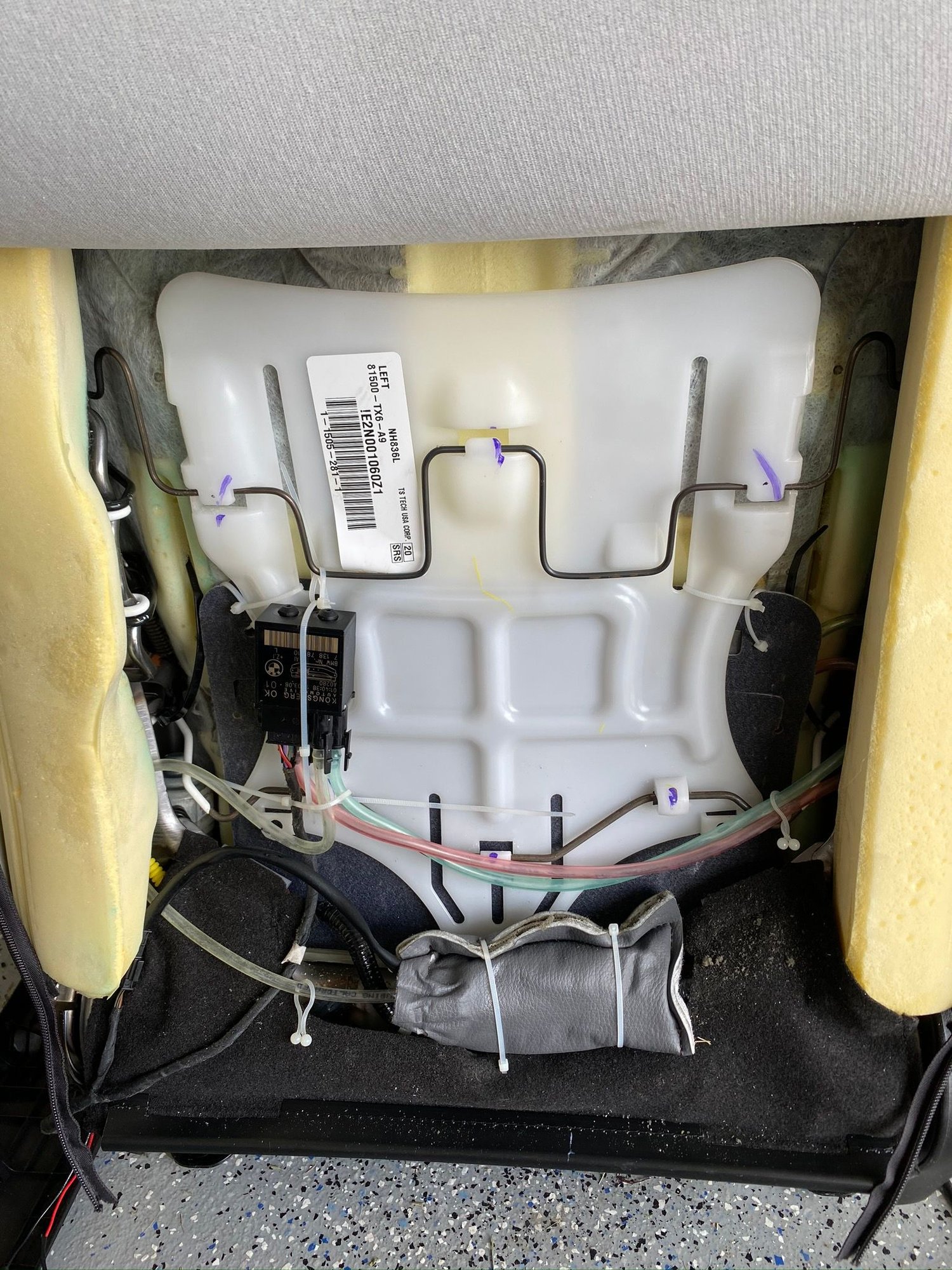

3. Modifying the existing seats. This is obviously the ideal solution but I've tried a few things with no avail. I'm not 100% sure what it is about the factory 2016 seats that are so uncomfortable for me, but part of it is the lumbar area of the seat protrudes so far out that its unnatural for my back. I tried taking out the bar that holds the lower part of the cushion inside of the seat and that helps quite a bit, but then there isn't enough lumbar support and it just makes my back hurt somewhere else. I then added a BMW lumbar support module, but for it to work properly, I had to put the bar back and went back to too much lumbar support. I almost need a way to mount the bar back far enough to keep the the lumber area neutral and allow for the lumbar support module to add support as needed, but I have no idea how to accomplish this as the mount would need to "spring" like the OEM mount does. If I could just find a longer bar that would hold the lumber back farther or a cushion that doesnt have the same amount of lumbar support that might work, but I have no idea how to tell which seats parts are different than the factory ILX seats.
I thought about picking up a 9th gen SI seat and taking both seats apart and figuring out what the main difference is. Maybe its the back cushion? Maybe its the seat back frame geometry? Or something else. But If I could modify the seat then that seems like the best way to avoid my main concerns of airbag / missing module codes.

Below are some pictures to show the "bar" that Im talking about and what I have tried with the BMW lumber support module.
