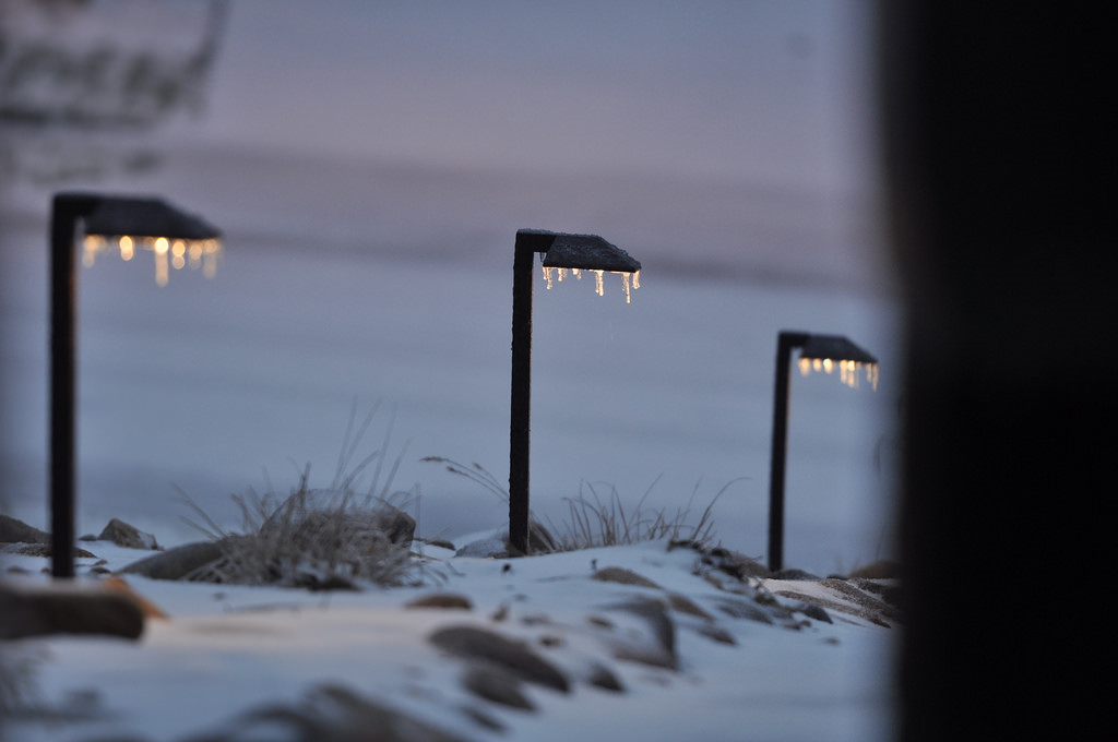

These are made by Malibu, but there are some just like them at Home Depot made by Hampton Bay. They have been great for over two years now. I like how you never see the actual light and it directs it straight to the ground and makes a nice soft glow.

I was looking at that style, thanks!
If you have them, do they put out enough light to actually light the walkway? Some of these pathway lights only really define the edge of the walkway but I am looking for lights that actually light up the ground.

You're welcome!
Yes they light up the ground with a nice soft warm glow. I bet the Hampton Bay ones are even brighter. I've installed some of the Hampton Bay spotlights and they're brighter than the Malibu spotlights. I might end up replacing one of the Malibu path lights with a Hampton Bay because the one on the end isn't working anymore.

So I picked up one of the Hampton bay path lights and it puts out more light than the Malibu ones we have. Turns out the one on the end I thought was broken still works and it must be something with the wire that is the problem.

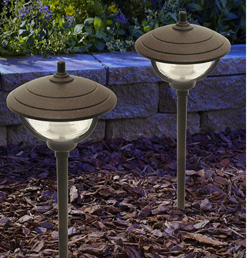

I finally replaced the 15+yr old 12v "pagoda style" path lights in the front yard with new fixtures. I ordered 20w equivalent 3w LED bulbs for them (
https://www.amazon.com/Bogao-Crystal-Equivalent-Incandescent-Replacement/dp/B01I0VDX1I/ref=sr_1_15_sspa?s=hi&ie=UTF8&qid=1546122075&sr=1-15-spons&keywords=G4+LED&refinements=p_n_feature_nineteen_browse-bin%3A9692447011%2Cp_n_feature_seventeen_browse-bin%3A9692442011&psc=1#customerReviews https://www.amazon.com/Bogao-Crystal-Equivalent-Incandescent-Replacement/dp/B01I0VDX1I/ref=sr_1_15_sspa?s=hi&ie=UTF8&qid=1546122075&sr=1-15-spons&keywords=G4+LED&refinements=p_n_feature_nineteen_browse-bin%3A9692447011%2Cp_n_feature_seventeen_browse-bin%3A9692442011&psc=1#customerReviews
) and also rewired the other two front yard spotlights and moved the transformer so now I only have one transformer for front and back yard.
The front yard transformer timer was still working, but the back yard separate one had stopped working (timer/clock function) so I needed to move the front transformer to the location of the rear to keep the rear run the same length. The rear run is several hundred feet and i didn't want to have to rewire it in 12ga since that would be a pain in the ass and expensive. So, moved the 120watt front yard transformer to the location of the now-removed rear transformer, added new wiring for the replacement front fixtures (the old line was brittle and falling apart) and extended the front line about 40 feet to the transformer.
All lights are working well and the new front path lights are nice and bright. Plus, since I am using only LED bulbs, I only have plenty of watts left in case I want to add a few more lights.
I ended up going with these pathway lights mainly because they were low cost AND the lens is real glass. The plastic lenses break down so fast in the AZ heat/sun and just crumble.
https://www.amazon.com/dp/B002RAWRSY/?coliid=I34AP0FHW8Y2J3&colid=HG48P2XABLVZ&psc=0&ref_=lv_ov_lig_dp_it https://www.amazon.com/dp/B002RAWRSY/?coliid=I34AP0FHW8Y2J3&colid=HG48P2XABLVZ&psc=0&ref_=lv_ov_lig_dp_it
(not my pic)
