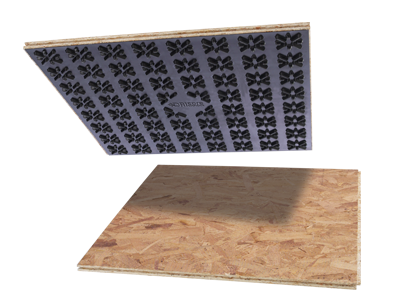

If you are putting laminate down over concrete, it will likely be cold. Wood is not an insulator. For best results, I suggest you put down a subfloor first. You have many options.
In one of my basement bathrooms, I used the dricore panels:
For the rest of that basement, I used a double subfloor system. First i put down this Delta subfloor product. Creates a water proof membrane and adds an air cushion:

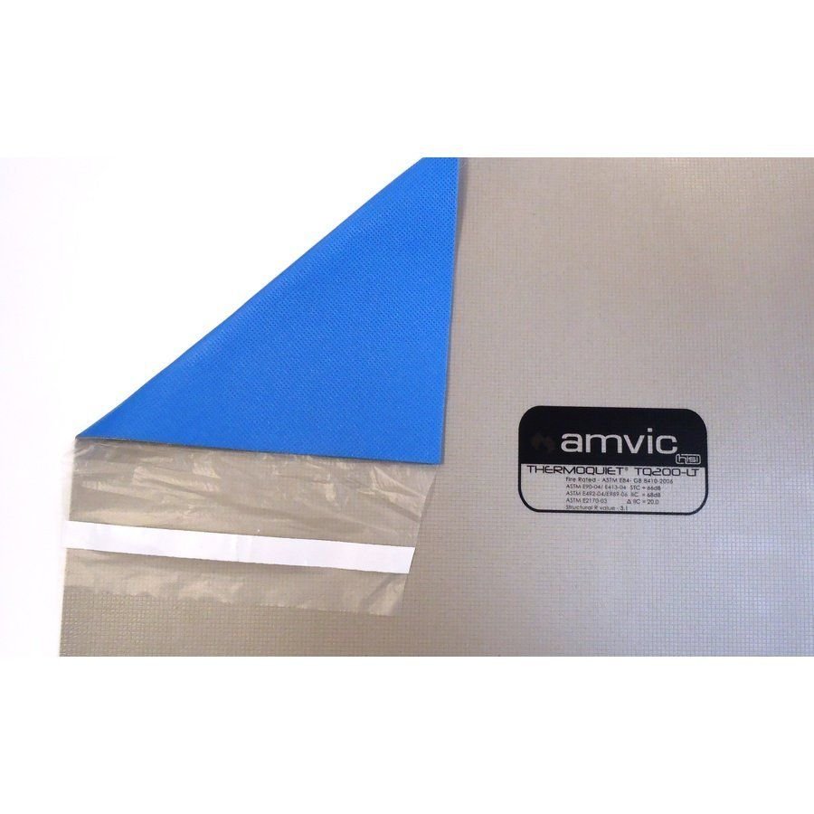

On top of that, I added the underlay you need under laminate (I purposely purchased a laminate without it attached to the backside, as I opted for this stuff with a insulating R value of 3.1:
