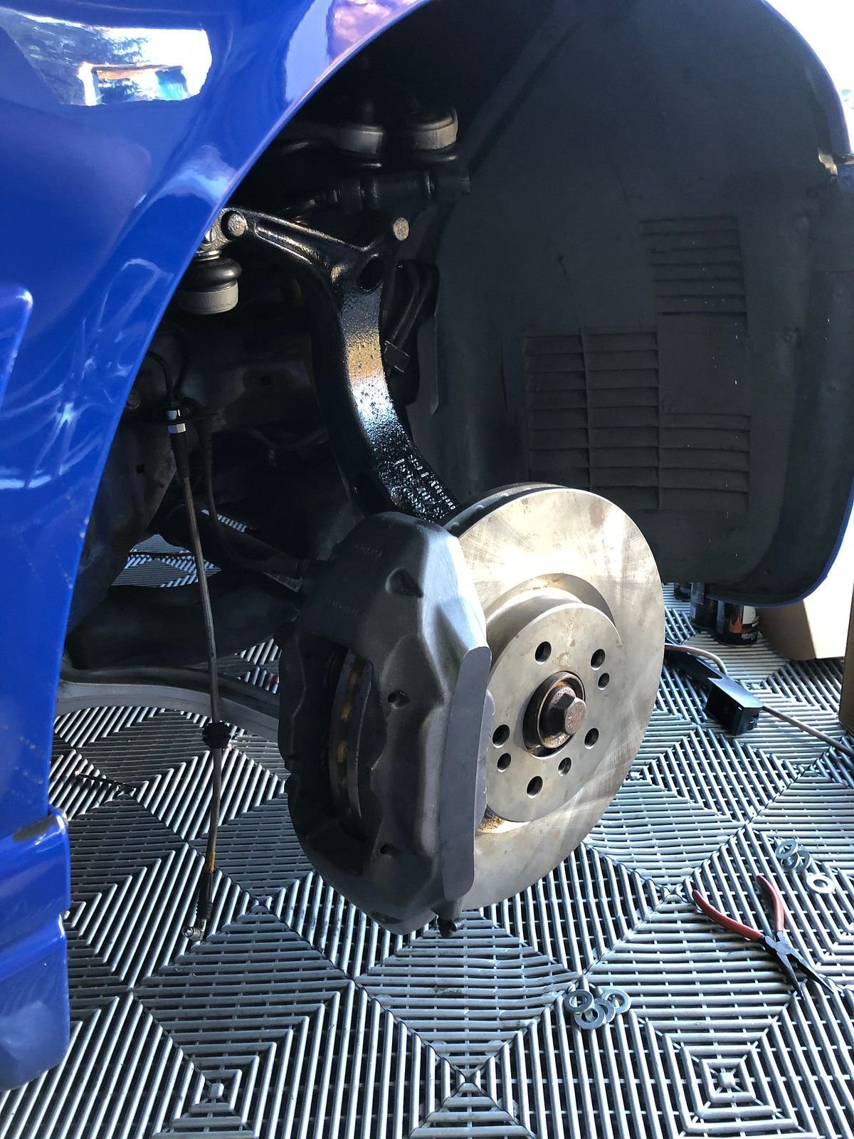

Sorry for the long winded post, TLDR: Car is working.
Annnnnd, car is driving again .
This project took forever - currently on paternity leave but between juggling house duties and a newborn, it proved to be quite challenging to find the time. Additionally, I had some unexpected obstacles issues along the way which extended the project by a week or two.
New brake specs:
330mm/32mm rotors from ProjectB5 (5x112, 57.1 hub centric), drilled & slotted (9mm more diameter, 2mm wider).
V8 Toureg BM5 4 Piston calipers
Stainless StopTech lines up front
EBC reds all the way around
New rear rotors & calipers

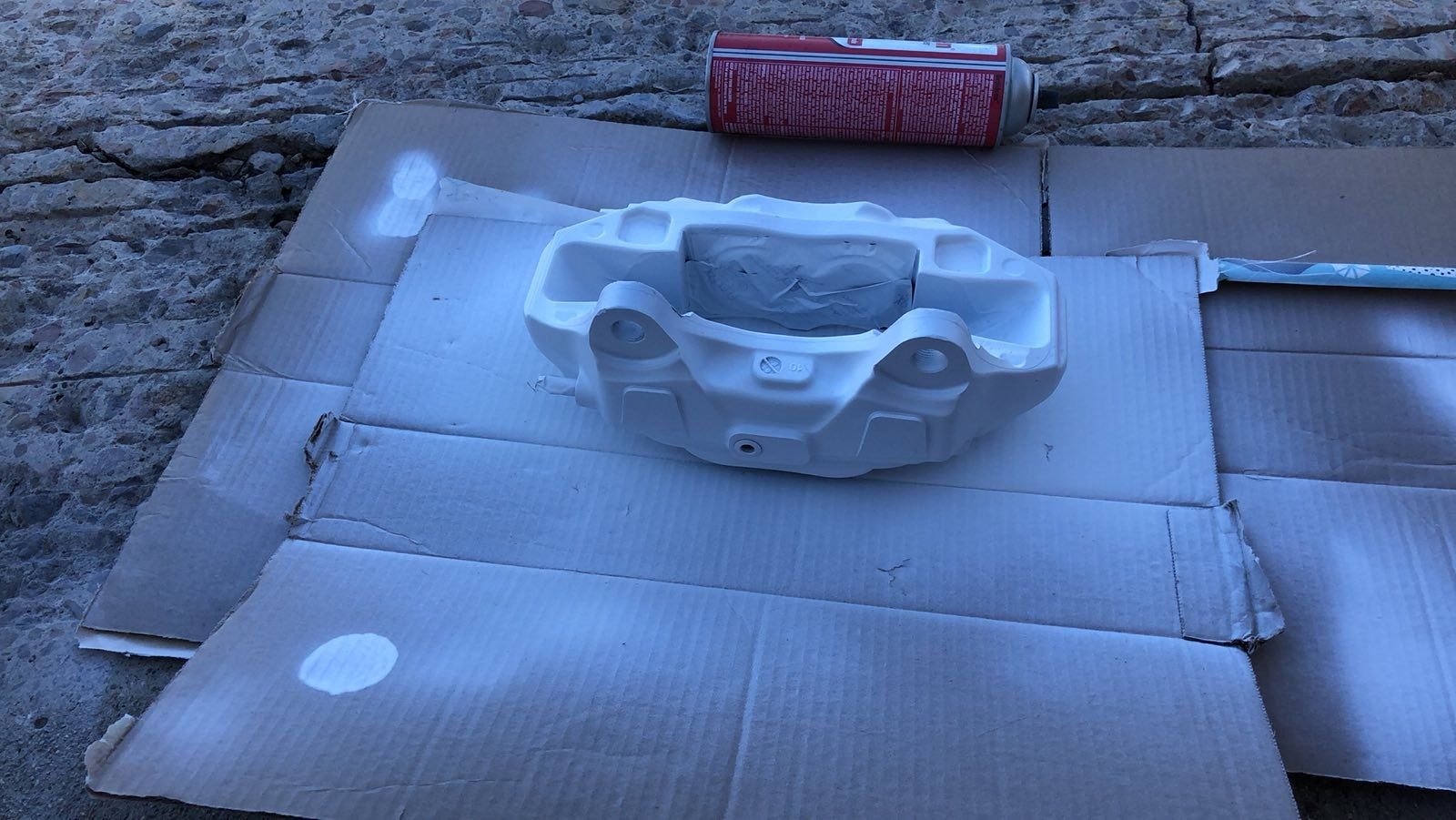

Prep work:
Simple green'd the F out of them - used a wire brush / rotary wire rush bit from my drill
More Simple green
Brake cleaner
2 coats of primer, 2 coats of paint, 3 coats of clear
Thoughts? Just get them powder coated .. I had a few drops of brake fluid sit on these for about 5 minutes and it already took a piece of paint off despite being chemical / fluid resistant. Also, barely nicked the top of the caliper with the wheel and you guessed it ... took paint off.
Obstacles:
1: Cheap rotors I picked up initially fit, but .. they were not hub centric. The rotor clearance is so tight in the caliper that if they are not dead centered (even with the wheel attached / 5 lugs in), it would rub. Annoying as hell to mount them consistently. I ditched them and with with 57.1 hubcentric rotors .. no more fitment issues.
2: I needed to grind down my steel upright (the unit where all the control arms / shock / wheel bearing is) because these are 2mm thicker than OEM rotors - this was expected, but .. I was a little too happy with the grinder and actually went through the steel on the driverside upright ... big oh shit moment.
I either buy a whole new upright with a new wheel bearing, or I attempted to fix what I had already on the car.
Ultimately, I decided I was going to pickup a cheap 110v MIG welder and attempt to fix it.
After practicing for a whole 30-45 minutes by laying down a few beads and adjusting my wire speed, I managed to fix my mistake by filling it & added JB weld on the outside to make it a bit more rigid. Surprisingly, there's more material on the driverside than the passenger side ... I think I did pretty damn good for a first timer. Grinded down / painted ... looks identical to the passenger side.
So happy I picked up a welder .. can't wait for the next fuck up
3: I needed to grind down my caliper ears in order for the rotor to sit dead center in the caliper. Without modification, the outside of the rotor had 1-2mm of clearance, the inside of the rotor was actually making contact with the caliper tunnel.
My father in law gave me a drill press 3 years ago and it was finally time to put it to good use. After some trial and error, calipers fit perfect and most importantly, the grinded area is perfectly flat.
Current issues:
1: The brake pad wear indicator harness that I purchased separately is a female end connector, as is my B5's harness side. Doh. I will need to splice it in order to make it work .. or I could simply code it out via VCDS.
Not 100% decided on what I'm going to do .. but, one thing is for sure - I like a warning free dash.
2: Each front caliper has 2 bleeders each - 1 of the 4 are leaking slowly ... I'm thinking teflon tape and send it.
3: My passenger side Brembo sticker is backwards - I'm leaving it as is ... I've gone through so much with this project I honestly don't even want to re-paint / re-prep the caliper.
4: Very small dead zone on the top of the pedal .. possibly due to the leaking bleeder, or perhaps I need to do an ABS system cycle / re-bleed.
Brake pedal feels better every time I drive.
Driving impressions:
Holy shit .. the car can finally stop properly. After doing a simple 3 x 60-0mph bed in process, the car trips ABS so easily .. it also makes my front suspension feel totally factory since there's so more inertia / weight transfer now .
Anyways, here are a few pictures of the prep work / completed product:
Thanks for reading!

Thanks man! I think I’m getting better .. usually projects tend to be way over budget and/or something substantial breaks and I’m kicking myself.
It’s a learning experience and I enjoy a good / very fruitful car project.

There are brackets / a kit available to fit a bbk in the rear but I’ll most likely do that at a later time.
Got to sort my front brakes soon
I did add Teflon tape to the front threads .. we’ll see if
it holds!

After applying some teflon tape, I have no leaks from my passenger side bleeder screw - better yet, brake pedal has improved quite a bit .. few cycles of my ABS pump via VCDS and I'm good to go.
I've driven the car about 100 miles since my initial update and man, it feels GOOD to drive it again. It may spend 1-2 months a year on jackstands for upgrades / repairs, but there's nothing more rewarding to pull out of my garage and drive around.

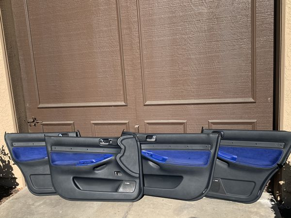

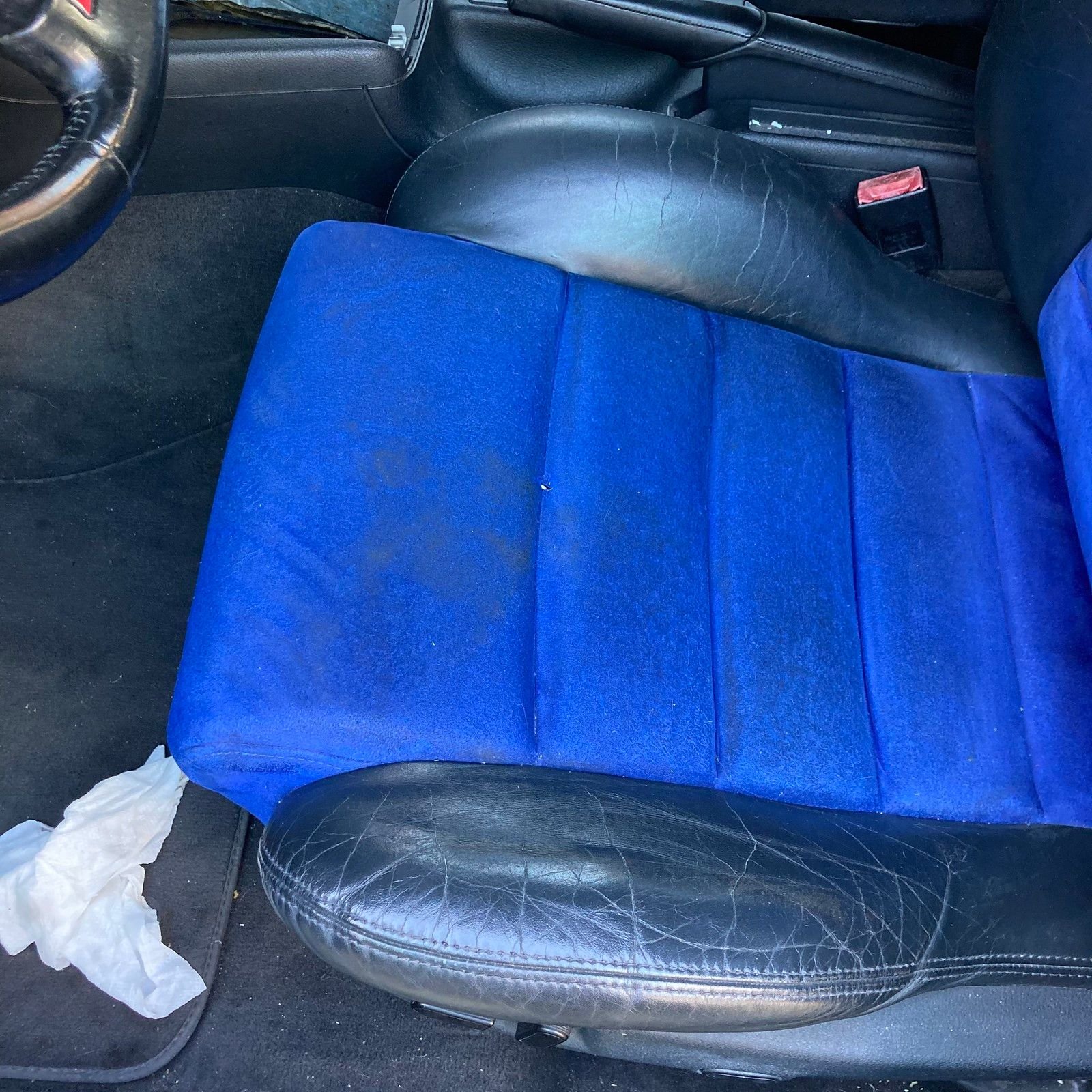

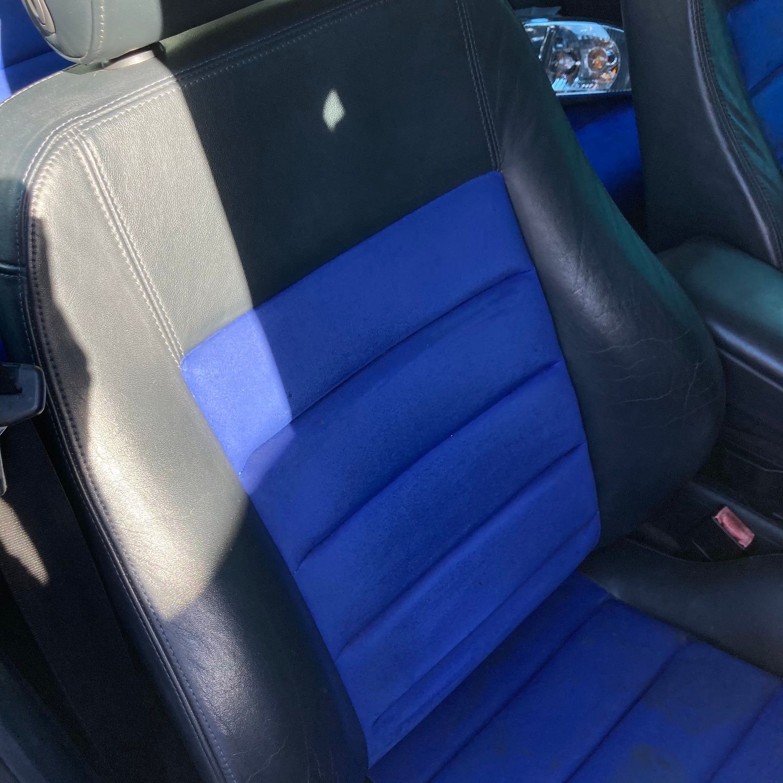

After years of searching, finally found a dude local parting with some pretty rare interior at a good price.
Best part is, his son wants to buy my black leather seats for $250 ... it'll make for a very worthwhile trip.
Recycle bin Sport Interior!
Only drawbacks is, there is a rip on the driverside bolster and there is some fading. If the fix is not repaired to my liking, I will simply have that piece replaced / reupholstered.
The front seats are dirty but, I hear warm water / Dish soap / soft brush will make it look new again. Rears are mint.
Also, the door pulls don't include the aluminum trim ... I will either wrap my existing wood trim carbon fiber or gloss black.
Haven't totally decided yet.
I'll post more updates when it's in the car & cleaned up!
Thanks for reading.
