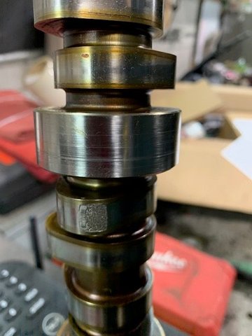

Well since the TL sold and I have a large amount of cash at hand something had to break, right!? The truck decided to throw a P0305 (Cylinder 5 Misfire). Thought nothing of it, changed the plugs (8 AcDelco), Wires (Acdelco) and swapped the coil pack to cylinder 3 to see if the misfire would follow. Would be easy and simple if the issue was resolved, NOT. Truck still threw the P0305 and knew it was something worse. Hopped on the web and did some research. 07+ chevys have this thing called Automatic Fuel Management / Displacement on Demand (AFM/DOD). Dumbest shit I ever heard of! The computer shuts 4 cylinders off when cruising thru town or down I-94. Suppose to help with emissions but in the end it costs owners thousands of dollars. The motor has 4 sets (8) lifters that are suppose to mechanically collapse when engaged into 4cyl mode. Well sometimes those cylinders don't get pumped back up and cause all sorts of issues. Off to the Dealer I go for more diagnostics. I hate going to the dealer for anything and reasons like below are why.
I took my truck to a dealership to have their "professionals" do some tests to pinpoint the issue. No testing (compression test or leak down test) was performed and they end up charging me $135 only tell me there is something internally wrong and want $140/hr to tear it down to inspect. Well no shit there is something internally wrong, that is why I brought it to them. That's a boat load to inspect before knowing what is wrong so I got a second opinion. I did ask what a cam job was at the dealer and they told me its a 20 hour job. Did the math on labor alone and told them they were fucking nuts. The truck would be at the bottom of the lake before I paid that!
Took the truck to my buddies performance shop where they performed a leak down test this morning and said it passed with flying colors. Knowing that the bottom end was healthy I pulled the trigger on a Stage 2 AFM/DOD & VVT Delete from Brian Tooley Racing (BTR) to rebuild the top end. Truck will get a Stage 2 - 3 Bolt Cam, 16 - LS7 Lifters, GM Lifter Tray Guides, LS6 Beehive Valve Springs, LS Hat Valve Seals, 3 Bolt Cam Gear, Timing Chain Dampener, Timing Cover (VVT Delete), all new seals/gaskets, Heads Milled to ensure flatness and a Valve Job. Followed by a Motor and Trans tune by their Master Tuner.
A little annoyed that I have to do this 9 months after buying the truck. The dealer I purchased it from told me I am SOL since I opted out to buy their warranty. Didn't even offer to help at all with knocking some labor off. Another reason I hate Dealerships...
I should pick up a few ponies with the stage 2 grind. Dyno sheet will be posted when I get it. Wish I was adding a supercharger for the cost this repair will run me but hopefully I won't have any issues for at least 2 years.

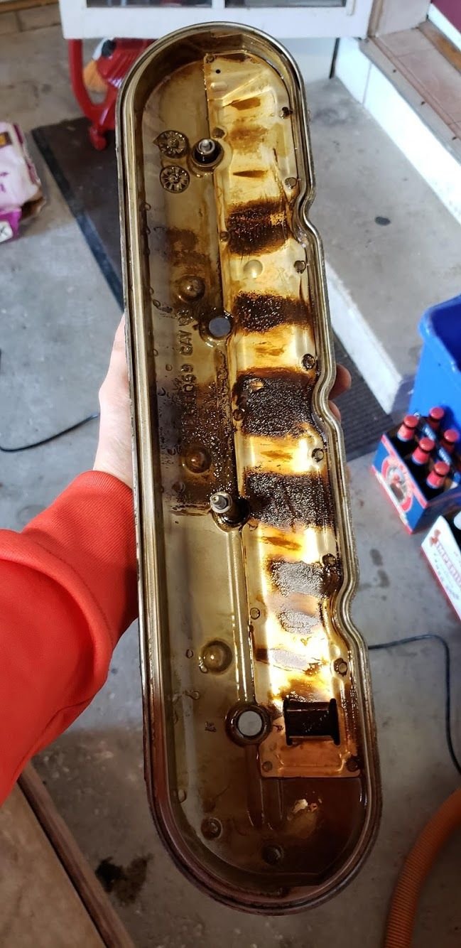

Cylinder 5 Plug looked original so all new plugs won't hurt any.
Rockers were all tight, so no sign of a collapsed lifter. Springs weren't broken, so no luck there.
Valve cover looked good to the shop. Normal spray on the bottom side of it.

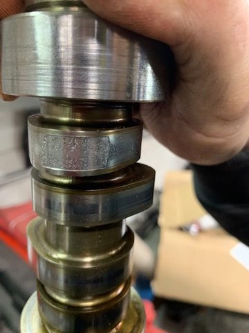

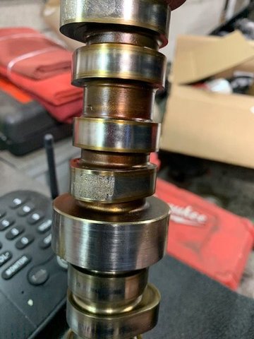

Shop called with good news, but per usual followed up with bad news....
Good news, they found the culprit! Bad news, motor needs new cam bearings... So they will have the shop that is doing the heads come and press the old ones out and press new ones in. Due to the material ground off the cam they need to drop the pan to clean it out, clean the pick up tube and replace the oil pump. Will also have the trunnion bearings replaced.

Motor is being pulled today. Shop can only reach front 3 of 5 cam bearings with motor in truck. They gave me the option to only do those 3 or pull the motor to replace all. I chose to pull motor and do it up 100%. Not spending all this money to only do 60% of the job.
Lets hope that will be the last thing to do before rebuilding it and tuning it.

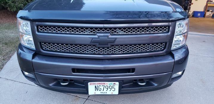

Breezy's Silverado Build Thread
For those of you who know Old Red had to be retired back in Feb. of 2019 and was quickly replaced with a newer 2010 Silverado LT Crew Cab. Thought I would have the reliability of this truck but fuck was I wrong! Enjoy the ride and feel free to send me donations to ease the pain...
Great truck before it fucked me sideways...
Blacked out the front and rear bow ties.
Toyed with the smoked headlights. Eventually went back to the OEM ones because these cut down the light output tremendously. It did look good but I want clear lenses so I will replace these one day with blacked out housings and clear lenses.
After 9 months of ownership things started going sideways.
