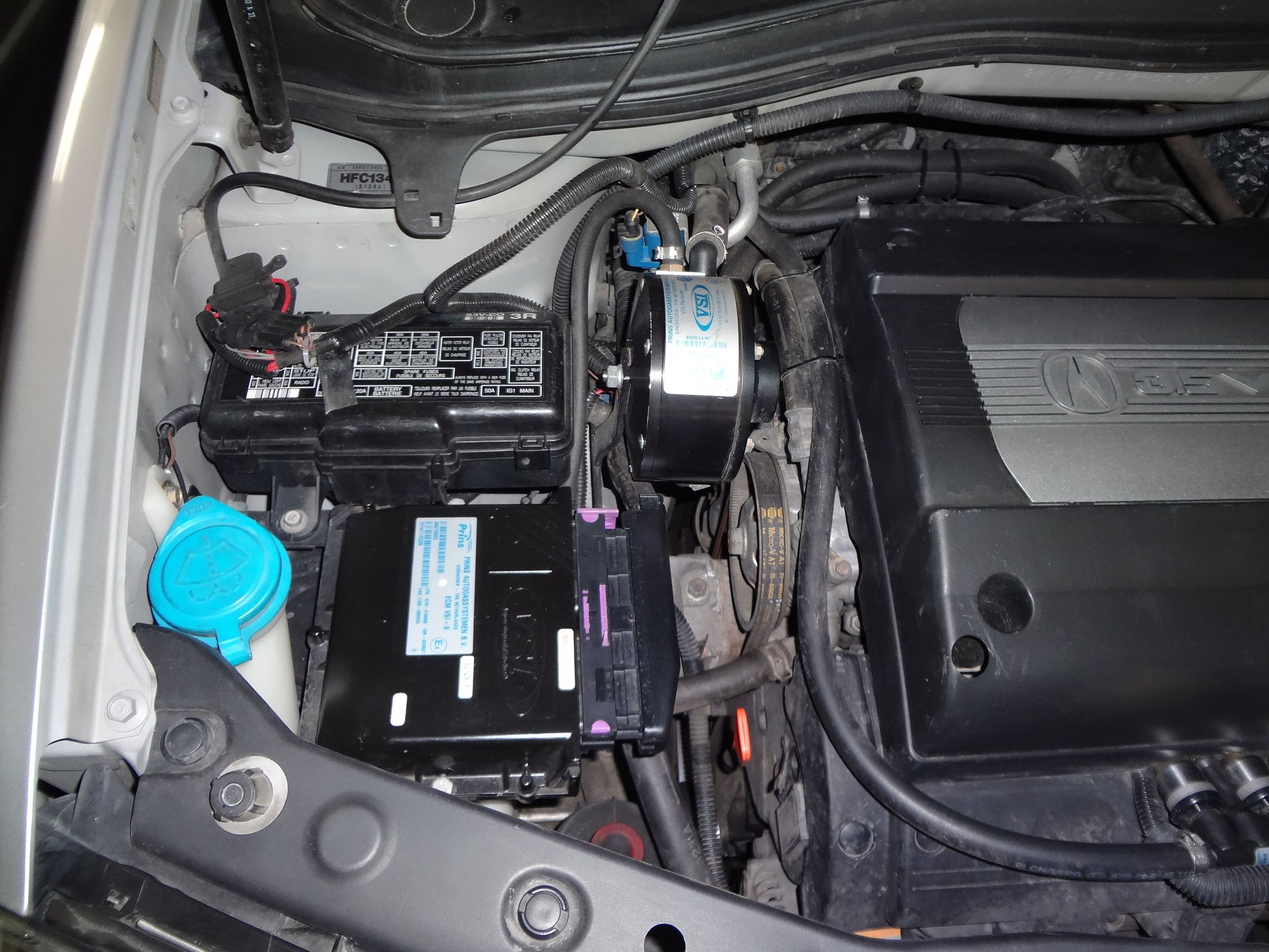

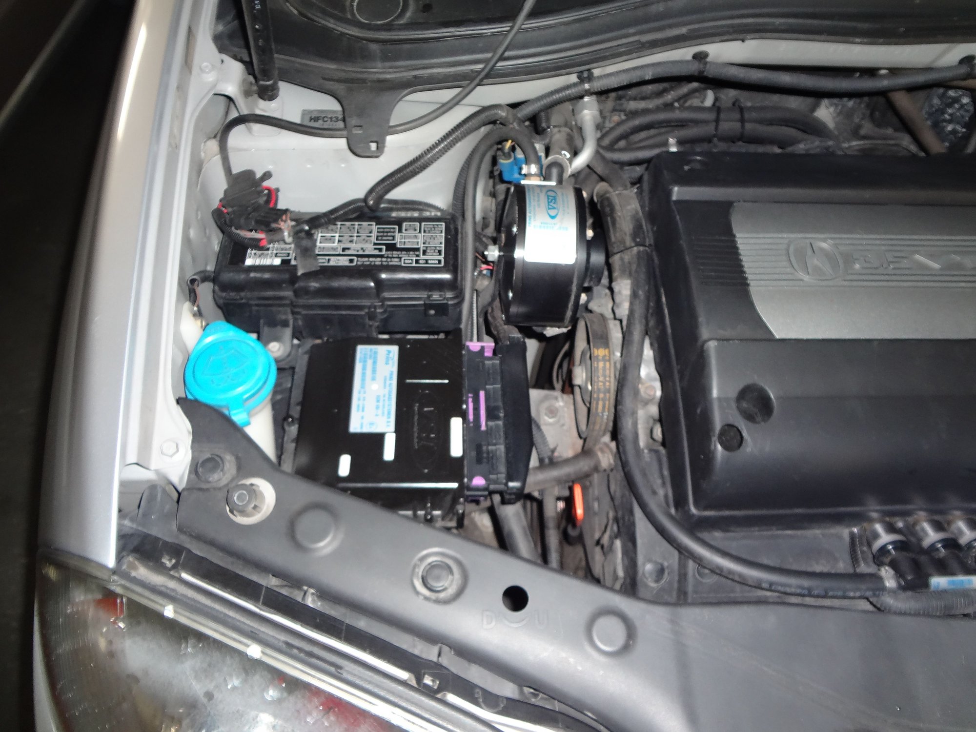

Converted in June 2011. Works perfectly and cheap to fill up. Dual conversion. Starts on gasoline until engine reaches 140 degrees then the computer switches it to Propane. I can manually switch between gasoline and Propane otherwise the computer makes the change. If I run out of Propane the computer switches to gasoline. I get 8000 kms between oil changes with synthetic oil and the oil is still the color of honey when drained. Octane level in Propane is approx 105.

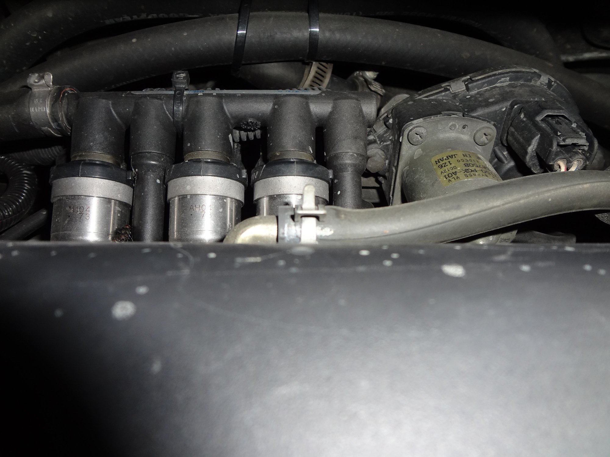

that's great for people who put the miles on! Are those injectors in the one pic above the coil packs? are they tapped into the intake manifold or something?

The injectors are tapped into the intake manifold at each intake runner. When the system is removed the holes are plugged with a threaded plug.
