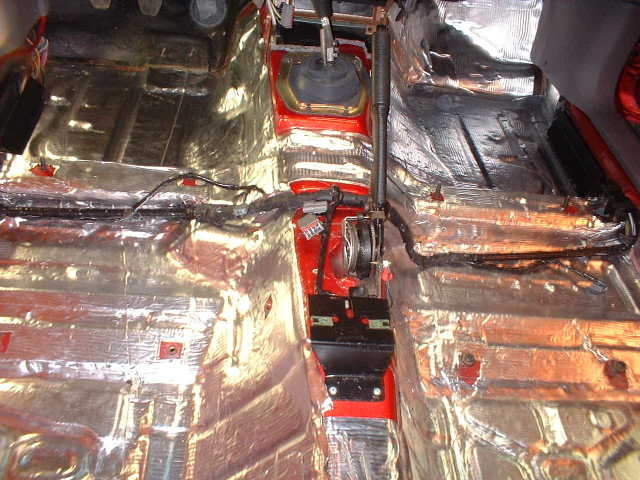

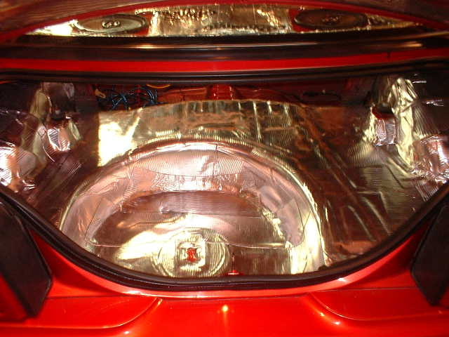

This was done in my Mustang. It took a long time, and smelled for about a week, but in the end killed a ton of tire & exhaust drone which was very nice. I paid $100 for 100sq feet of FatMat off Ebay. It went on pretty easy as longas you have a good razor knife, a blow dryer, and some sort of small roller to push down the mat when heating it up.
