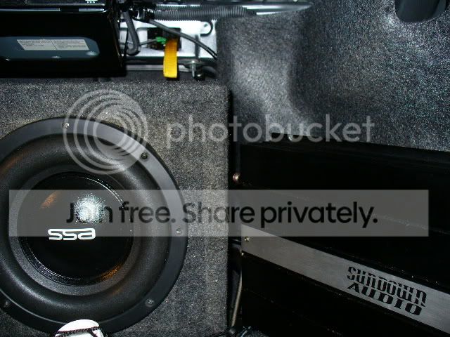

Here's mine
Bout 5 hours of DIY work, and like 10 hours of planning. Not your average 3000$ custom system install, but I'm happy with it, only ~50$ of materials and a lot of time and headache.
I can still get to the spare tire, just gotta remove the (350z) cargo net
