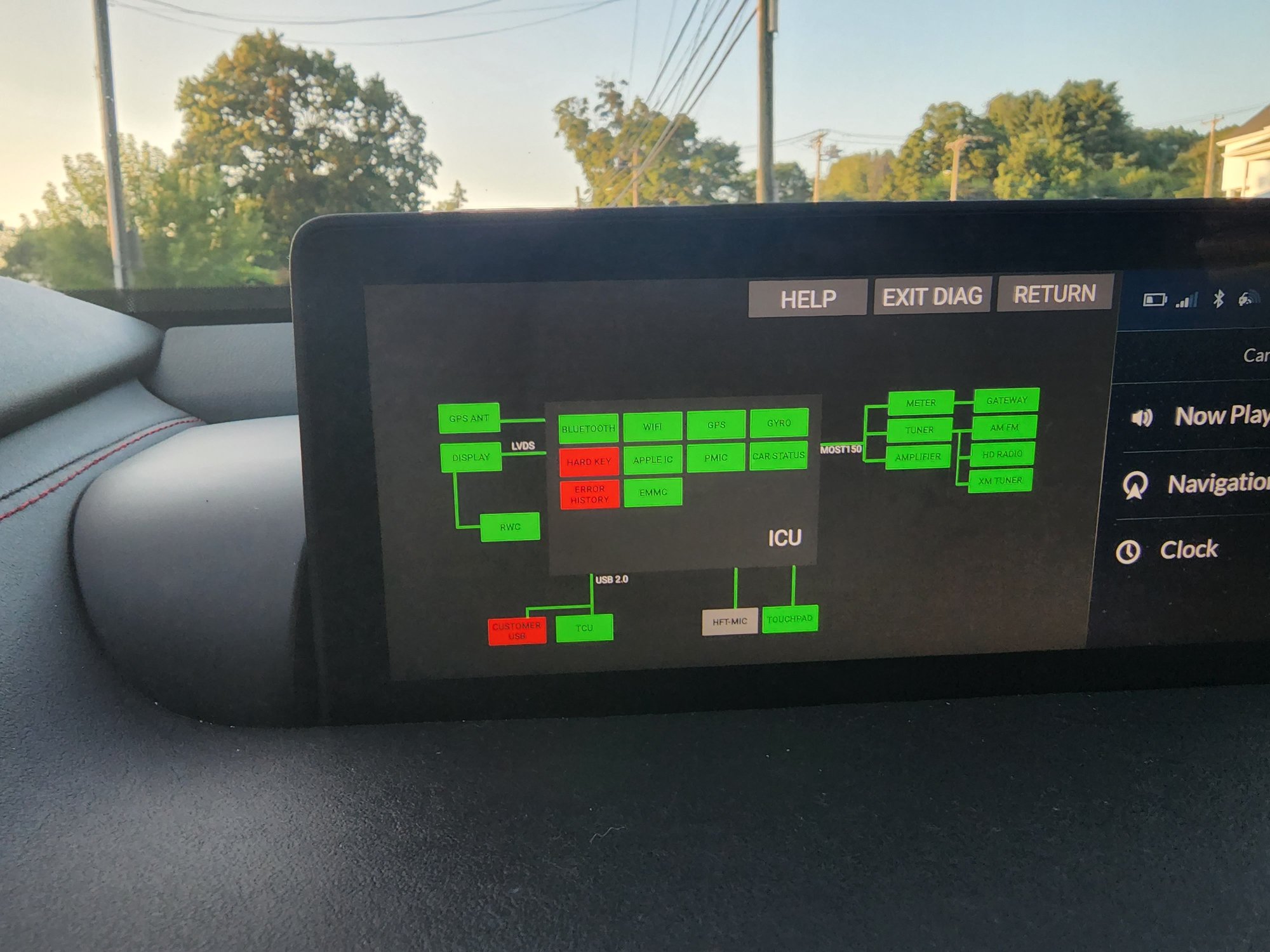

Thanks ELIN for the response. What is weird, I will use the wire and won’t connect until the car has been driving for 10 minutes and same issue of phone not charging or android auto not loading. I tried an iPhone cable and iPhone as well, same issue. No charging or connection to vehicle until I park, turn off car, open door to turn radio off and start the car. I was able to run the diagnostic screen and the Customer USB every time I have this issue, will show a red hard key tab as well as a red error history. After restart everything is green. I went ahead and checked the steering column and there is liquid/ grease on some harnesses and underneath the steering wheel running down to my brake pedal. Little upset I have been complaining about the clicking of wheel and speakers crackling when accelerating and the dealership claims to have checked and could not replicate. All they had to do was look underneath and see the stains on the trim running down to brake pedal. I will attach a screenshot of the diagnostic screen in the event anyone else is having the USB issue.

That is definitely worse than the Acura USB quirkiness I was talking about. At least you have a screenshot of this and should be able to replicate this at the dealer.
