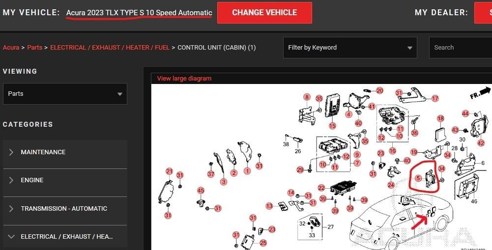

Based on a google search '23 TLX Type S master unit', I found the ebay link below which provided a part number 33170-TGV-A01 for said unit.
865856. Acura TLX Type-S 2021-2023 Master Chassis Control Unit OEM 33170-TGV-A01 | eBay
That part number plugged into dreamshop.honda.com for the 23 TLX Type S pulls up the graphic below indicating #5 as the lighting master unit:
If I had to guess, the lighting master unit lives in the general vicinity where the red arrow is pointing?
Therefore, in regards to 'moisture', perhaps the heater blower unit or evaporator subassembly, in that area, as well could be generating condensation build up / drippage as a result of AC use versus an actual leak from, say the windshield seal?
