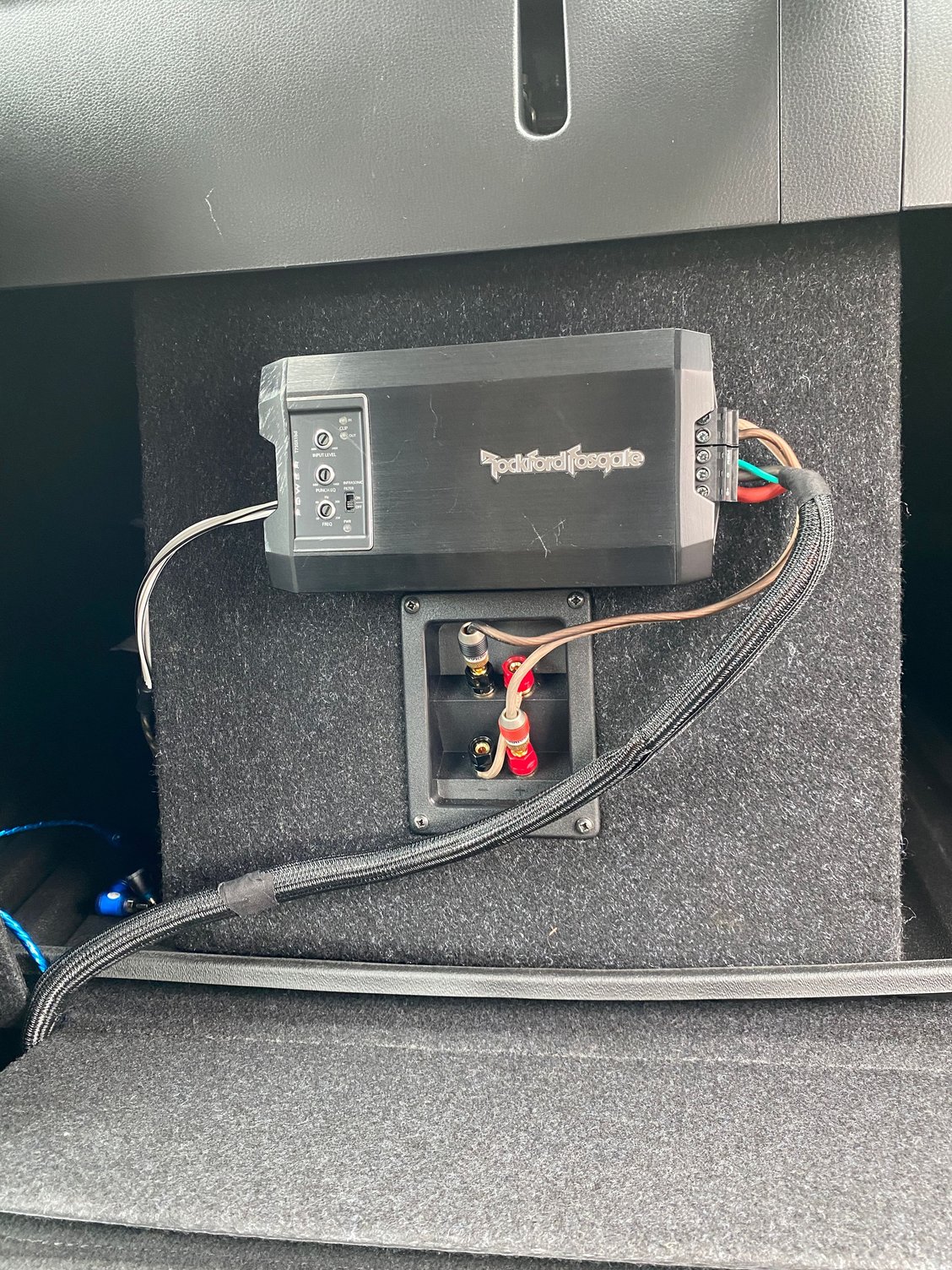

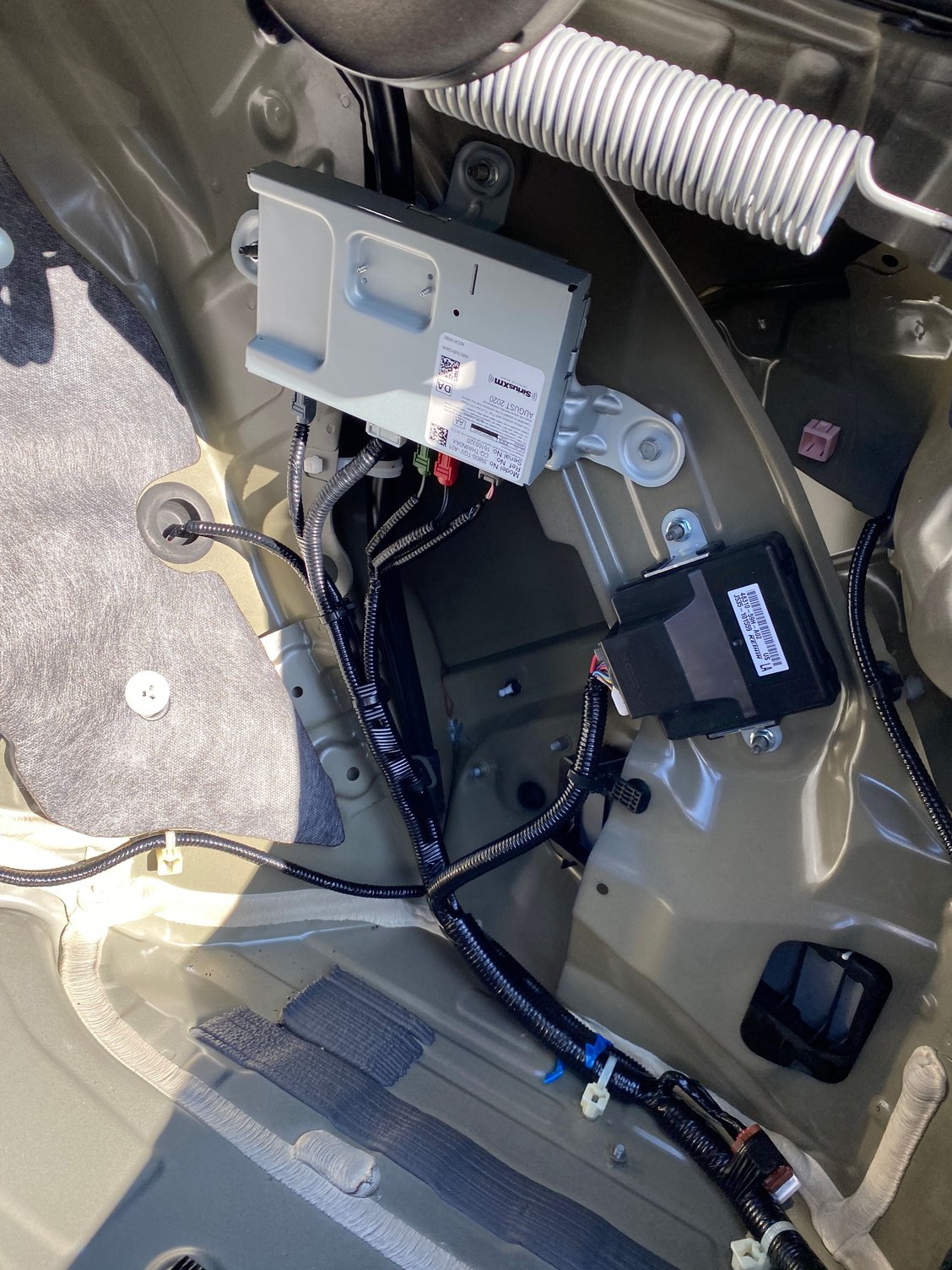

I have a 21 TLX Advance. I need help for the schematic wires clean signal(before the amp) for front speakers and rear. All my subs are coming from a 16 Accord EXL. When I hook them up using the clean signal input, I don’t have to disconnect the ANC and no strange sound from my subs. Your help will be much appreciated. Thanks
Kenwood KSC-SW11(2)....under the front seats
Rockford Fosgate T750X1bd (500W RMS x 1 at 4 ohms)
‘Rockford Foxgate P3D2-12 (wires as 4 ohms)

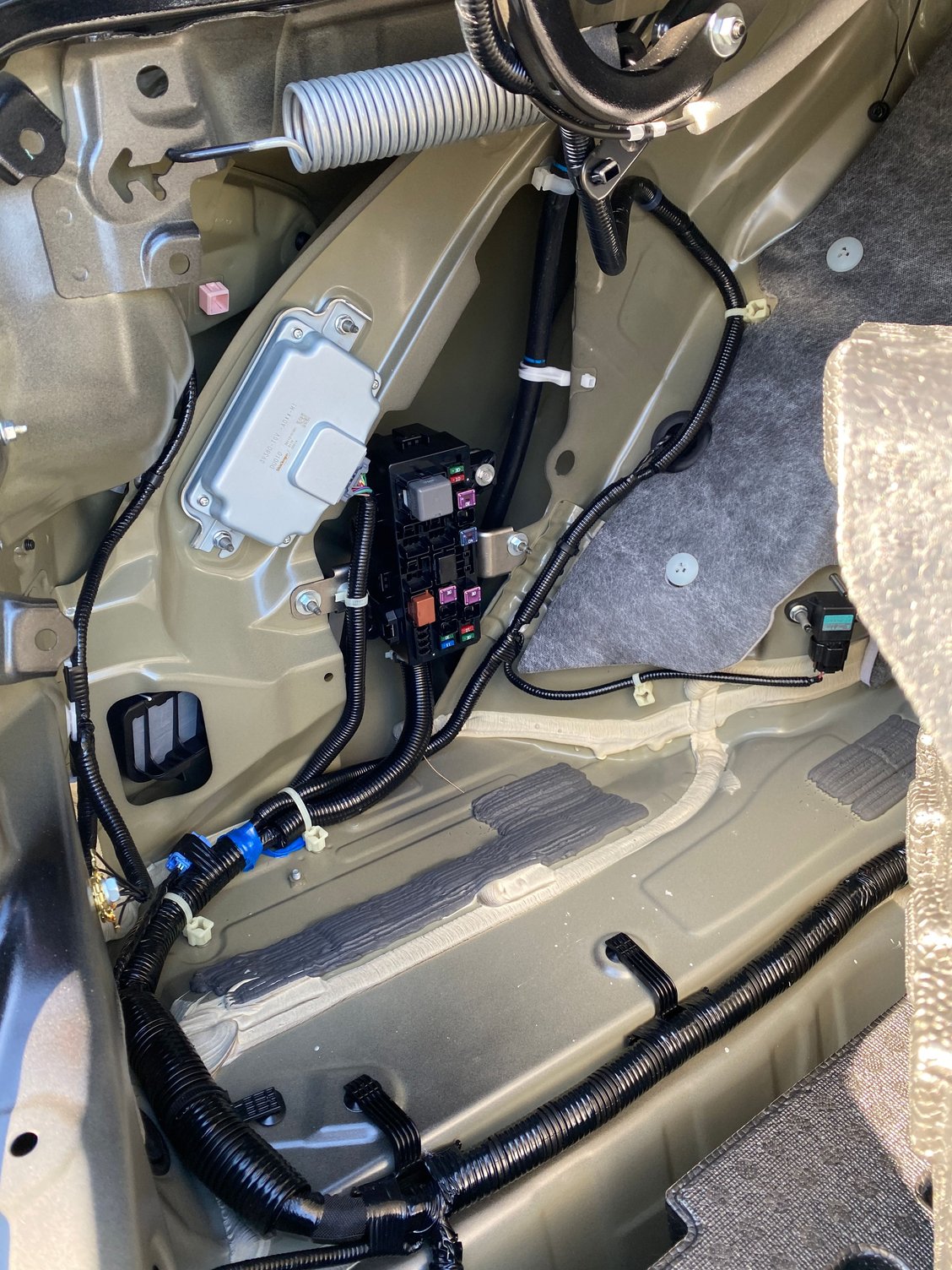

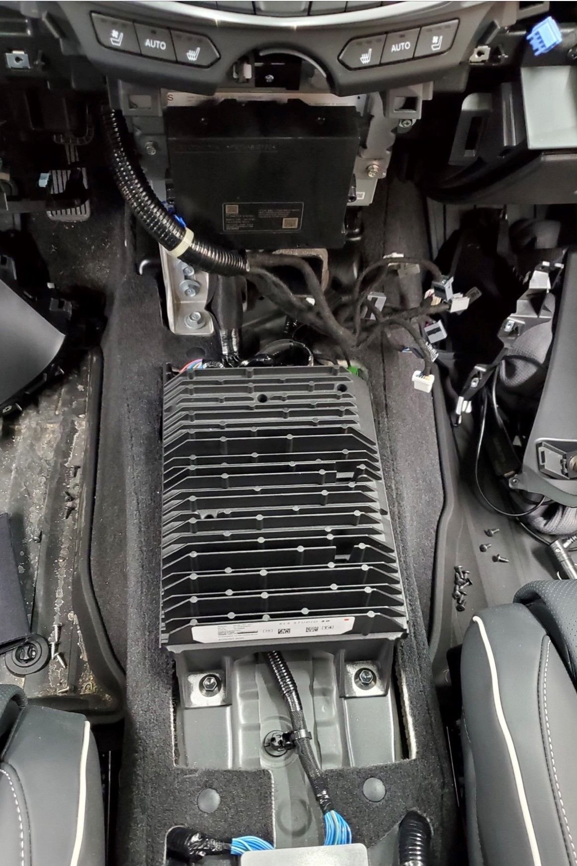

I was going to install my dubs but, the factory amp is not by the front passenger are...2nd pic...do you where to find it?
Front passenger area...cannot find factory amp...

I look in the trunk and still cannot find the factory amp......

well, you tell us when you find it.
since it's such a new car and you're the only one diving in.
or perhaps you can look up a parts diagram to find the factory amp.
www.acuraoemparts.com

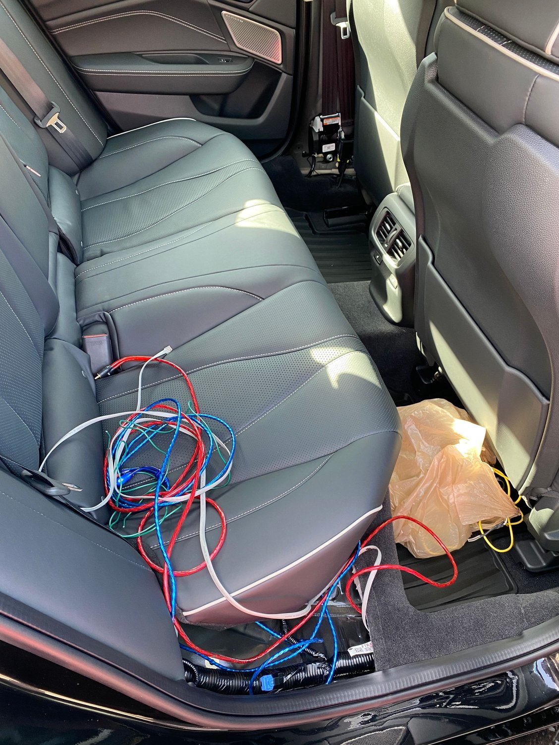

I will be able to get to mine later this year and will apply sound deadening as well. I may not be able to use the pre amp signal since they are digital, base on the info I received from the owner of these pics.
I installed my sub by tapping to the rear factory sub. I could not installed the subs under the front seats because of the ventilated seats.

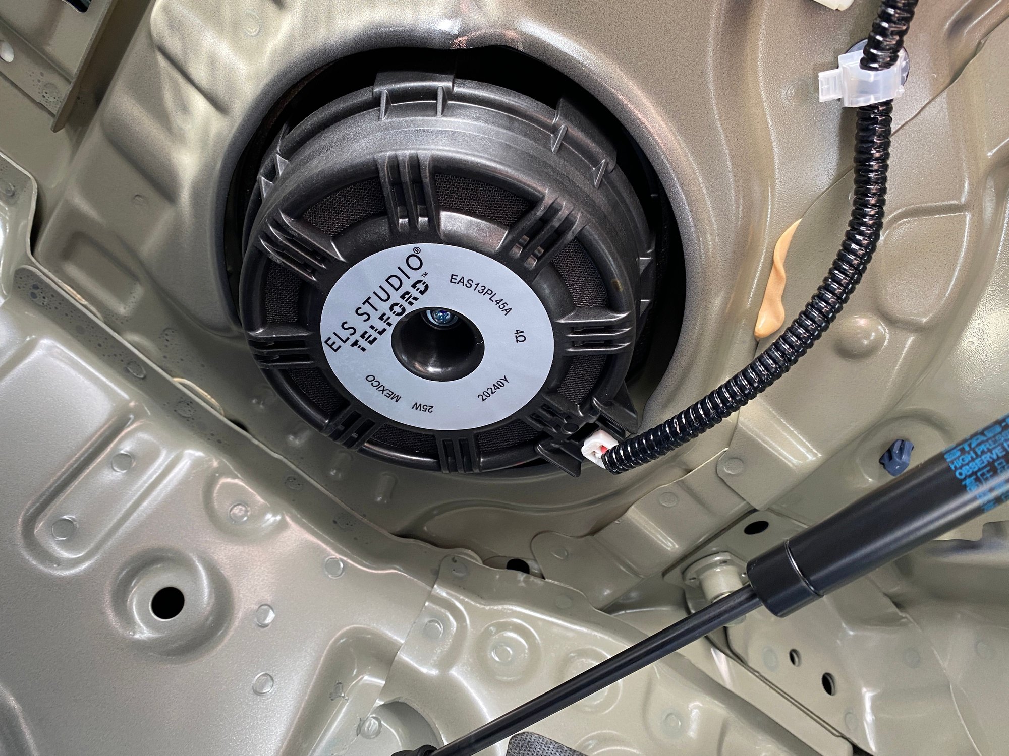

Where is the factory sub located? I've been underwhelmed by the bass response so far!

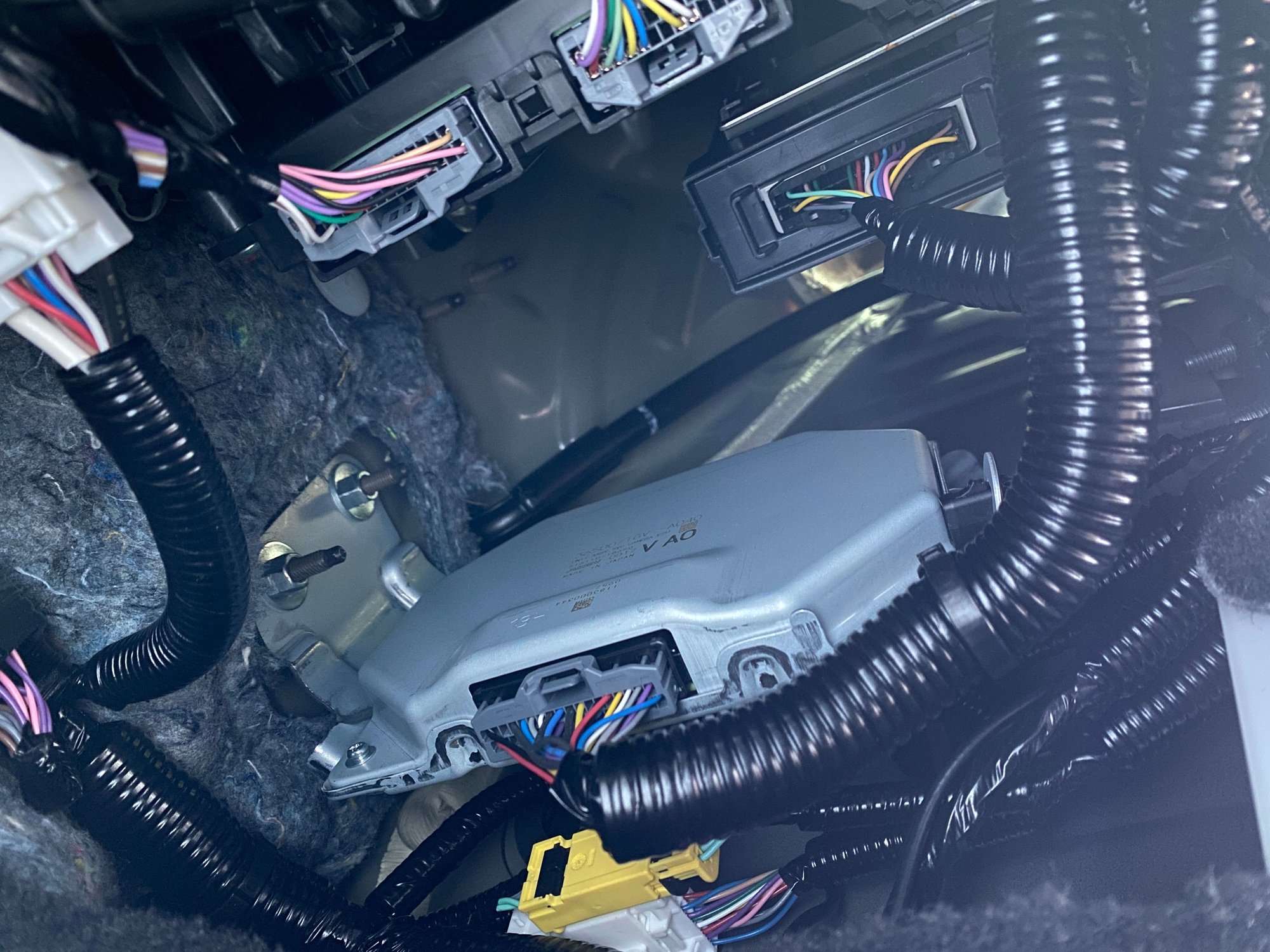

Which one of these multiple modules is the ANC? I'm in desperate need of disabling it in order to correct the strange 1 minute or so engine noise coming across the subwoofer we just installed.
I do not know which one is the ANC module so I unplugged the mics for now.

Hello,
I have a 2021 Type S and ANC is driving me crazy...I do have a confirmed ANC part number: 39200-TGZ-A01. It "should be" located on the drivers side kick or mid-dash. I say "should" as my installers were unable to locate it. I just had them remove the entire drivers side and the ANC module was not where the schematic shows. There is however a Bosch module that has a very similar model number...do not unplug it as it will setoff your zone sensor. It will clear itself as soon as you plug the module back in and restart the car. If anyone finds this sensor PLEASE take the time to report back to the community.
Old Sep 1, 2021 | 03:40 PM
Jim Schillerstrom's Avatar
Joined: Oct 2015
Posts: 15
Likes: 17
From: South Dakota
Finally found the ANC module...it is directly behind the push to start button!
Mystery solved
