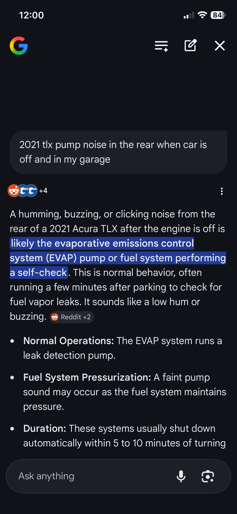

This might be what you hearing
Originally Posted by NTP66
That's actually kinda wild.
I have heard something like what you have described. Here’s what I found out and what may be happening.
